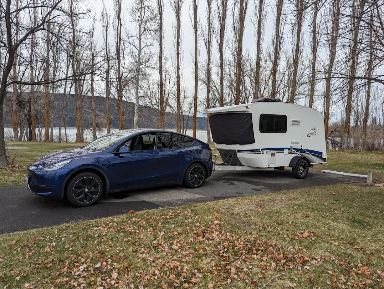

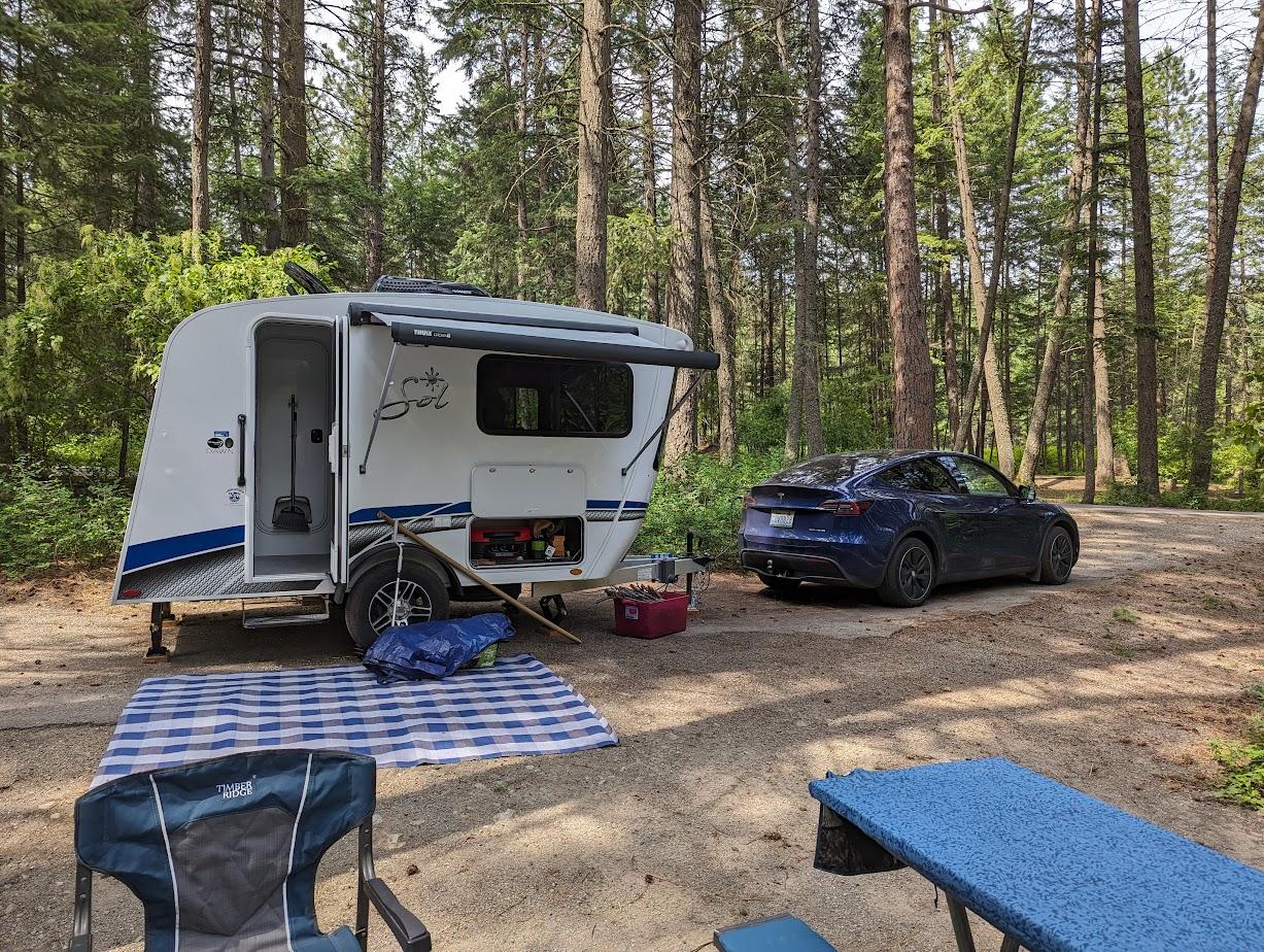

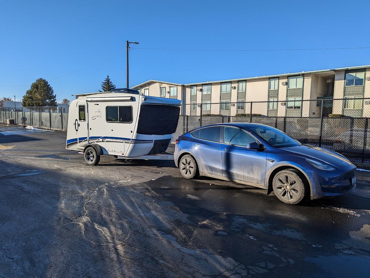

Here's some shots from picking it up last year to the few trips we went on - picked up in January (pic 1), trips in April (pic 2), May and June (pic 3).
