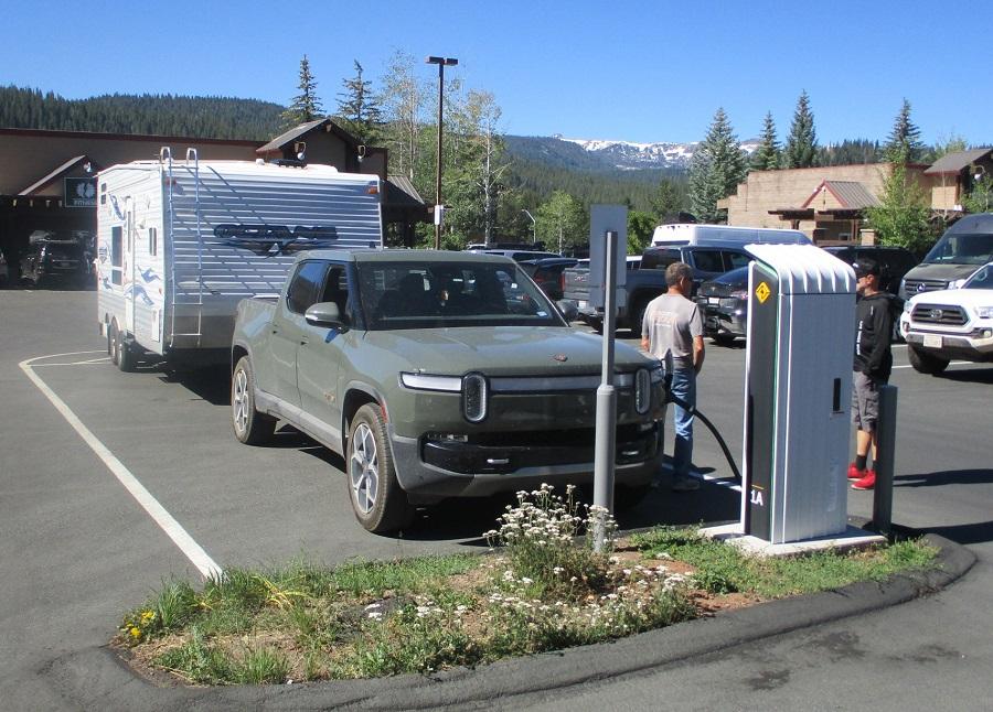

Hello Rivian peeps!
My husband John and I live in a travel trailer, currently wintering in Tucson. We tend to go on the road in the summer, and we're so pleased to have an electric truck to tow our home.
It's not always easy to plan and travel with limited range between chargers, but for us it's worth it.
I compiled the data (and a few photos) I've been collecting when we're on the move:
https://allelectricproject.com/electric-truck-towing-2/
Looking forward to getting back on the road again in June!
-Marcy

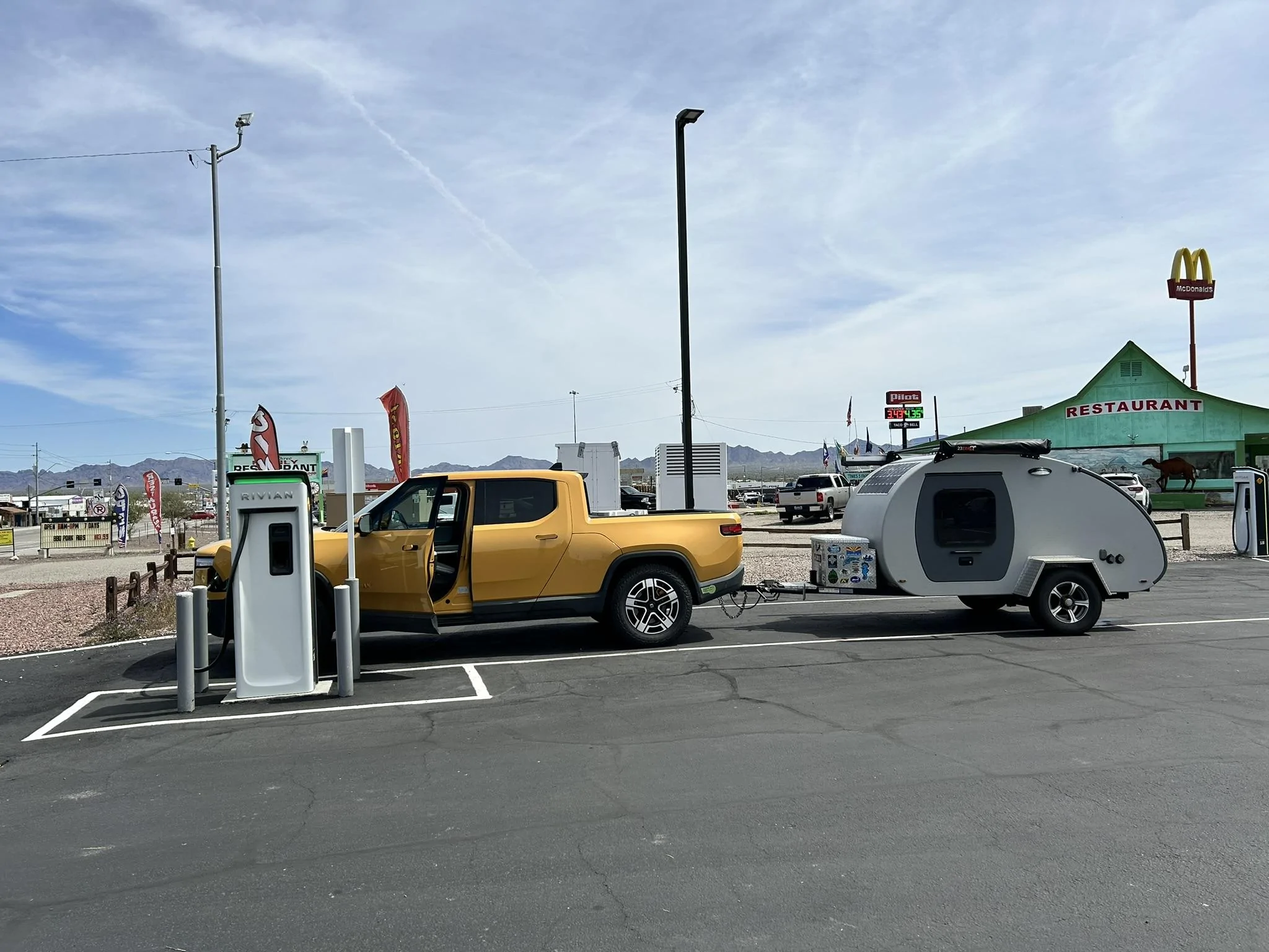

Nice write-up and analysis, thank-you. We regularly tow our teardrop and get about 1.5 m/kWh average. We just returned from 2 week adventure in southern Arizona and was able to use 8 different RAN chargers (and a few others in-between). I concur with your observations on factors effecting range and how you can manage en-route using the Rivian guess-o-meter. It does take into account altitude differences and seems to base prediction on posted speed limits. So far it has been on conservative side and never over-estimated. Good job Rivian engineers. I suppose some AI working the magic? However, we prefer the 1-2 hour drives with ~20 minute charging stops. For us that's driving within 20-70% of battery capacity. If you charge to 20% above the Rivian recommendation the journey is less stressful and you can burn-it and have some fun as you get closer to the next charger. Drive through charging spots are brilliant
