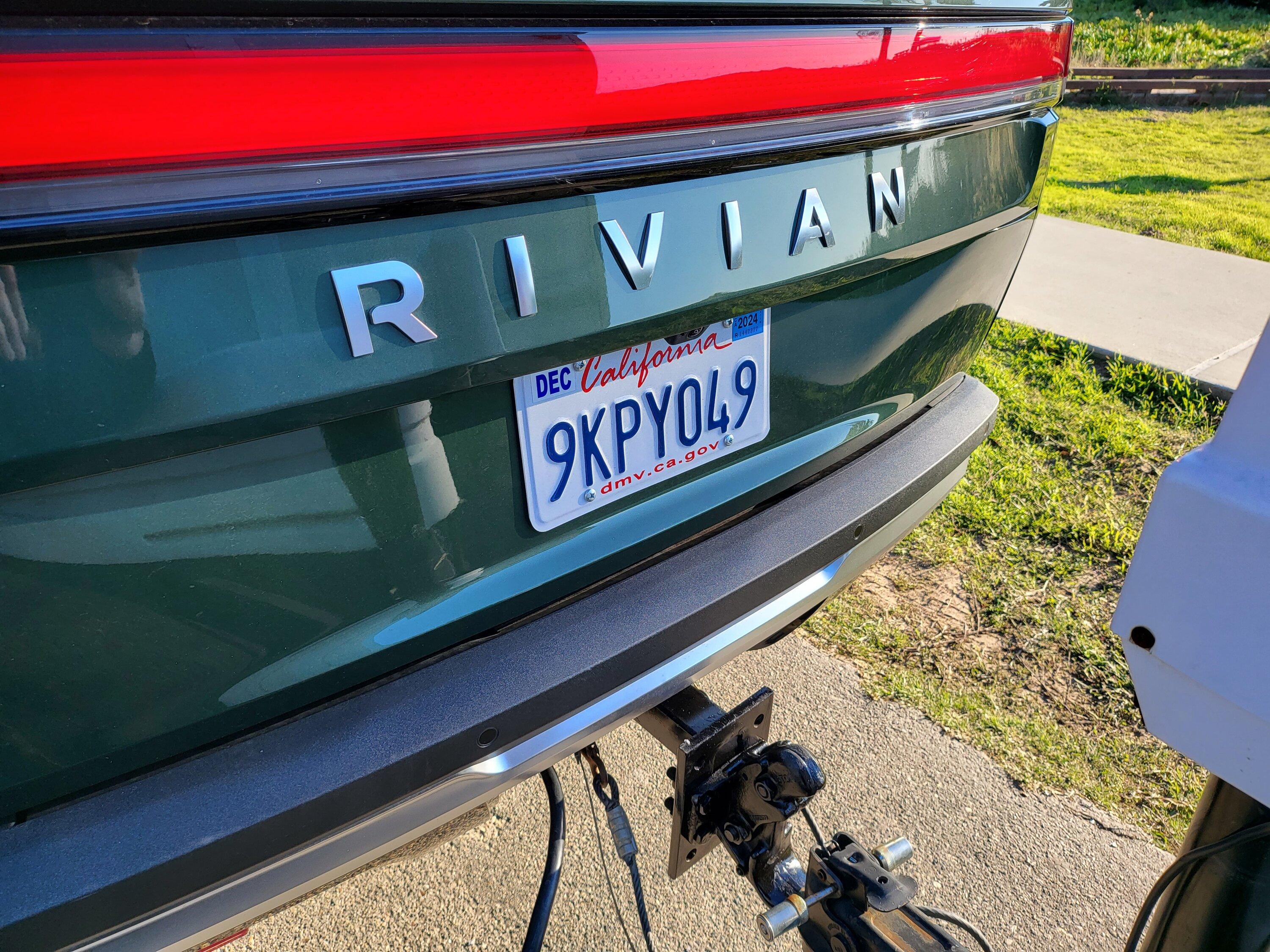

For me the rivian receiver was a bit to low compared to our gx470. You can't raise the rivian, unless you want to go 45mph the whole way. Luckily I had an adjustable pintle laying around to adjust a couple of inches instead of flipping the ball on the light duty stinger I use on the gx. The pintle is seriously heavy solid cast.
