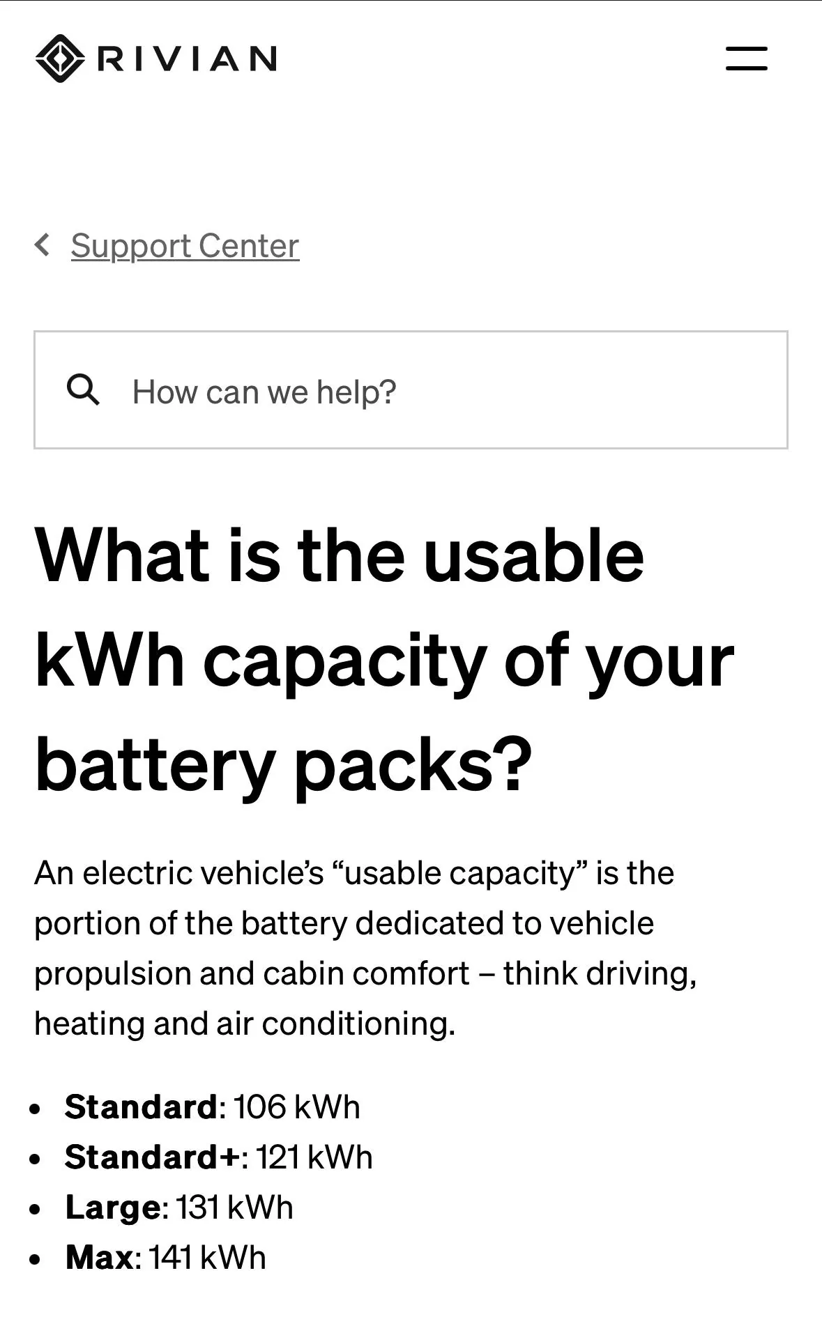

Interesting they're now claiming 131 kWh usable on the large pack. I've been using 128.5 kWh to run rough calculations since I think that's what maybe OoS managed to pull out of one after the update that opened the pack up a bit.
The Rivian API reports that my battery capacity is 127
The "drive" screen reports my battery health as 97%
127/.97 = 130.9
So that math works out pretty good.
However, the question remains if anyone's vehicle has 100% battery health.

We have several thousand miles towing in our R1T and R1S. Quad motor vs Dual motor not that much difference in efficiency. The difference comes from the dual motor being able to disengage the rear motor above 20 mph instead of having to switch into a dedicated conserve mode like you do on the quad motor. So EPA numbers are higher because those tests are done in all purpose mode. Being able to get the increased efficiency without losing the 4WD capability is a big plus for the dual motor.
Towing efficiency on these trucks varies, but a travel trailer is the worst case scenario as its a big box on wheels. 1 to 1.2 mi per kwh is what we have experienced with towing. The max pack has 11 kwh of usable capacity over the large. That's 11-13 miles more towing range than the large pack at those efficiencies.
Large Usable: 131 kwh
Max Usable: 142 kwh
If its worth it or not will be subjective. The guy or gal who needs that extra 11 miles to keep from being stranded will tell you its worth it. Only you can decide.
