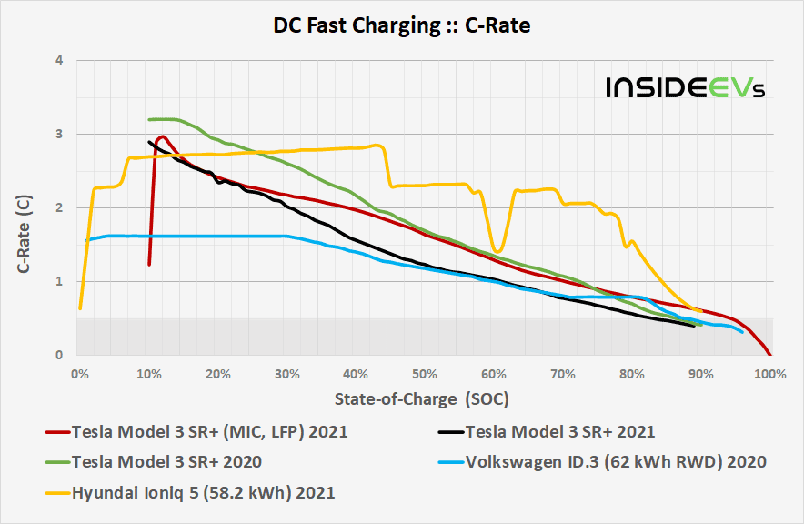

Better way to compare charging capabilities of the vehicle is using c-rate and not kW. Rivian has big battery, 40-60% bigger than most vehicles on the market today. I think most people would agree that Tesla Semi charging at 150kW at 60% wouldn't be impressive at all.
Anything below 1C at 60% is a very weak result. For context here are some c-rates.

I am not sure why people are expecting the Rivian to hold 150kW charging speeds up to 80% when no cars on the market do that currently????
Mine does, and with a 30% smaller battery (eTron) and it's 2-3 years old. Not every time (charger issues), but it's certainly capable of it when the charger is up to it.
