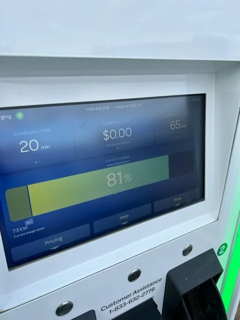

I think Brice nailed it - Electrify America is super inconsistent. Some days you get amazing speeds, some days you don't. As long as a person understands that, road tripping in a Rivian will be a delight. Also, hitting 80% in a certain amount of time will vary depending on the battery pack size. One person's 20% to 80% in 30 minutes will be another persons 20% to 80% in 40 or 45 minutes.
Here is a good example of Electrify America working as designed. Yesterday in Trinidad, Colorado I had a great charging session for my Taycan while on my road trip to PHX. Check out the results:
Rivian R1T R1S Max charging speed IMG_1613
It will certainly not be every day a vehicle will charge 65kWh in 20 minutes, even for a Taycan.
The key to successful road tripping in an EV is patience, and keeping options open!
P.S. Not even the two fastest charging vehicles on the market today - my Porsche Taycan included - will hold charging speeds up to 180kW up to 80%, so that will not happen with a Rivian currently.

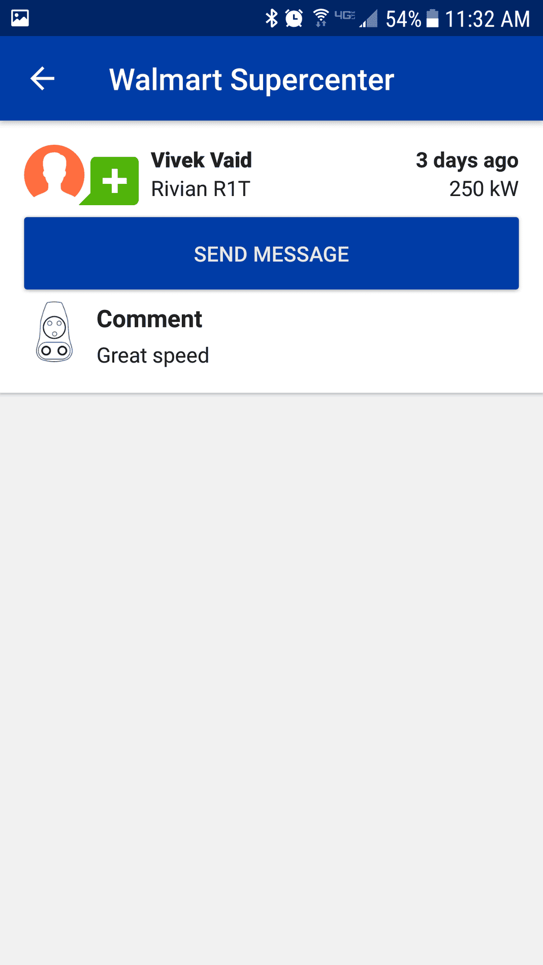

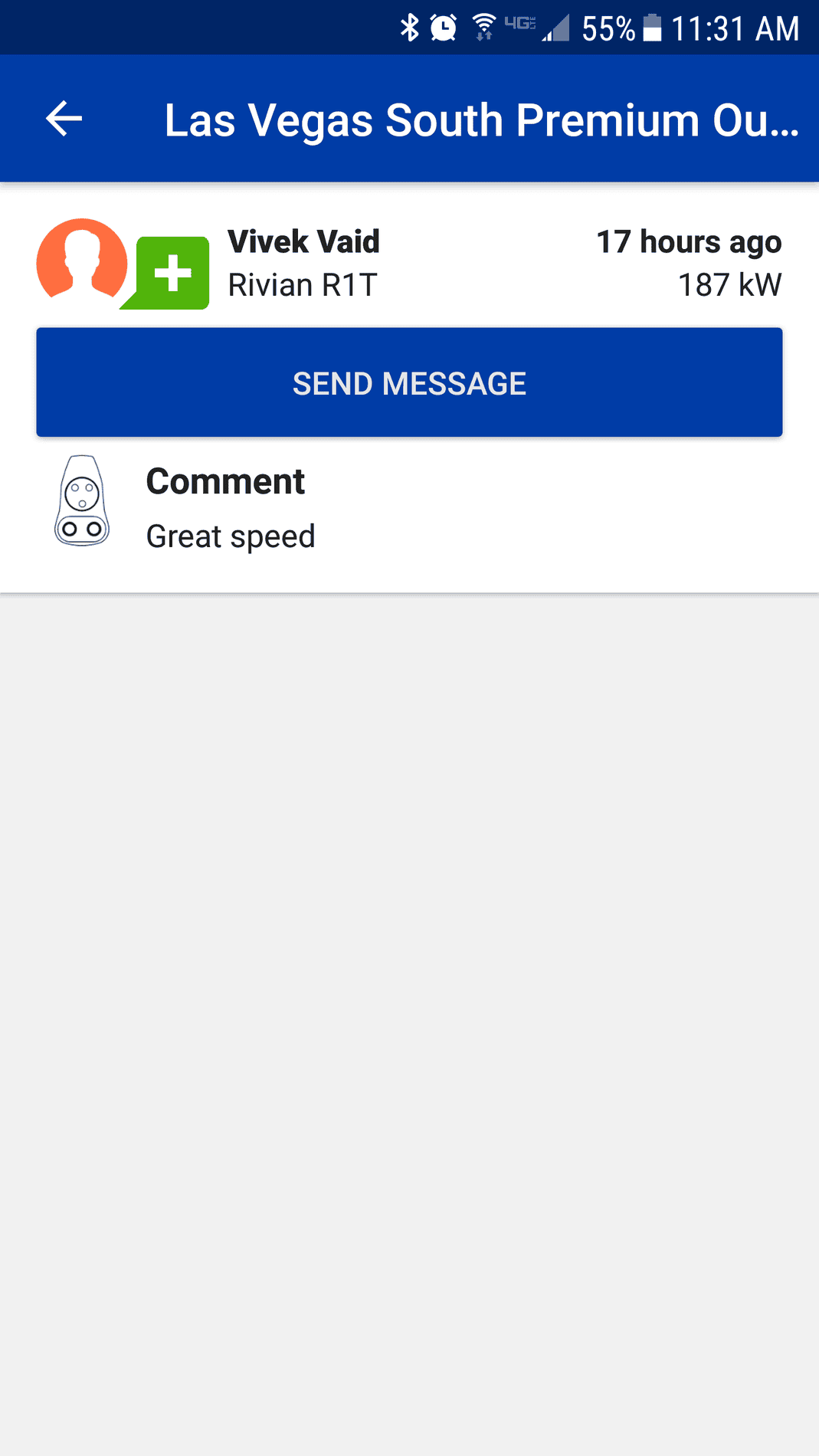

While looking at station options in Utah on plugshare I noticed a rivian check-in in Green River the other day. Apparently an employee is road tripping back to California after picking up his truck. This is his route:
https://www.polarsteps.com/VivekVaid/4419390-rivian-r1t-plant-to-home
I found a few of his other check-ins on plugshare and some of the highest reported speeds were 184, 187, and 250kw in Lexington, NE!
I wish I had the opportunity to see the truck as he passed through Grand Junction!

How did you find his check-ins? Or, can you share screen-shots?
Maybe it's because I'm logged into plugshare. Of course that doesn't say anything about how long it stayed at those levels.

Pulling 250kw? Damn..
250kW is essentially impossible with a 400V charging system on CCS. Unless Rivian actually has implemented the 400/800V hardware, I'd be pretty suspect of any number much over 180kW.
They have a patent for parallel reconfigurable pack charging. I just dont know if its just that or actually implemented. 250kw might be evidence or could be for just 10 sec of charging just dont know.
Is that 250kW something the user has to type into PlugShare? Wondering if this was a typo and it should have been 150kW.
