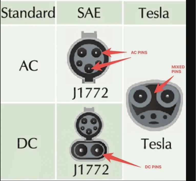

It’s elementary. And you can pretty much ignore/dismiss CHAdeMo.
Your NACS charging port can handle both AC (aka level 2) and DC (level 3) with the same shape plug/receptacle and pin out.
The CCS1 combo port, MY24 and prior, has two parts. The circular part is J1772 (AC, level 2). This combined with the two pinned oblong is for DC fast charging (level 3).
To adapt a J1772 home/hotel charger, you need a J1772 (female) to NACS AC (male) adapter.
To adapt a CCS1 fast charger, you need a CCS1 (female) to NACS DC (male) adapter.
AC = alternating current
DC = direct current
Charger plug (male) --> Female end of adapter - Male end of adapter --> Your car's charge port (female)
