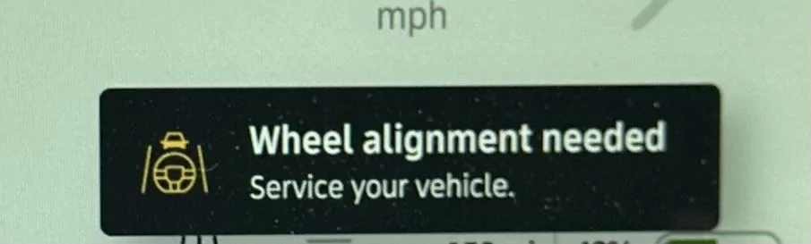

As for alignment, I had the same issue. My car eventually threw its hands up and agreed with me.
Rivian R1T R1S Alignment woes D0736AC2-6C95-4E99-B6BC-DE7A3EAB3480
I had no idea the truck had the ability to detect this.

Or for customer retention when there aren’t many service centers. These aren’t mobile service items. So how many days off are you willing to take, and hours of round trips before you’ve had enough?
I had this warning everytime I tried driver+ since delivery. The .47 update seemed to fix it and driver+ works now. Alignment still pulls right mainly under 40 mph and in all purpose. Steering wheel still about 4 degrees left. Hoping to get fixed at SC in couple of weeks. Been waiting on that appointment for almost 3 mos
