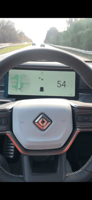

I took delivery about a month ago and noticed the veering to the right and steering wheel off slightly as well. Didn't drive it much over the Holiday's and opened up a service ticket. I'm being told I'd have to bring it in (close to 3 hour drive). They gave me some potential certified collision shops near me that may work on it but the first one I called said they can't work on it.
***Update: second shop said they should be able to do the alignment so they're seeing when they can get me in.
This is pretty frustrating to read , especially people who have had to take it back several times. That just isn't going to be an option for me.
Does anyone have any pictures of how bad theirs is off?
I'm going to try to get a better picture today as it's generally a bit worse than this:
