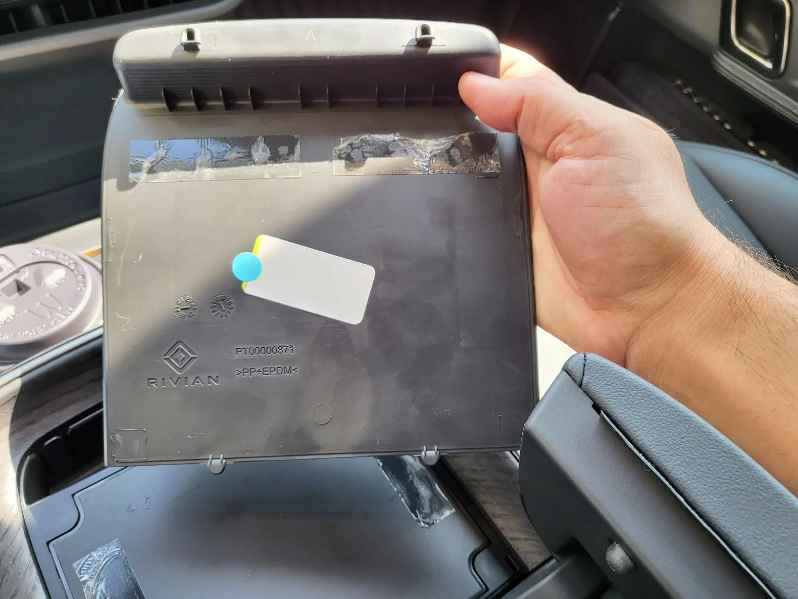

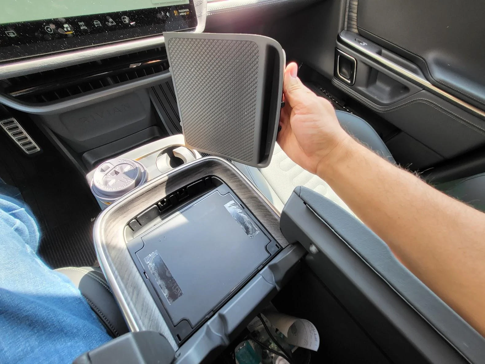

Took the wireless charging mat off today. Very easy to remove, just lift up from the crevice with your fingers. Easy to remove and clean but it is held on with 4 pieces of double sided tape. The wireless charging module is underneath.
Two discoveries / observations
  1. My phone sticks better to the charging area without the rubber mat on top.
  2. Charging seemed to connect faster without the pad.

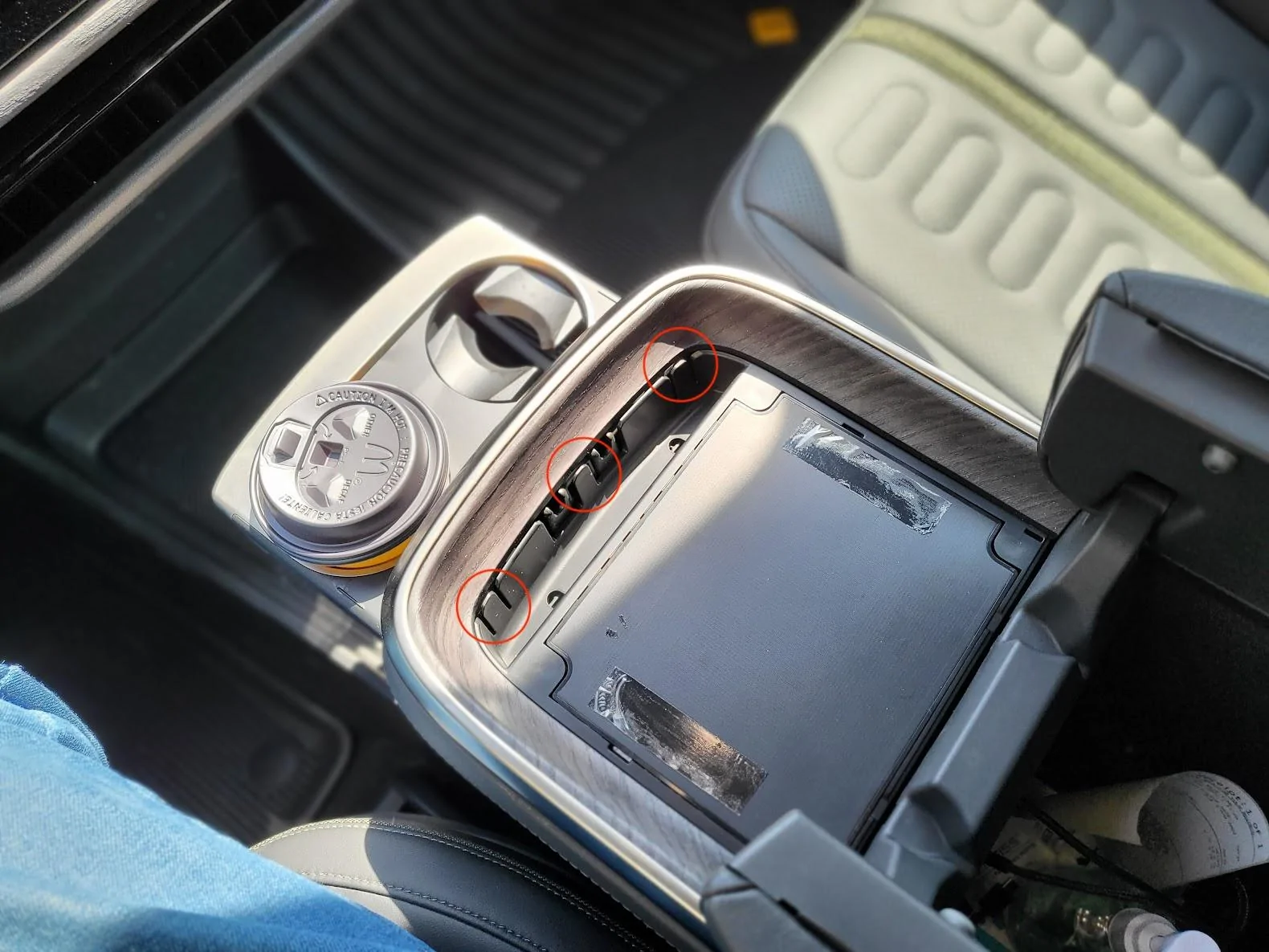

The module is held in by three plastic clips in the front. Lift the clips and pull up from the crevice same as the pad.

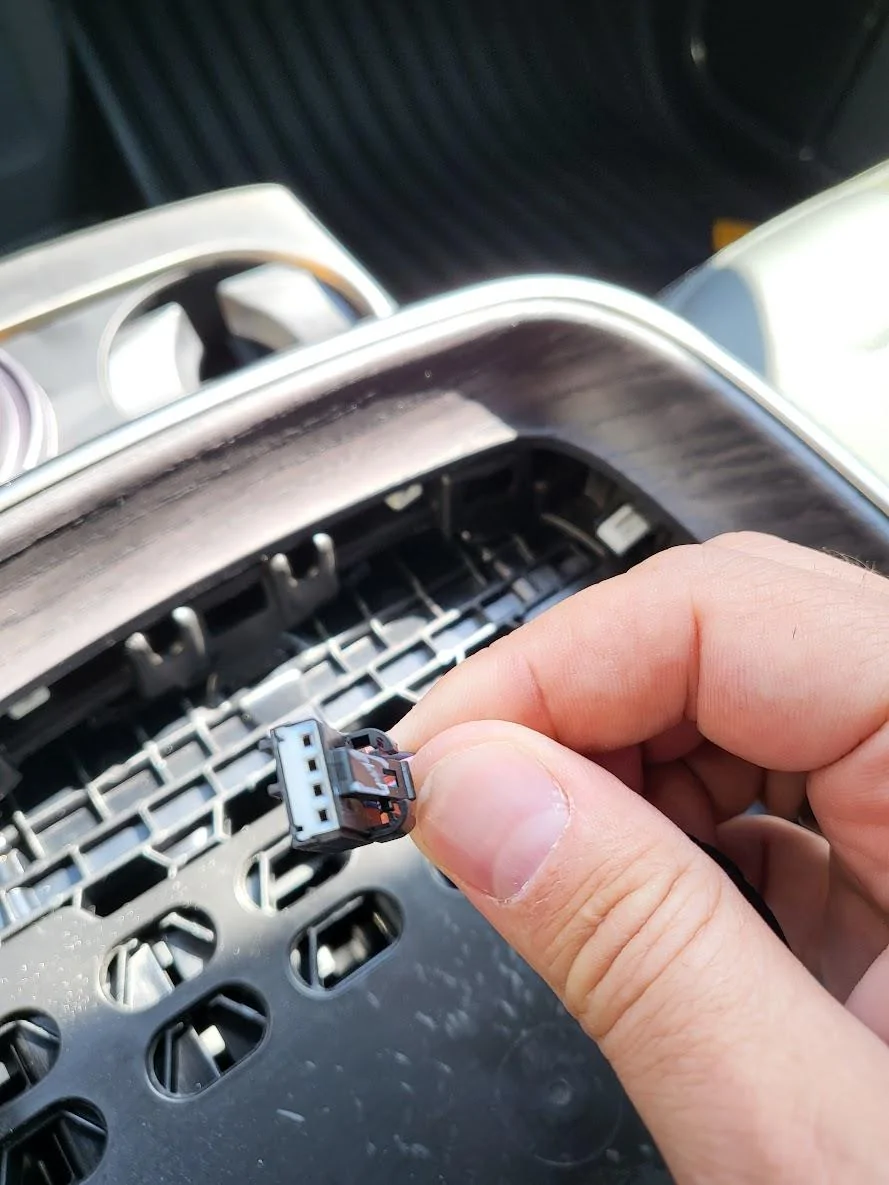

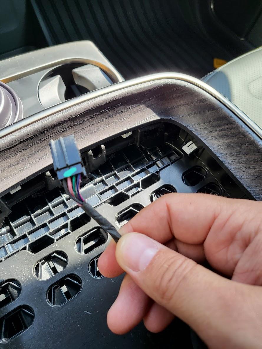

I took some pictures of the connector. Thinking of buying some matching connectors and installing a hardware cutoff switch for the 12v side hidden in the center console. I'll see if leaving it unplugged throws any errors first though.

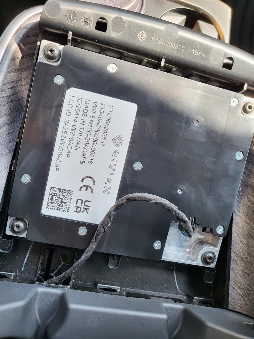

did you happen to try opening the charger module? Curious whats inside as I have been considering trying swap it for a mag safe charger
I didn't open up the charger module itself but it looked like it was within a frame. Probably could be possible to replace the module or something custom / 3D printed and then hide it under the oem mat. A mag safe solution would probably be ideal. I didn't pull out the multimeter to see what the pennant was. I think you were going to go that way it would probably be safer to use USB C power in the console.

Coming up short on trying to find that connector. Molex doesn't seem to have anything like it in their catalog. Any ideas?

I'm thinking this is just a fancy power USB. 4 wires like USB power.
