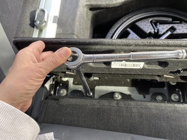

1) Hold open the spring-hinged cover between the 3rd row seats and the spare tire well.
2) Remove the 6ea 10mm bolts. (3 under each half of the cover.)
I removed the one farthest from the hinge with a socket, extension, and ratchet, first.
I left the spare tire well in place. Its lip makes it a fiddley to get to the 2 bolts closest to the hinge, but doable with a box-end. Once you get them a few turns loose, you can do the rest of the way with your fingers. A few of the bolt heads get stuck against the lip of the spare tire well as you back them out. Just keep loosening them all up as much as possible and lifting / wiggling the hinged cover. They will come out.

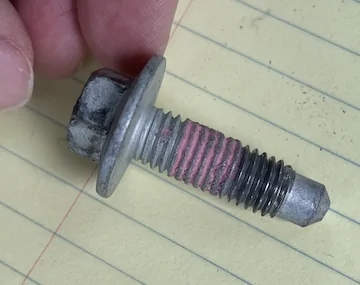

4) Next remove the 4ea 13mm bolts holding one seat back. They have some sort of lock-tight on them, but a breaker bar did the trick to get them started, then a ratchet was fine.

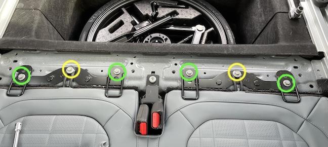

7) Remove 6ea 13mm bolts holding in bench seat bottom. They have some sort of lock-tight on them, but a breaker bar did the trick to get them started, then a ratchet was fine. (If you plan on putting these back in, note the 2nd and 5th bolts on the center of each seat are different than those on the outside of each seat.)

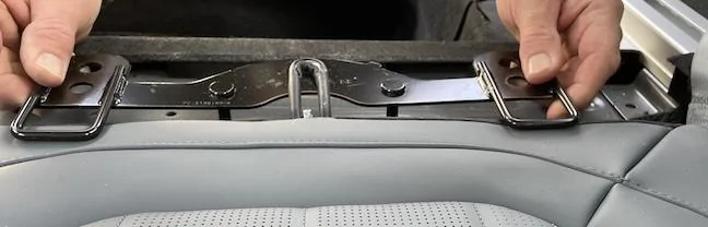

8) Remove 2 brackets brackets (one for each seat.)

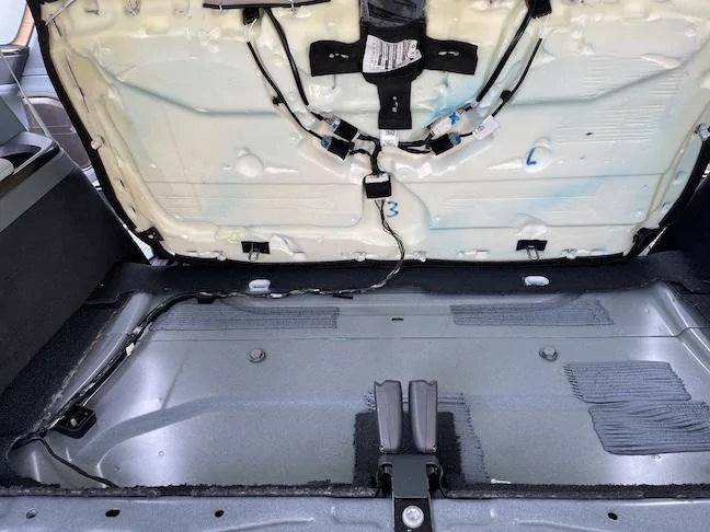

9) Lift and rotate the back of the seat bottom forward. I had to reach below the female seatbelts and pull the fabric around it.
Rivian R1T R1S DIY how-to remove 3rd row from Gen 2 R1S (steps and photos) IMG_2413
(This photo taken toward the front of the car)

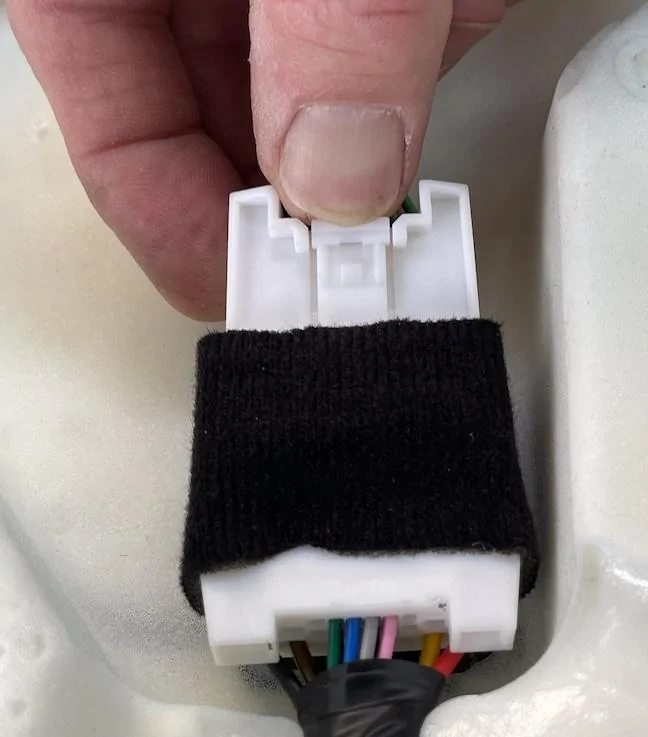

10) Disconnect the connector (by the “3” in the photo above) by pinching the center of the edge that would normally be toward the front of the car.
Rivian R1T R1S DIY how-to remove 3rd row from Gen 2 R1S (steps and photos) IMG_2415
11) Remove the bench seat.

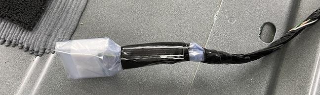

12) I wrapped the side of the connector remaining in the car in a plastic bag to prevent water from getting in – just in case.
Rivian R1T R1S DIY how-to remove 3rd row from Gen 2 R1S (steps and photos) IMG_2417

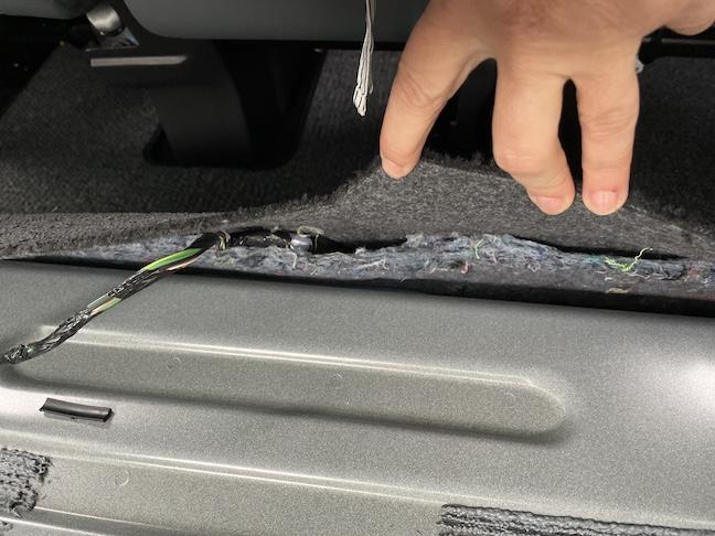

13) I slipped the connector between the flooring carpet and insulation, to keep it from getting crushed later.
Rivian R1T R1S DIY how-to remove 3rd row from Gen 2 R1S (steps and photos) IMG_2418
And ta-da! A lower surface! Next, we build drawers with dog crates on top. (The cover to the spare tire well, fits back on fine. I will likely leave mine off.) I was hoping to find some additional tie down points, but found nothing forward of the row of bolts at the back of the 3rd row of seats. (I put the bolts back in for safe keeping.)

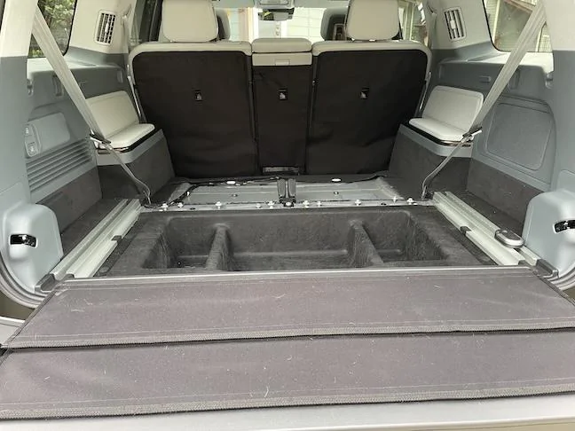

Maybe it's just the photo but after all that work it doesn't appear to make much difference -it looks like maybe a couple of inches lower?
Not a ton lower, probably 4 or 5 inches. But I need them!
