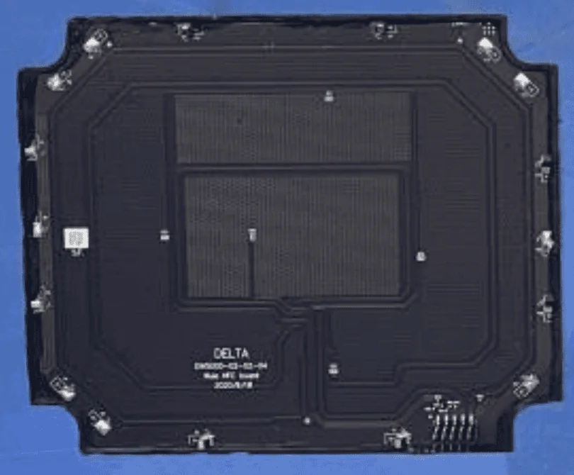

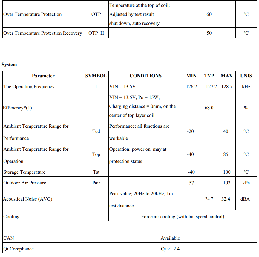

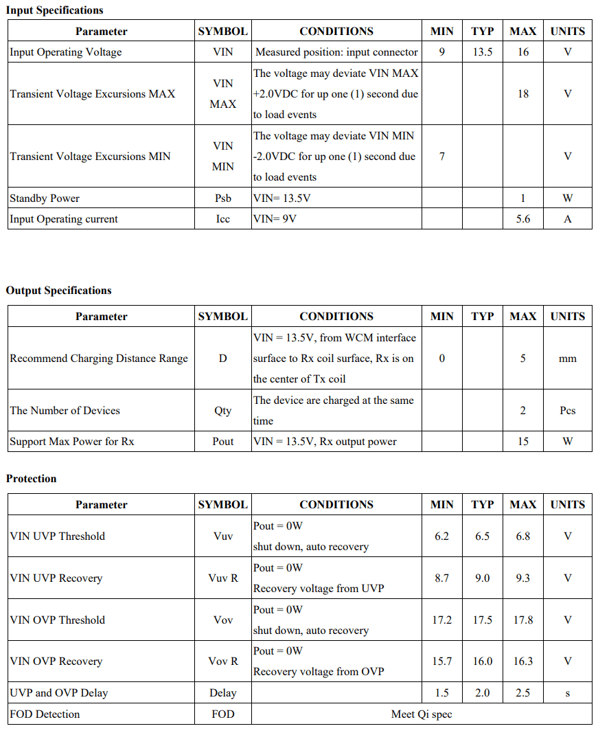

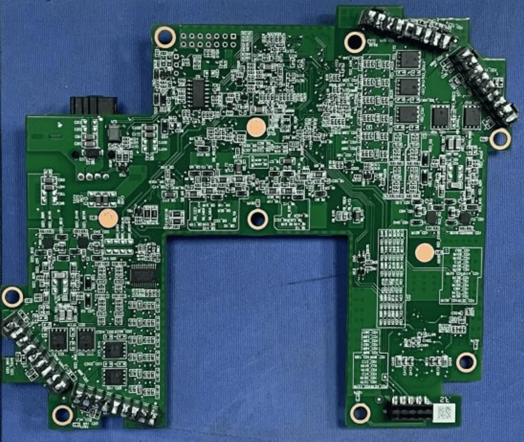

It's disappointing to learn that the performance is so mediocre. This unit is made for Rivian by Delta Electronics (FCCID 2A2EZVW30ACAP, VWPEN16C-30ACAPB, Model PT00062426-B) and has 18 Qi coils in it, and is supposed to provide 15W (CISPR-25). Also supports the CAN interface and should have the CAN BUS vocabulary to enable or disable through CAN BUS control. No way to disable the charging pad from the center console? If not, I think that's a Rivian software issue.
Here are the electrical specs:
Rivian R1T R1S Disabling Wireless Charging Pad - Photos & Observations 1651989396431
Rivian R1T R1S Disabling Wireless Charging Pad - Photos & Observations 1651989449794

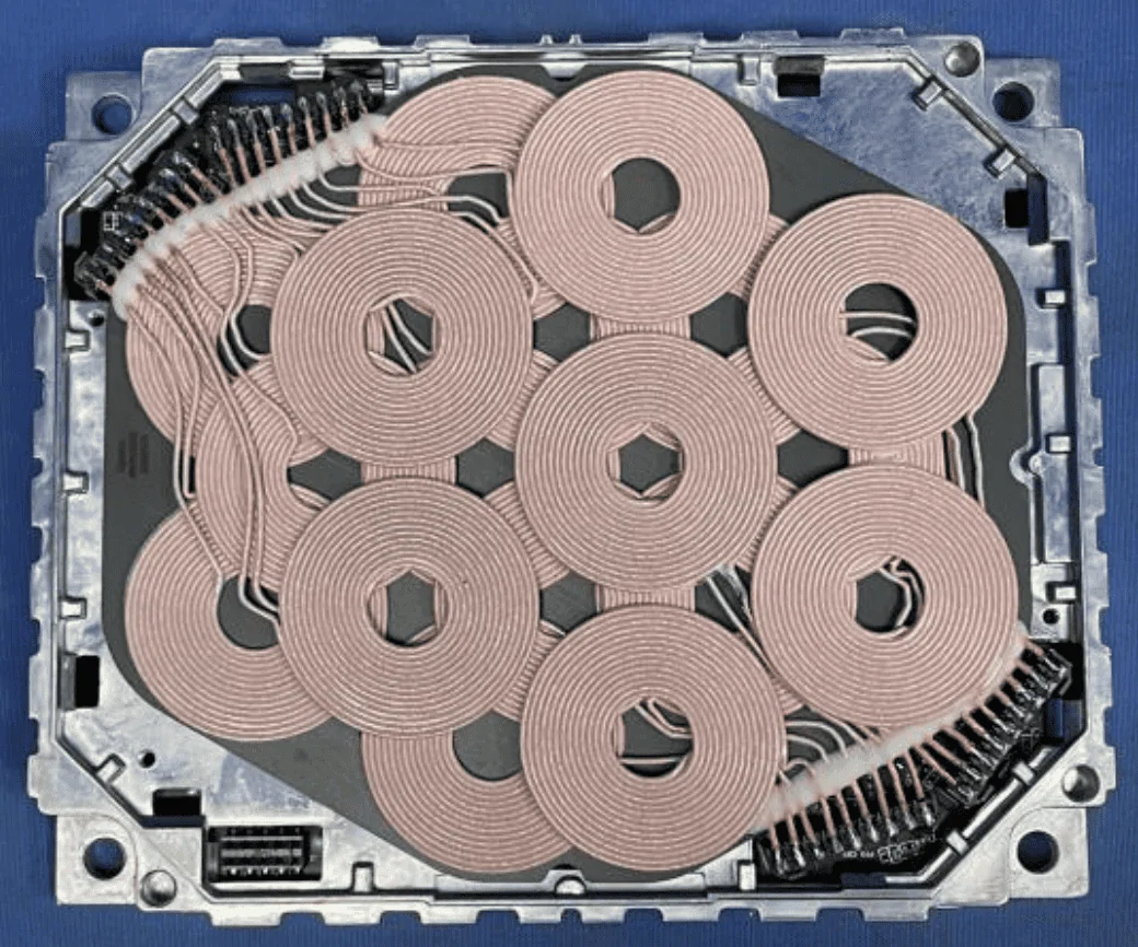

9V at 5.6A (Max) is 50W. All to get 15W of wireless Qi charging power. Yeah, that's worse-case, max load, but still... Even if charging two devices, that's still quite lossy - specs claim 68% efficiency. But wireless charging sucks and we all already knew that. The coil arrangement is gratuitous:
Rivian R1T R1S Disabling Wireless Charging Pad - Photos & Observations 1651989846713
You'd think after seeing all that overlap that the performance of this thing would be mind blowing...

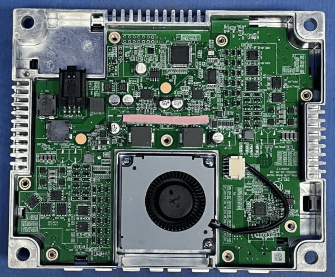

Here's the main board + fan:
Rivian R1T R1S Disabling Wireless Charging Pad - Photos & Observations 1651989902961
Mainboard back:
Rivian R1T R1S Disabling Wireless Charging Pad - Photos & Observations 1651990012564
Rivian R1T R1S Disabling Wireless Charging Pad - Photos & Observations 1651990084760

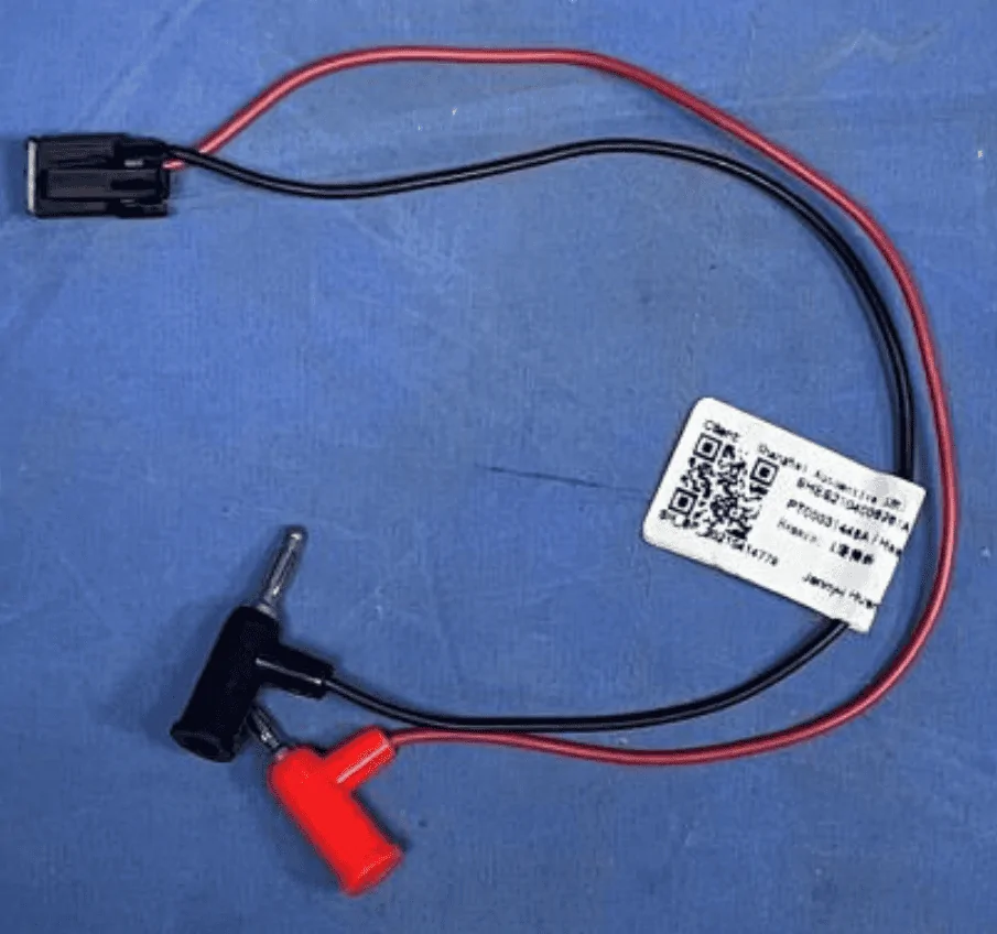

A picture in the external photo exhibits at the FCC shows an interesting cable that would help easily identify the primary power vs. CAN bus connections:
Rivian R1T R1S Disabling Wireless Charging Pad - Photos & Observations 1651990817500

I think this is it
That should be it. Nice find!
H-DAC 64, 4 Way Receptacle Assembly
Is what the other end of the cable is.
