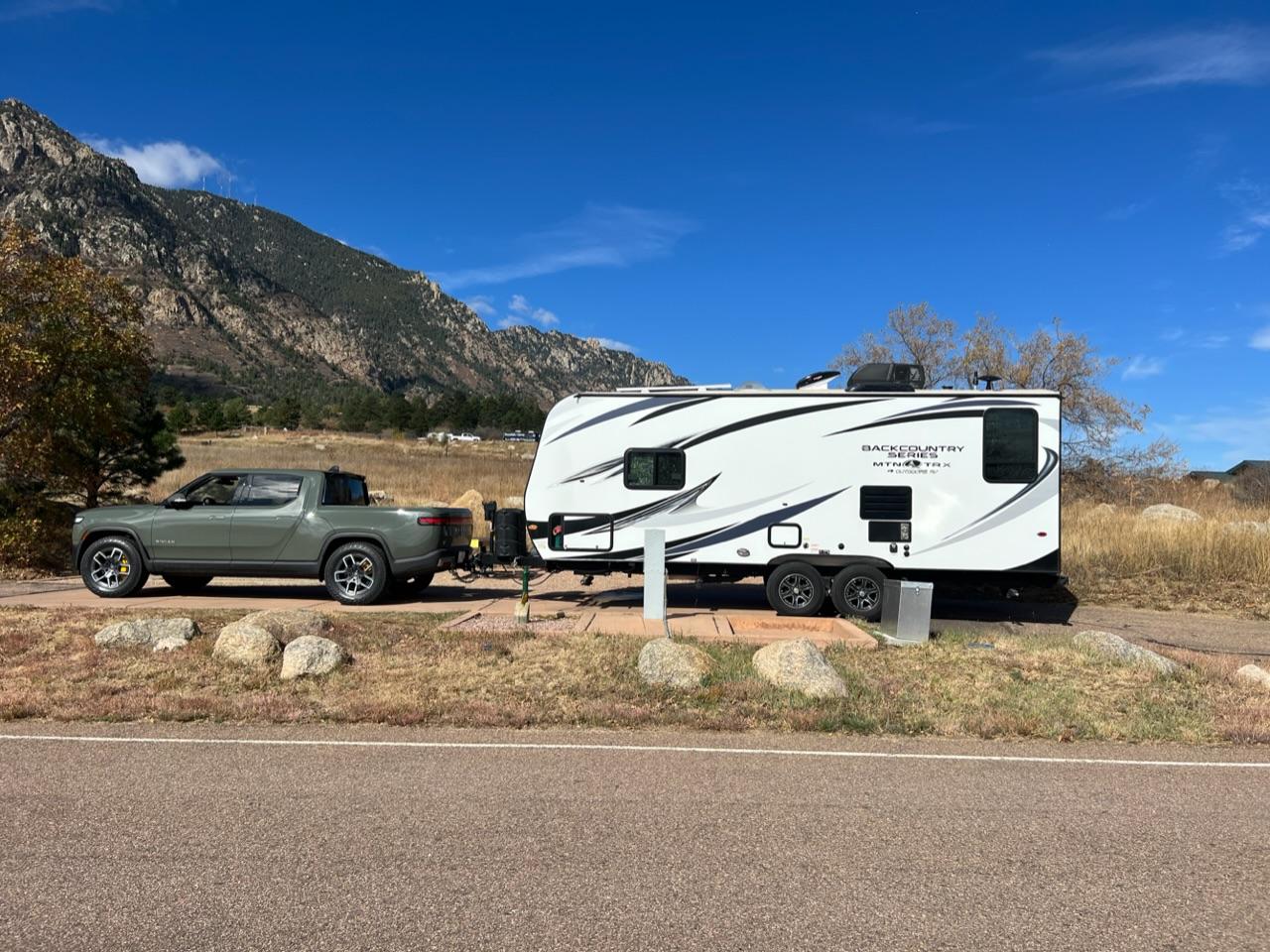

I tow my trailer twice a week between my work week spot and my weekend spot. It weighs about 7000lbs and the R1T pulls it better than any other vehicle I’ve used including a 2500HD diesel. The 11 mile drive is up hill one way and down on the return trip and my average is 1.15mi/kw.

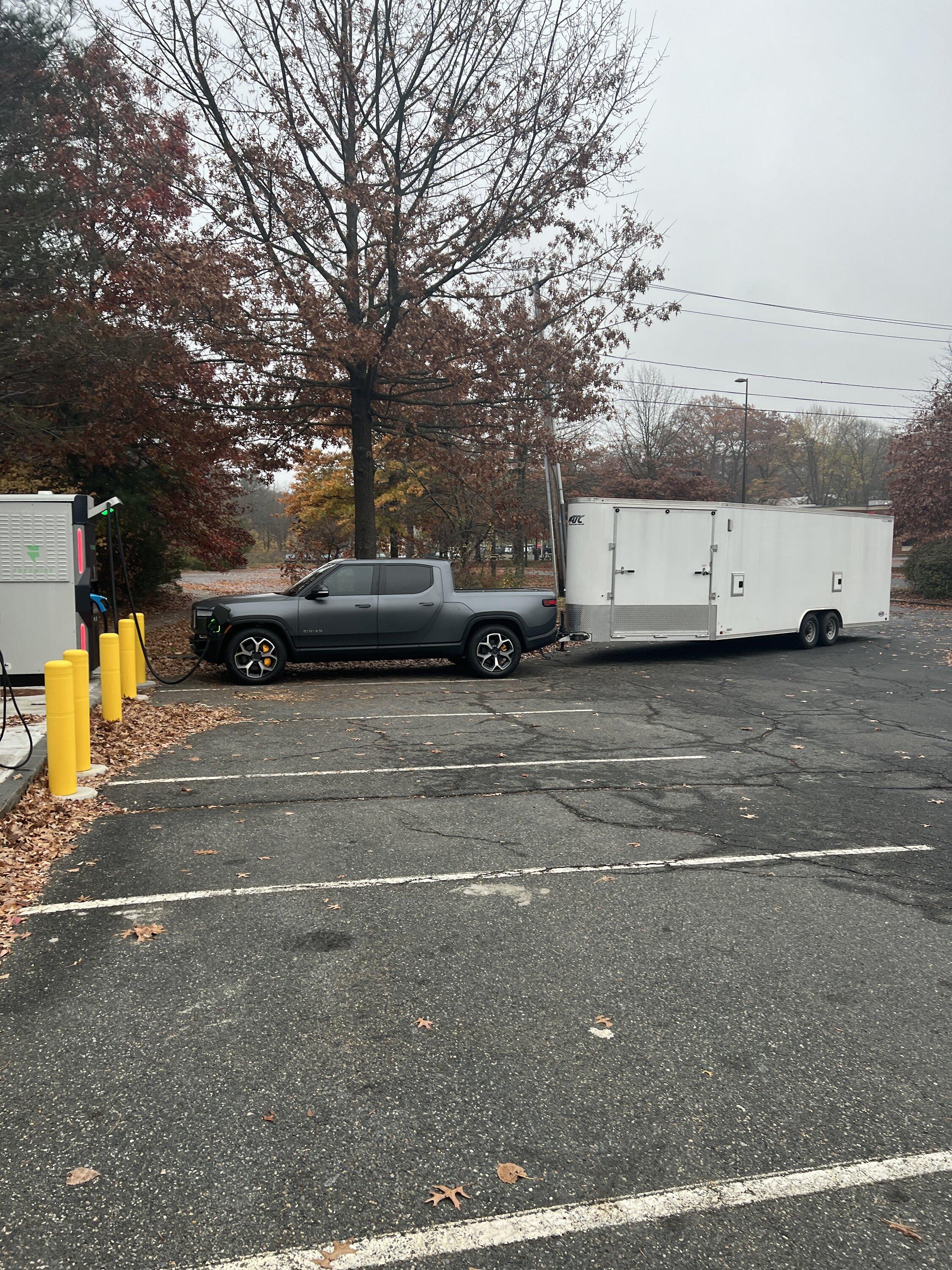

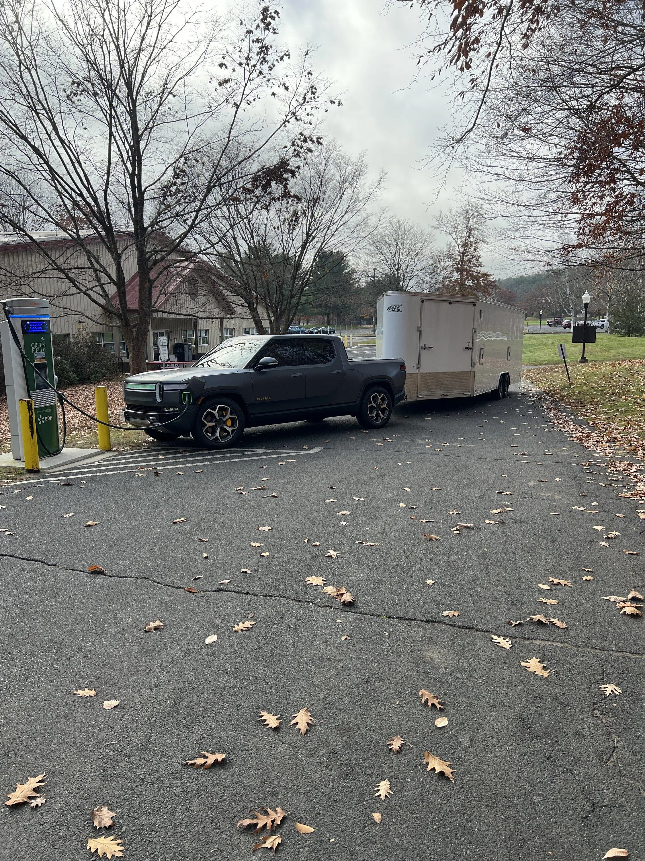

Mirroring what others have said, this truck pulls a trailer with zero issues except range. You can’t hear any struggle in the drive train and really wouldn’t know it was there without looking in the rear view or watching your battery percentage evaporate. Accelerating from a stop is effortless. Even driving into a headwind, there’s absolutely no struggle.
I just completed a 128 mile trip with my aluminum 30’+ yoke v nose car hauler loaded with 4 snowmobiles and gear est. 7,000lbs. I started with 100% charge and 50 degree weather at 180’ above sea level and climbed to around 600’. Speeds were between 25-75 with secondary roads and highways being about equal travel distance. I averaged just under 1kWh per mile. Stopped to charge at 88.7 miles with 23%/27 miles range left. Had an issue getting a supercharger to work so got stuck on a 50kW charger and made it back to 73% in an hour. That was enough to get me to my destination that was 38 miles further up through a 2000’ elevation and back down to around 580’. Dropped the trailer and took the 128 mile trip empty home. Long story short, looks like charging at 90-100 miles range with my setup is safe until the temps really drop.

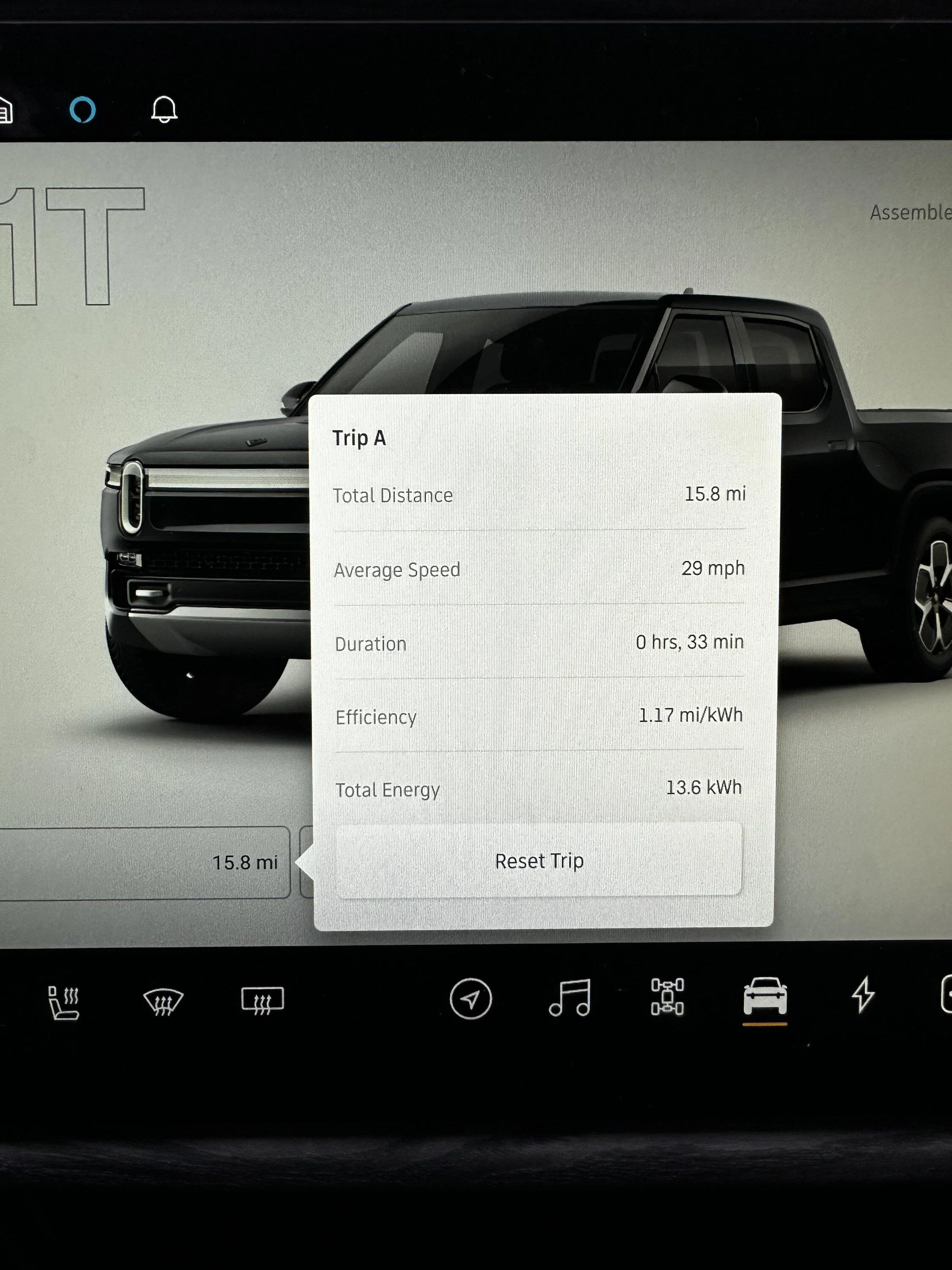

First time towing our Rockville minilite (Approx 6500 lbs) Short trip, hilly but towed well. Never went faster than 45. Haven’t towed before so just getting my feet wet!
