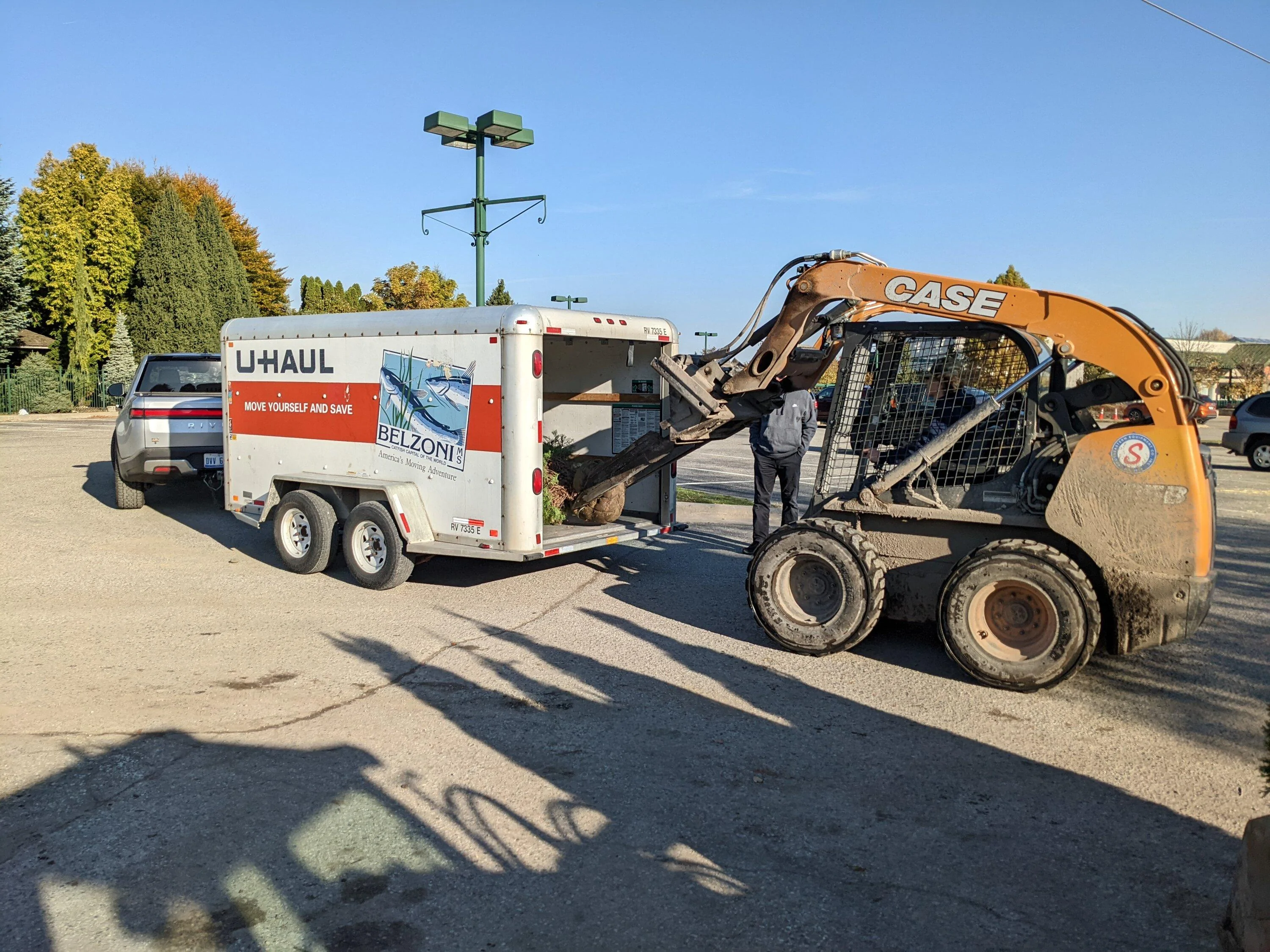

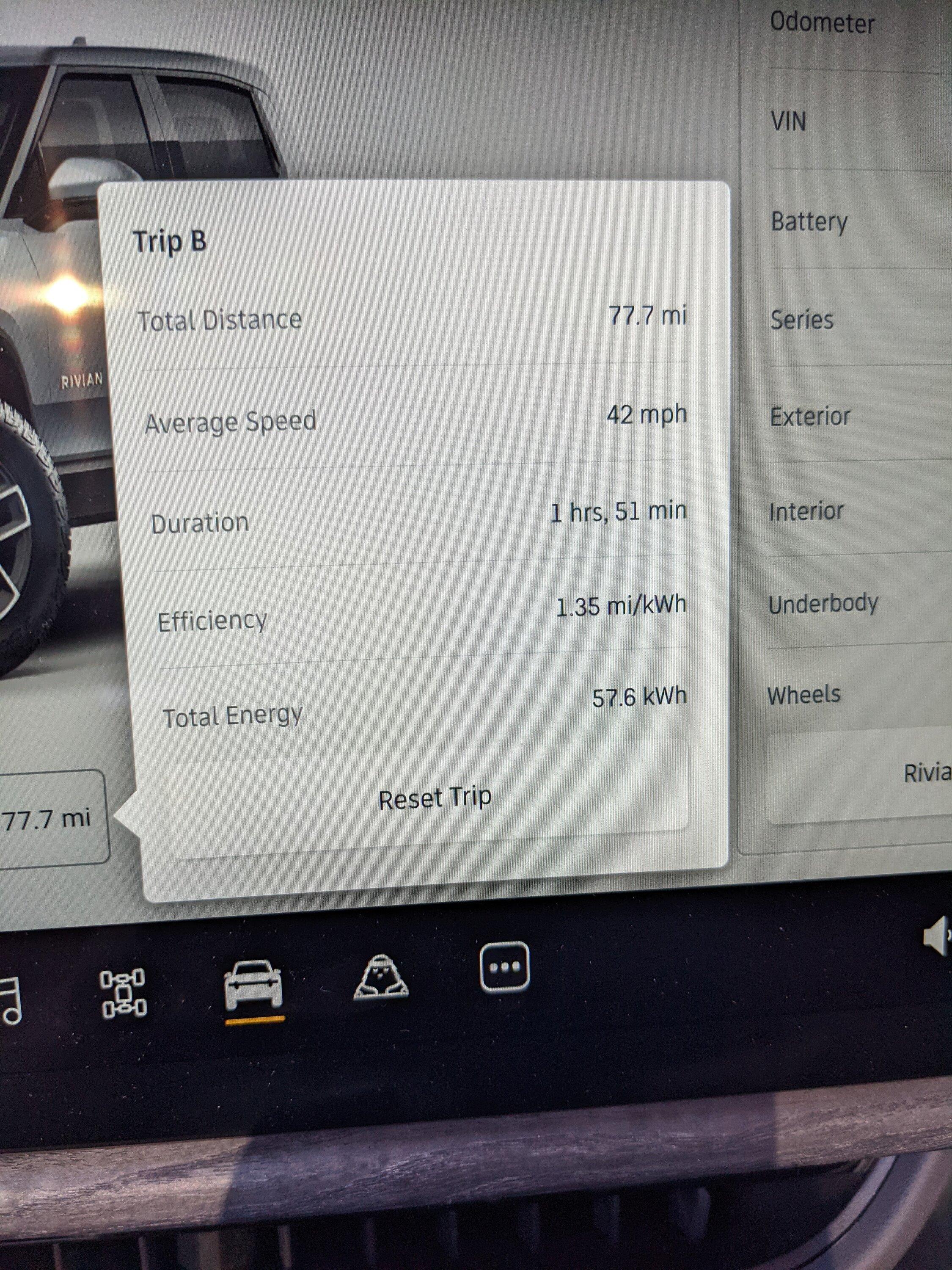

Only trailer experience I had was with this uHaul 77 miles total, half empty half filled with trees. Empty 35 miles was on back roads doing 55mph, built up confidence in the range estimates and took the highway back mostly at 70-75mph. Worked like a charm and the estimate seemed to adjust pretty quickly to the load but started off assuming it was a full 11k lbs. 1.35mi/kWh
Edit: I have AT 20"s
