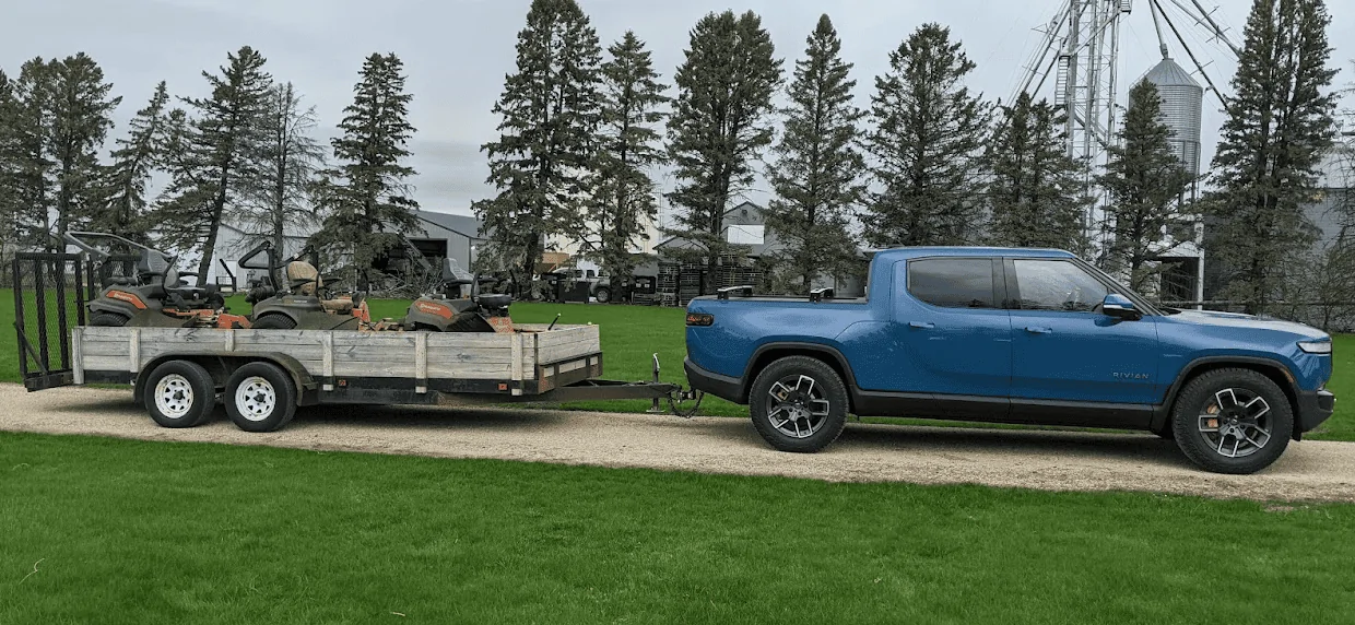

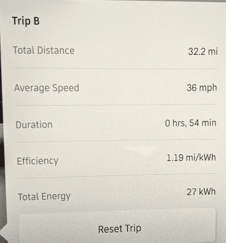

OK, so I was actually trying to gather some of this information for a post of my own but this seems like a good place to put it. I pull a trailer for a mowing business that I do as a side gig. The trailer is 18' long not including the tongue. I don't know the weight of the trailer but its not exactly the lightest thing built out of steel and has a wooden deck and wooden sides. On it I carry 3 large zero turn mowers that each weigh around 1200lbs.
Normally I don't need to travel very far with the trailer/mowers but this week I needed to do an errand while I was out mowing and didn't have time to drop them back at home so everything came with me. I reset the trip meter so I could capture some data. I traveled just over 32 miles round trip. 16 miles were into the wind and 16 miles with the wind at my back. Cruise was set at 60mph but I did start in town, drive to/through another town, and then go back with a few stop signs mixed in there as well. Wind was 20 mph and it was 65F out. The R1T has been pulling this trailer/load a few times now and does great. Most of the time you forget the trailer is even there as the truck doesn't struggle at all. It really is a great towing vehicle. When I get my boat out in a few weeks I'll be doing some further towing and gather data then too.

I have a similar trailer. With the sides, the weight is probably in the 2200 - 2300 lb range, so you were close to 6,000 lbs total with 3 ZTRs.

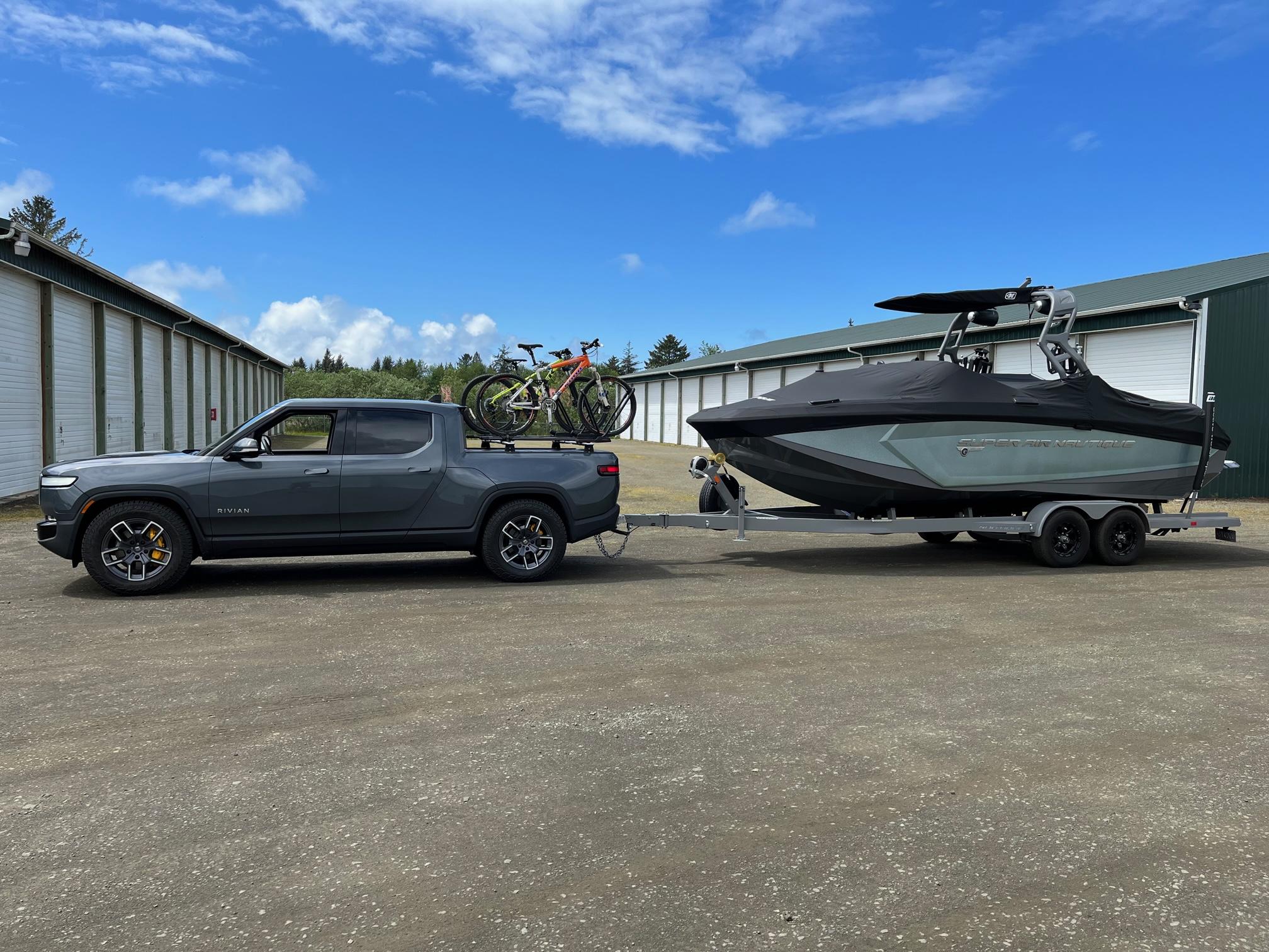

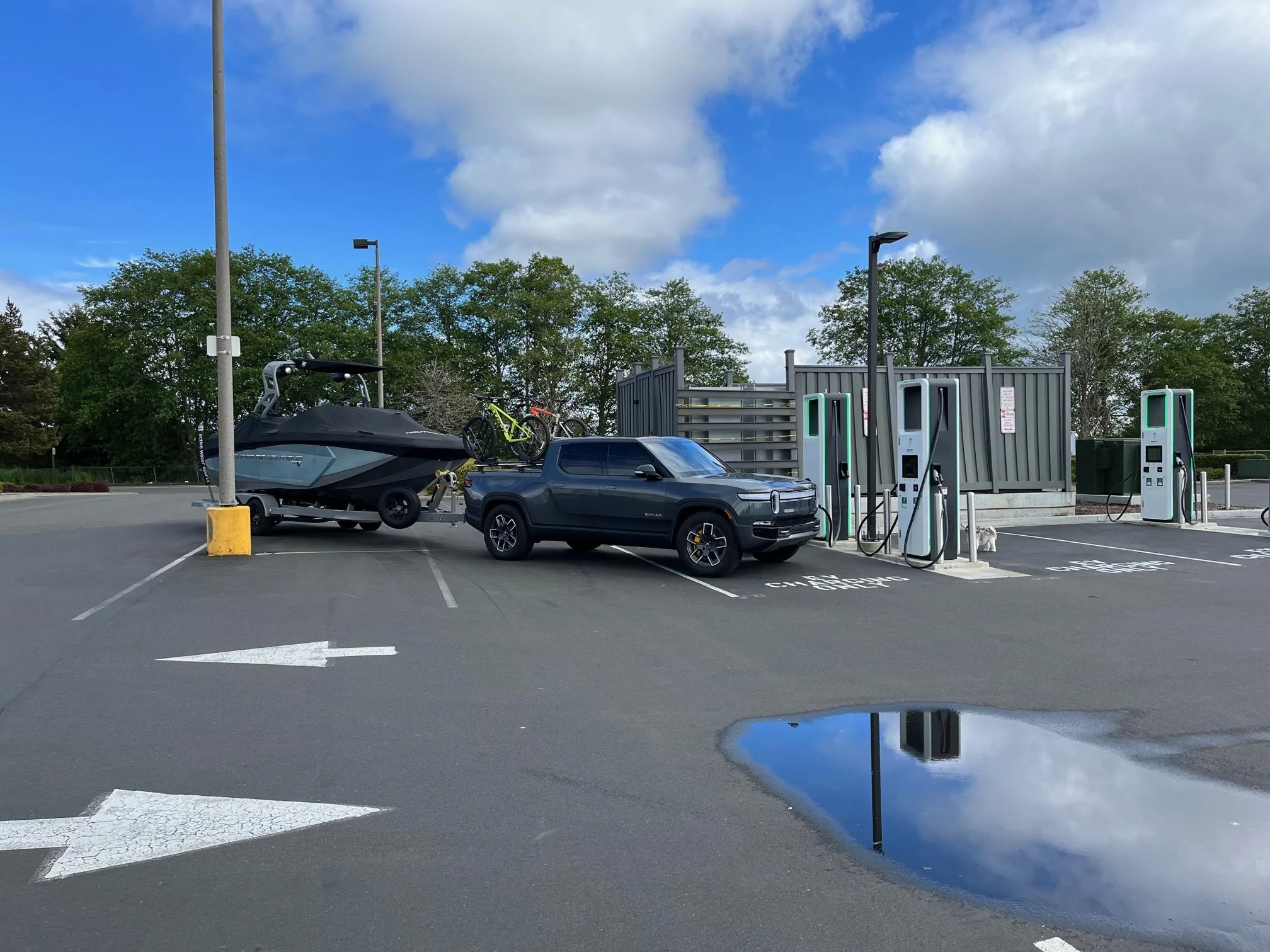

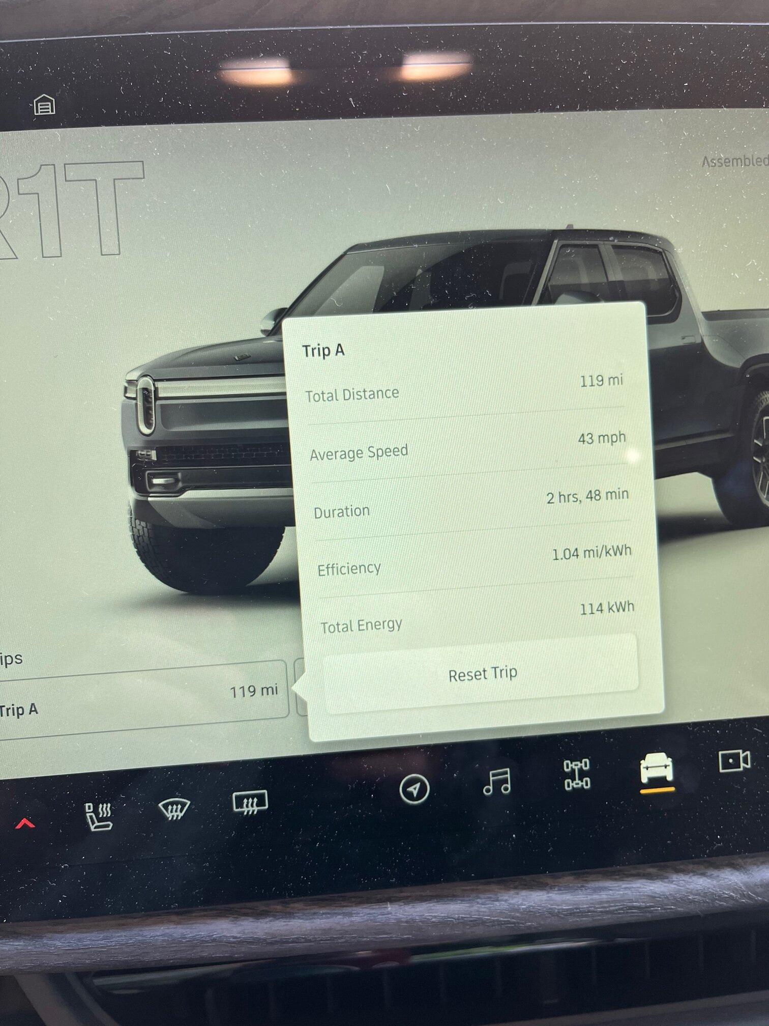

I just did another tow test this last weekend when I brought my boat back from storage. Total trip was 119 miles from Longbeach Washington to Portland Oregon. I stopped and charged to 97% in Warrenton at the Electrify America station and made it home following HWY 30 (98 miles) with 24%/22 miles remaining. This was better range than when I towed my camper trailer. The boat is heavier (8500lbs), but more aerodynamic. The route also had slower speeds, but more hills (mostly 55mph vs 65mph). Next time I might try going up and over the coast range on HWY 26. The route is shorter by 10 miles, but the hills are 3X higher and there are no available chargers along the way.
Rivian R1T R1S Towing + Efficiency: Please post your experience! Boat 1
Rivian R1T R1S Towing + Efficiency: Please post your experience! Boat 2
Rivian R1T R1S Towing + Efficiency: Please post your experience! Boat 3
Beautiful setup, i'm eager to try a longer trip with mine, and also how it does with launching.

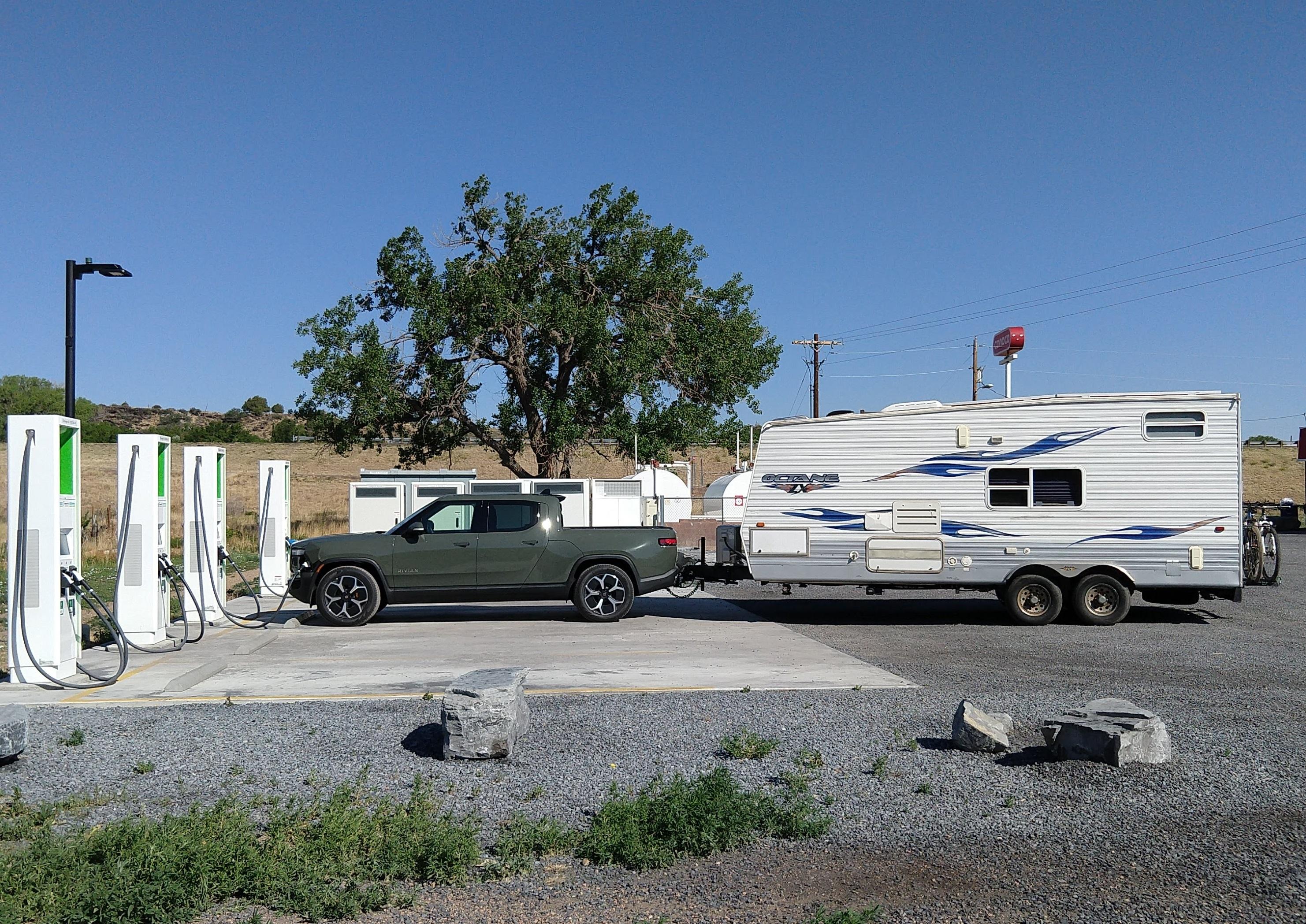

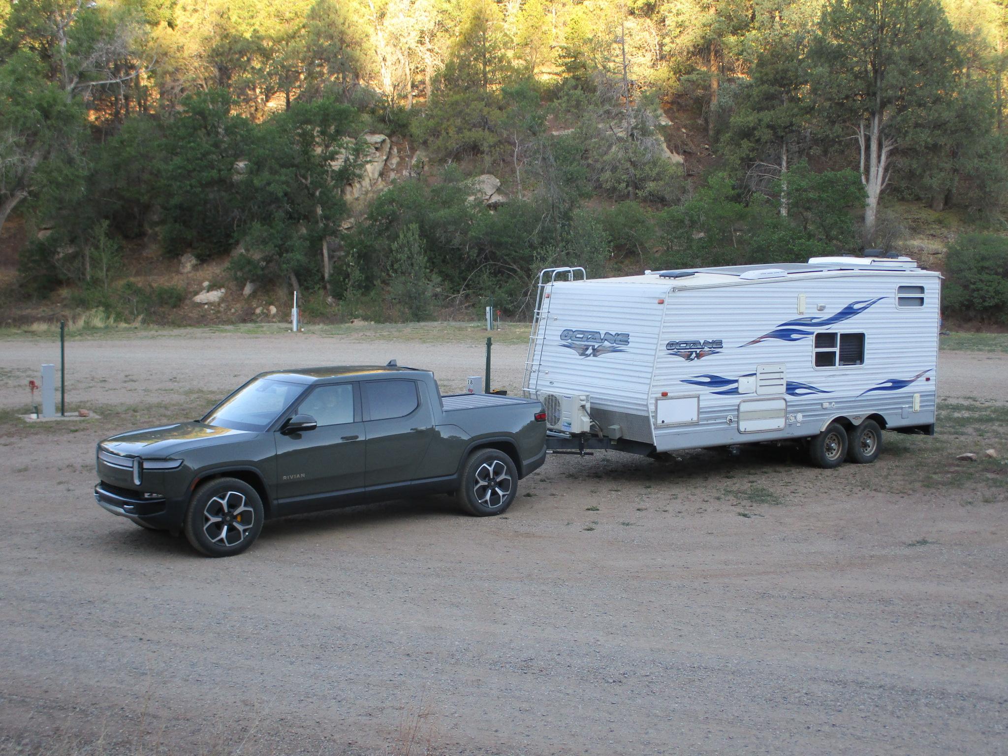

We are towing our Jayco Octane TT (that we live in) and collecting data as we go. Here's a very quick first-pass bit of data from our journey from northern NM to southern MT:
Efficiency (miles per kWh) as reported by our R1T = anywhere from 0.95 to 1.40
Obviously this varies based on speed, grade, temperature, and heat/AC usage; also seems to be highly affected by wind (including a good push from a tailwind and negative effects from a strong side wind)
A lot of this has been highway driving; parallel local roads when we can find them are a nicer time
The actual towing experience has been awesome = smooth ride, easy handling, quiet
Our trailer needs to be weighed for a current #; we estimate it's about 8000 pounds (depending on tank levels)
Occasionally we find a charger where we don't have to unhook (yay!) but mostly we're getting good at dropping the trailer to charge
Really appreciate the ability to charge up at RV park 50A plugs; normally we prefer boondocking and Harvest Hosts, but we're willing to adapt our lifestyle at the moment to allow us to tow our all-electric travel trailer with an electric truck!

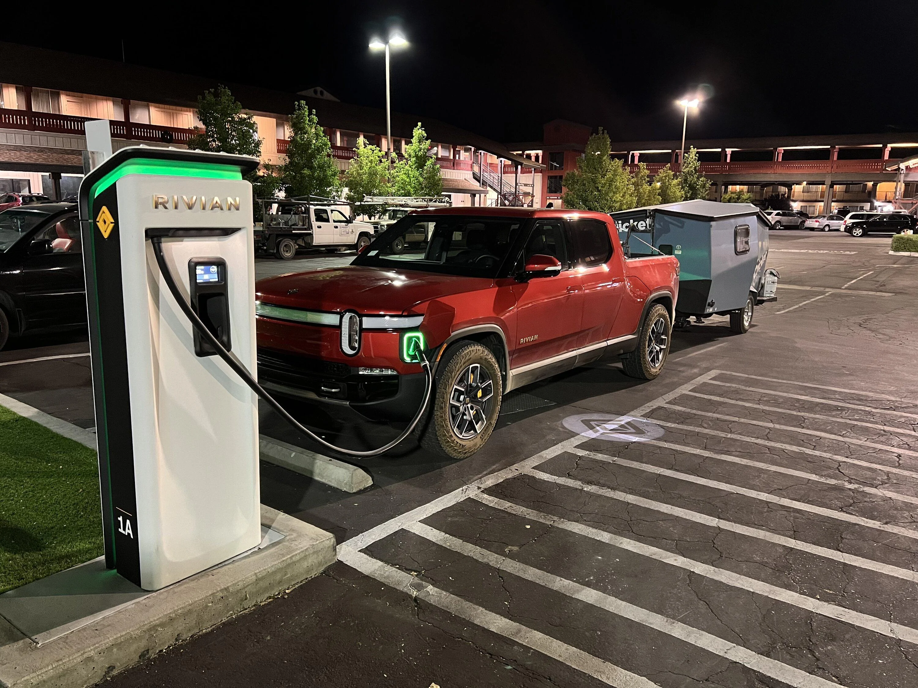

I meant to post my results from a camping trip a few weeks ago. 1.4 mi/kWh at roughly 65 mph towing a 1500 lb trailer on 20” AT’s. Trip was almost 600 miles and up some mountainous terrain in the Eastern Sierras. See the original post on Reddit (link)
Had a great time this weekend seeing what the R1T could do with towing our Taxa Cricket. I was a max pack holder who converted to large when I saw my configuration show up on the R1 Shop. So far no regrets on the large size battery pack, it wouldn’t have made much of a difference for this use case (still 2 charging stops each way).
The Cricket is somewhat aerodynamic - has tapered shape and smaller frontal area than most trailers when closed. Definitely a great option to pair with the R1T and being able to camp in remote camp spots.
Final efficiency was 1.4 mi/kWh @ 65 MPH, 577.8 miles round trip.
