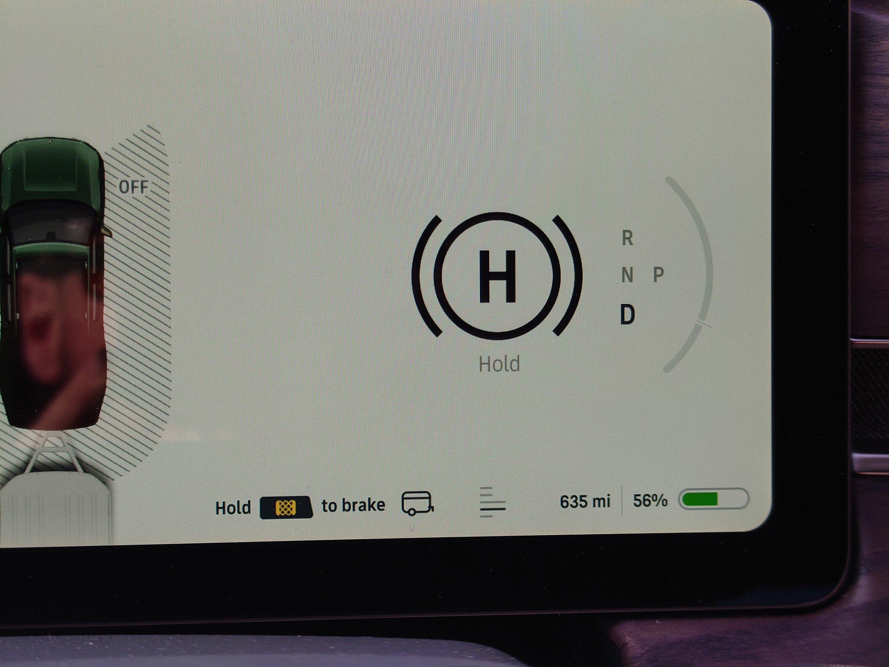

It only triggers when you actually hit the brake pedal. You’ll see it on the bottom right of the IC when it’s braking. It doesn’t work with one-pedal. I’m not sure if this is a good thing or not. On one hand, it’s more efficient. On the other, it’s maybe a little less safe/stable. ?‍♂
Ok I stand corrected. Never really saw it before but yes, trailer braking works just like any other truck. Like I mentioned before with my application regen is good enough and rarely touch the brake pedal. Haha
Having said that, brilliant application by Rivian using the button in the steering wheel rather than stretching to find a button on the dash.

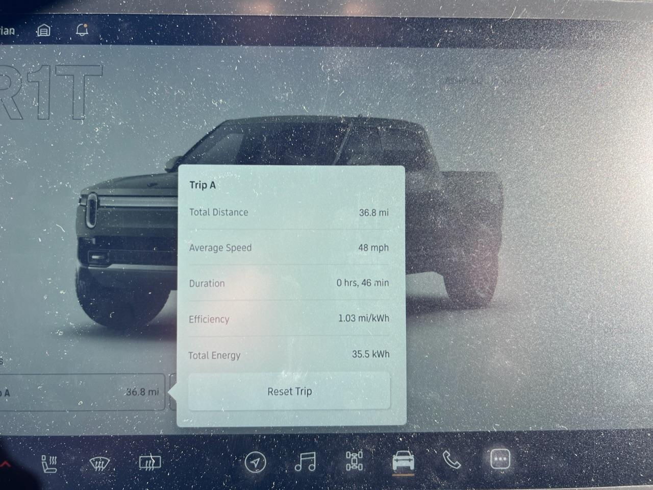

I towed my trailer about 40 miles down the freeway to a weekend campsite at the lake. No issues per usual.

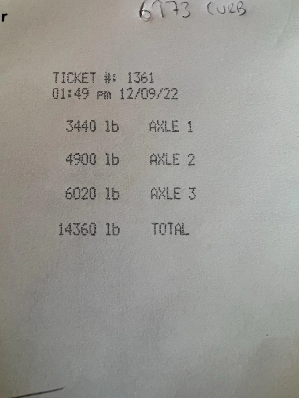

I stopped at a weigh station to get a better idea in truck/trailer weights and need to go back with just the truck to get the precise numbers. Front axle 3440lbs, rear axle 4900lbs and trailer axle 6020lbs. The truck curb weight should be right about 6973lbs (8532lb GVWR minus 1559lb payload rating). Subtracting the stuff in the truck plus myself gives the front two axles a combined weight of 8000lbs meaning a tongue weight of about 1000lbs.
Rivian R1T R1S Towing + Efficiency: Please post your experience! 0197F8BD-4FD9-4C8B-8483-0DBF3624DEA7
I left the weigh station with 76% and arrived with 45%, at 1.03kw/mi.
Rivian R1T R1S Towing + Efficiency: Please post your experience! 818FDCCC-B396-4A2E-96FB-FE93CC84668D

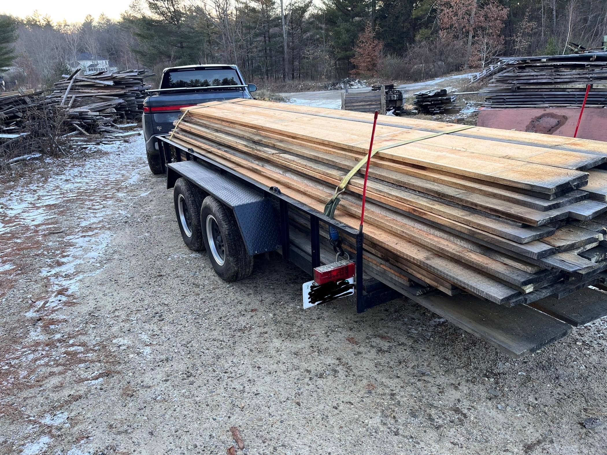

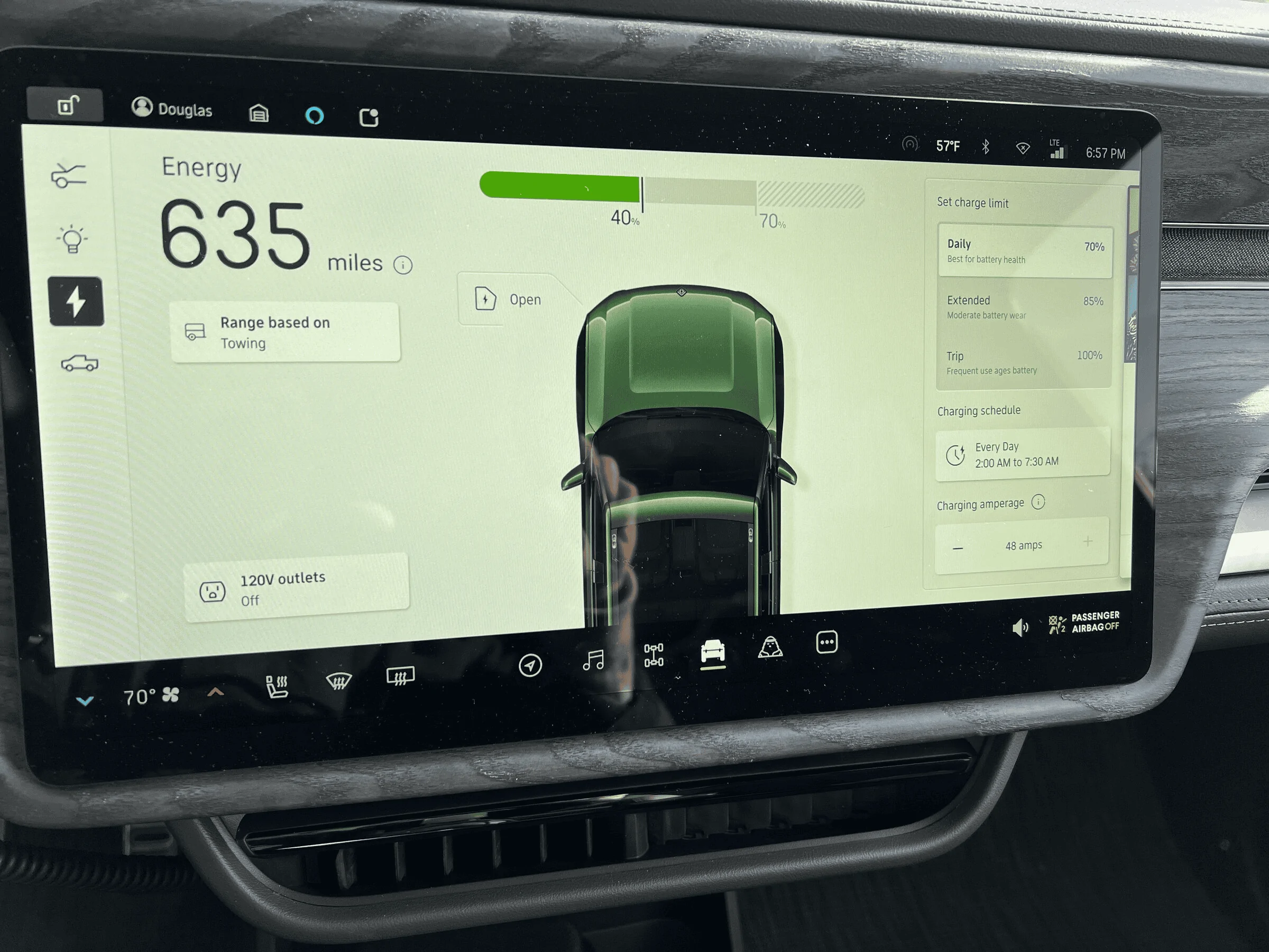

I hauled some lumber yesterday. Roughly 100 miles total and the lumber weighed approx 2k lbs. and 2k for the trailer, so total about 4k lbs.
The range kept increasing as we were driving it empty. Not sure what happened, it went all the way up to 635 miles.
The battery is at 50% when we got home, and the range says 260 miles, so something isnt right. Anyone else notice weird range prediction behavior when towing? It was roughly 50-55F out.
@ 1.8mi/kWh
Yes - the 635 mile range bug has been seen by a few folks - I posted the following thread in May at the end of a towing trip:
My R1T has the best towing range of any EV on the planet! | Rivian Forums - R1T R1S R2 Owners, News, Discussions, RIVN Stock
I've not towed nor seen any weird range estimates since.

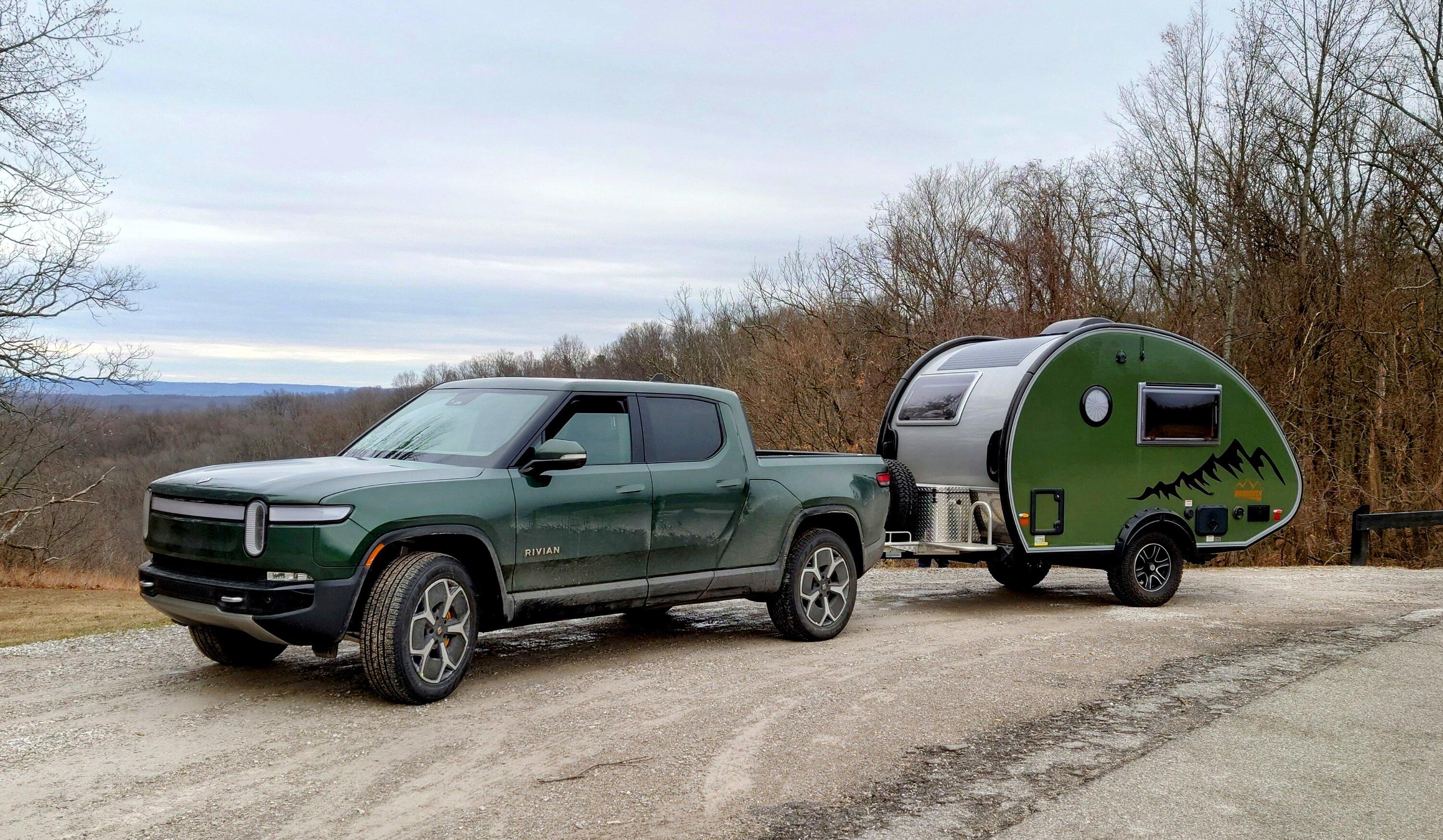

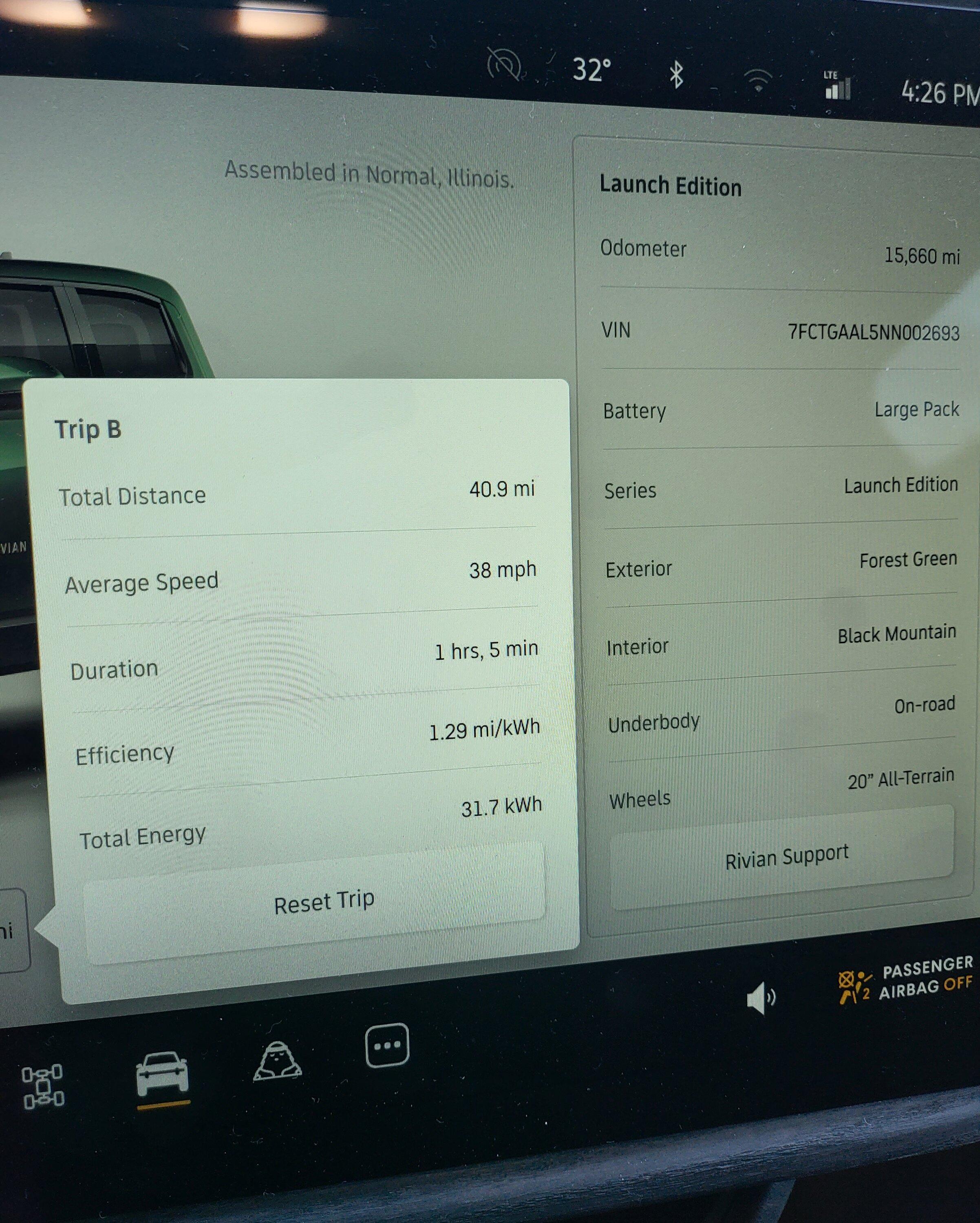

Did our first towing with our week old R1T. Frustrating that the range estimate is completely broken in towing mode. Varies wildly from 140 to 630+mi. It almost seemed to add miles the lower we got in charge.
We got about 1.35mi/kWh towing a large teardrop at 60-70mph.
Rivian R1T R1S Towing + Efficiency: Please post your experience! 20221229_113223~2.JPG
Rivian R1T R1S Towing + Efficiency: Please post your experience! 20221228_140639.JPG
