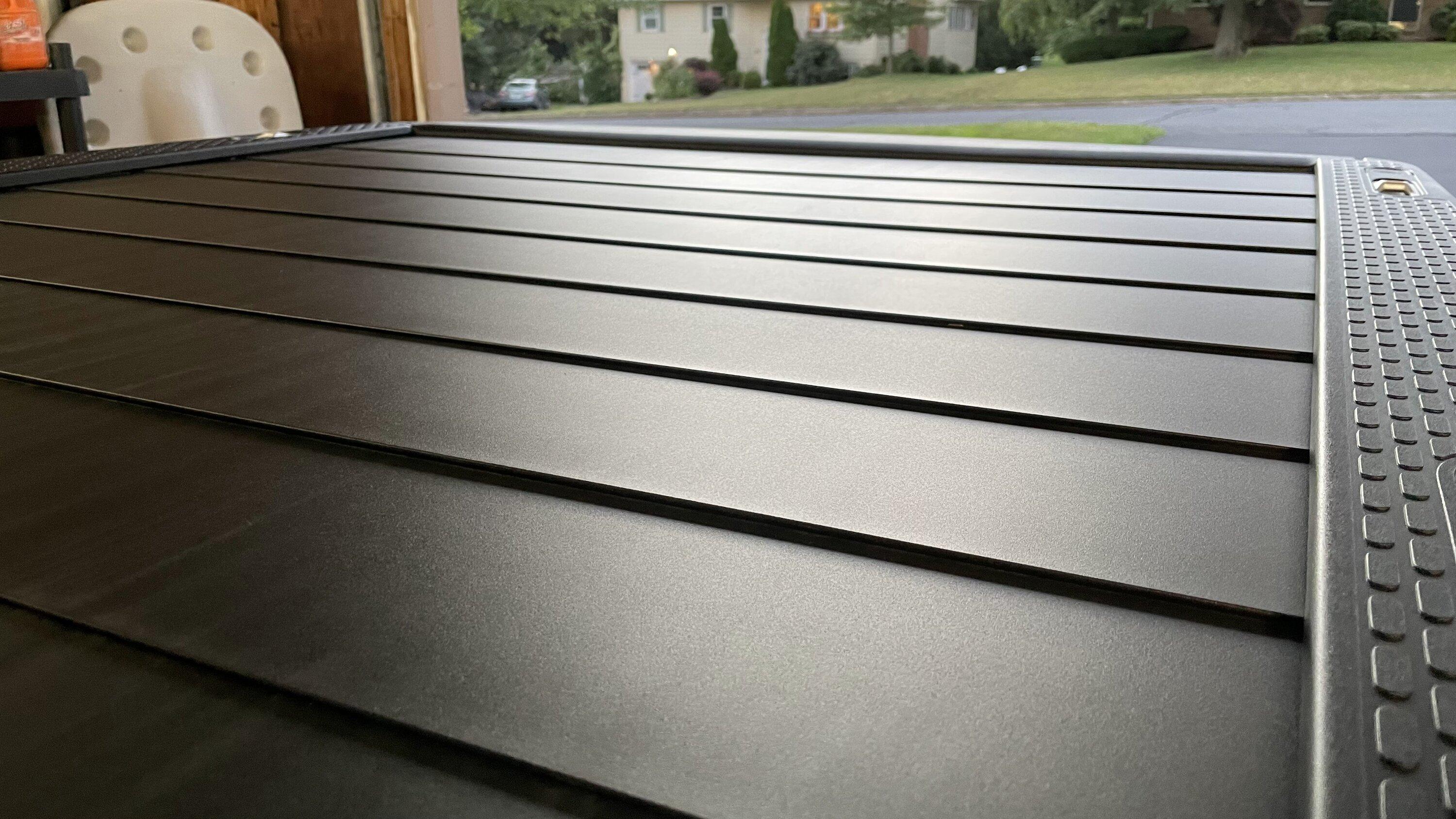

Got ours Friday. Worked twice while the delivery person was here, then tried to show a neighbor once he left, and it only opens one slat width then stops and the lights flash. It stops as soon as the first seam contacts the strip by the rear of the cab. It can at least close, which for our near term needs is better. Already submitted a service request and heard from customer service that they are working on a service plan, but no other details.
camaroz1985
Oct 5, 2021
923
978
Carlisle, PA
R1T, ID.4
I tried the reset procedure, and as expected it didn't work (and didn't finish the reset). The good thing to that, at least to me is that it disabled the outside button so now when everyone tries it nothing happens and the loud popping noise doesn't continue to happen and cause any further damage.
I did notice that my panels all seem to stick up toward the forward edge. I assume that is because it is being pushed back to the tailgate as hard as it is, but they don't flatten as it tries to move, which is what seems to be what gets caught.

Mine are similar (overlap on one side), but wasn't sure if that is normal. I have seen some pictures that look flush.
