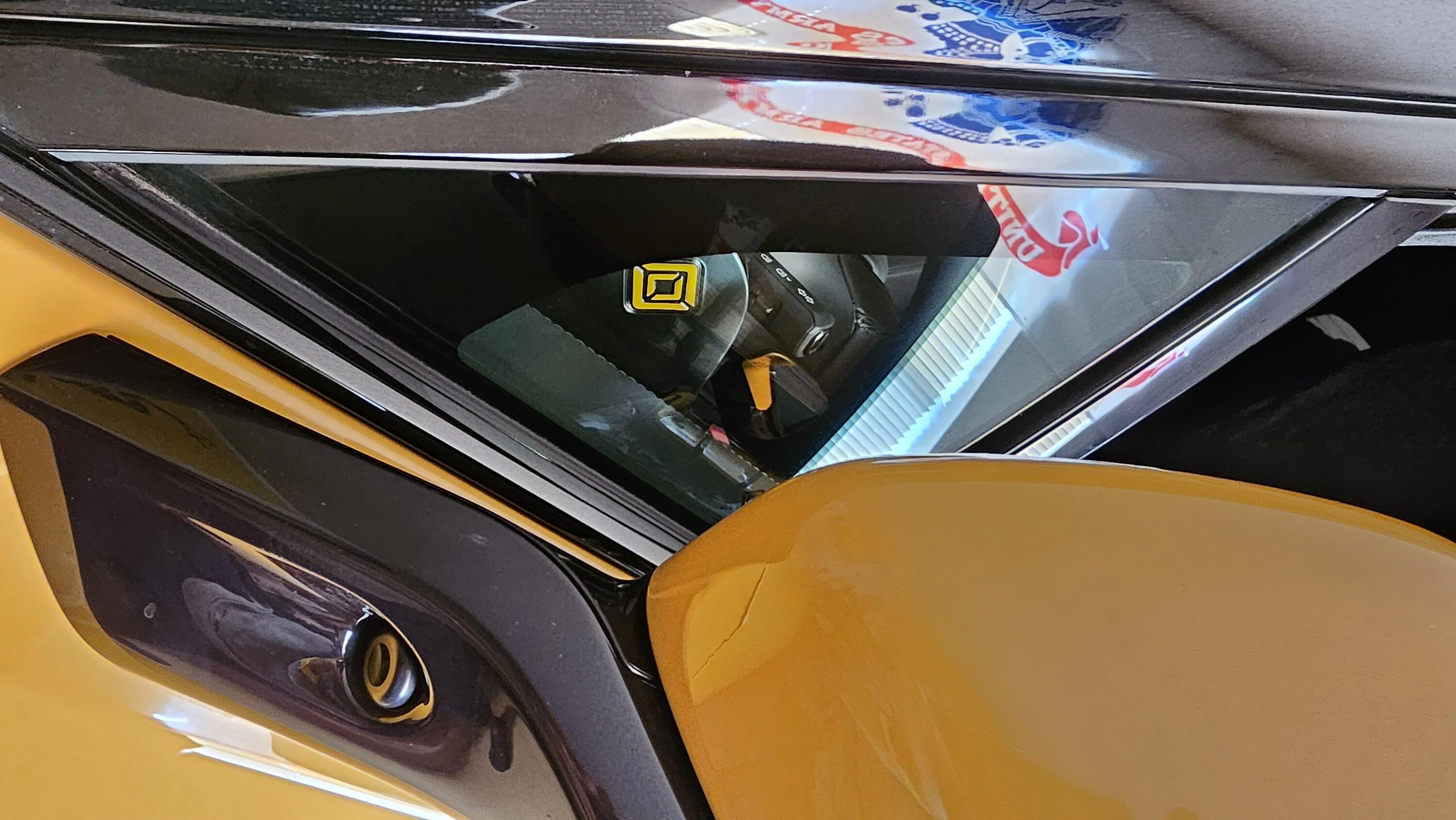

My 2022 R1T has the same issues. The culprit turns out to be a improperly mounted quarter window and a poorly manufactured Sideview mirror (all on the driver's side) that has a gap which in turn produces a whistling noise. The quarter window and seal was eventually replaced and the side mirror repaired to fix that gap. This is a well known issues with early build R1Ts, per the mobile technician. Pass this info onto the SC to see if this helps refresh their memory :p
Good luck and keep us posted!
(The picture is from my 2023 R1T not the troubled child 2022 R1T ? )

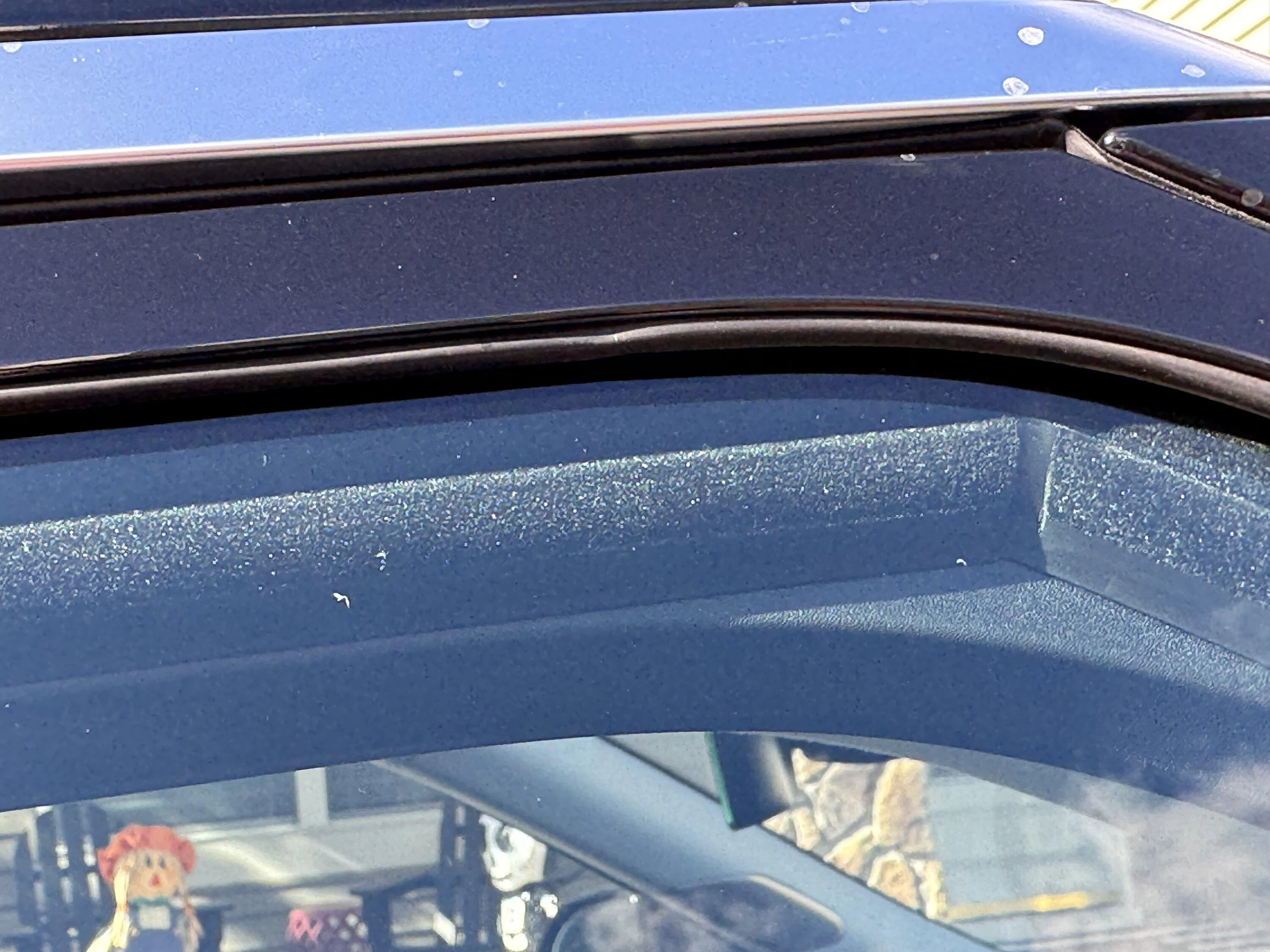

Check the gasket for the drivers side window. My gasket seems to “fold in” when the window is closed and isn’t creating a seal.
Rivian R1T R1S Service center cannot correct wind noise. How to proceed? IMG_0062
