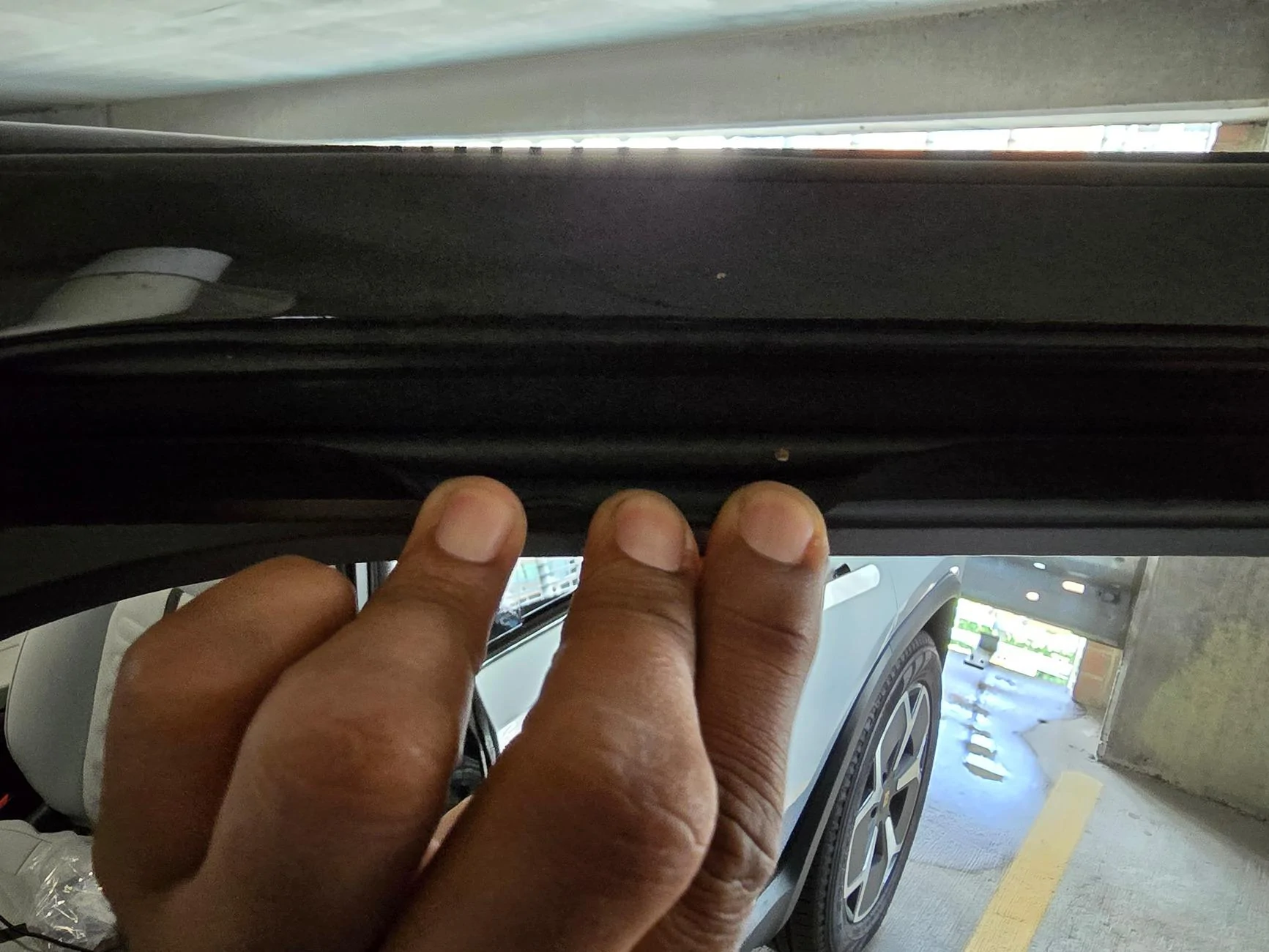

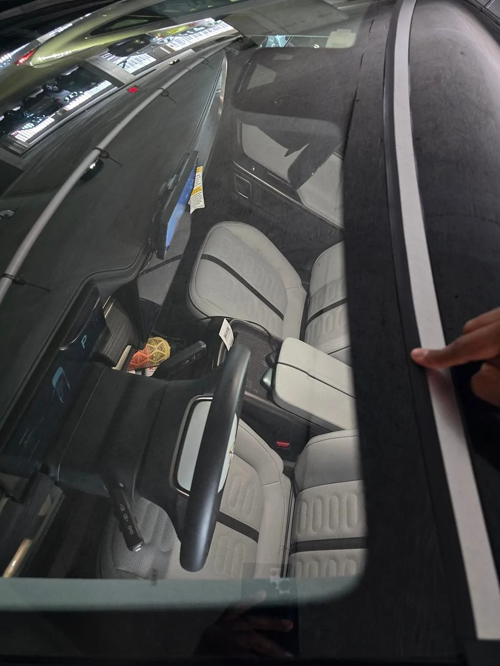

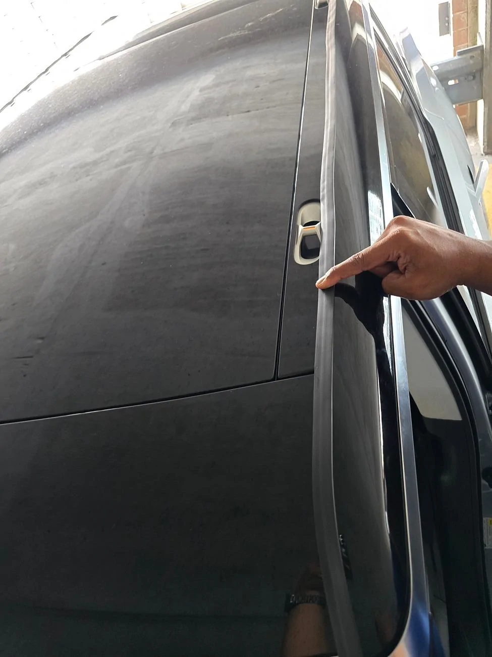

Here are some pictures. I have basically now no noise unless going above 75mph consistently. Even at that, it is primarily road noise from wheels. I have added dynamat under both front door mats (driver and passenger front side only) - forgot to take a picture of.
For the windshield, I added both uxcell rubber seal AND the double adhesive tape on top of it.
I also added little dynamat patch right near the air conditioner compressor and it feels (to me, at least) the noise has already reduced significantly. I forgot to take pictures of that, but it is right next to the air filter area.
The other area I added dynamat is under the front hood. It maybe overkill though.
Road noise reduction via wheel wells is definitely still something I would like to do. I'm looking into how to remove liners in the wheel wells. Never did that before, so will try to go slow when I do it. And yes, will share pictures If I do it.
One other area I covered was the area in the dash where the leather connects to the plastic speaker shaped area. I used uxcell 4mm seal there as well. I will get a picture this afternoon and add it.

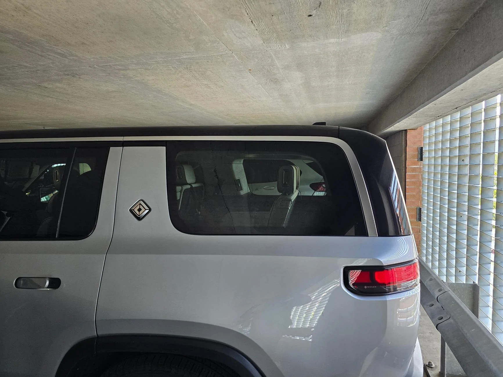

- 4mm x 10m for under and sides of the third row windows.
- 6mm x 8m (maybe 2x) for all other windows, windshield etc etc

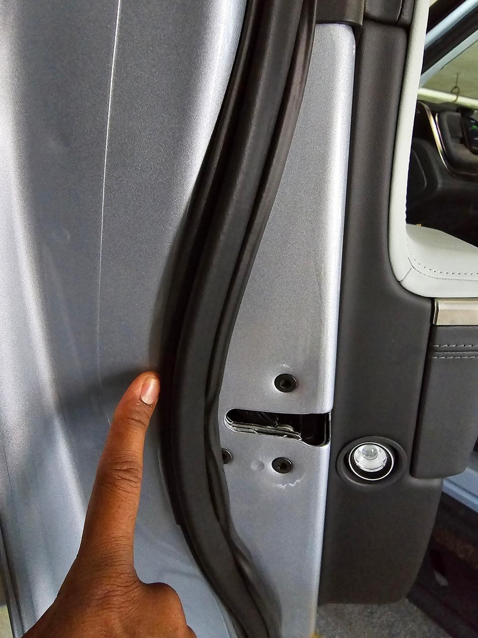

@ne0phyte @akc5247 For the door frame fix, how important is it to get the L-shaped weather stripping behind the existing seal? I’m asking because, even with trim tools, I can’t manage to get the L-shaped seal behind the existing seal in several spots.
You mentioned the goal is to puff up the existing seal, so could 2-3mm uxcell tubing work instead? That would be easier for me to get behind the existing seal.
If there’s an advantage to adding a new weather seal adjacent to the existing one, I might just go that route without trying to puff up the original seal.

If you can get the adhesive seal added to the inside and outside door frames, that would be enough to suppress majority of the noise.
Also, i would suggest you to do a drive on your usual roads that you take and see how much the difference in noise levels are. If they are significantly better, i would just call it a day.
As we have mentioned, this is like a black hole.. the more you keep going, the more you can find and can keep going further...

I agree with @akc5247. you can definitely try different size seals or tubes to see what works for you.
but the big picture is calling it quits once things are pretty good. it is absolutely a rabbit hole where you keep trying to improve things "just a little bit more" but it has very diminishing returns.
at the end of the day this is a gen1 car, and some design deficiencies we cannot make up for despite all the rubber seals in the world.
good luck with your own experimentation and remember to enjoy the car, and don't get sucked into listening for wind noise on every drive haha

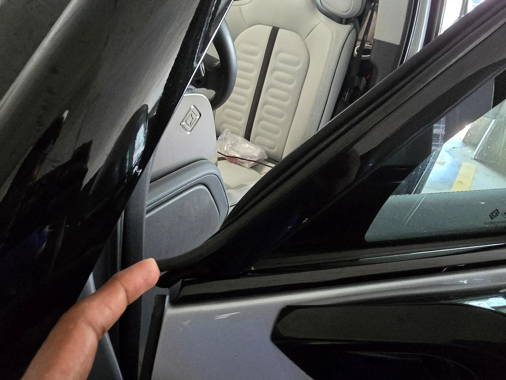

Hi guys, I've been reading these forums for advice and tips on troubleshooting wind noise, and I have come up with a DIY fix that works really well!
First off, I would like to thank Hamdan's post for getting me started:
https://www.rivianforums.com/forum/threads/wind-noise-solved-at-last-using-tube-rubber-seal.17797/
I would definitely read through what he's done as my fix is somewhat based on that
However, I will try to make a more concise guide here with pictures to help streamline the process.
FYI, I have a 2024 R1S build/VIN.

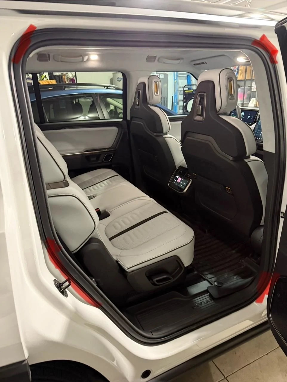

Part 1: Figure out what kind of wind noise you have
-If you have very obvious wind noise coming from one spot (most likely the seal from the A pillar window), then Rivian Service can actually replace that seal and fix it
-However, if it's the more general "the car just seems loud at highway speeds", then Rivian Service will say "it's within spec", and leave you frustrated. I, like many others, have taken my car in for wind noise only for them to tell me that. If this is the type of wind noise that you have, then we can move on to our DIY fix
Part 2: The Fix
From my extensive testing using painter's tape to seal areas, I've found 3 common areas that seem to really help remove the wind noise.
They are:
1. The door frame seal (on car frame, and on door),
2. The seal around the edge of the door

Amazon Parts:
Door Frame Seal (buy 2):
https://www.amazon.com/dp/B07H89G7D1?ref=ppx_yo2ov_dt_b_product_details&th=1
Car Weather Stripping,Universal Self Adhesive Auto Door Rubber Draft Seal Strip,Car Window Door Engine Cover Noise Insulation(47/100 Inch Wide X 2/5 Inch Thick X 33 Feet Long)
Door Edge Seal and Inside Window Seals (buy 2):
https://www.amazon.com/dp/B00NL4D2T8?ref=ppx_yo2ov_dt_b_product_details&th=1
Trim-LOK Rubber Cord Seal for Gun and Pistol Cases, Tackle Boxes, Cooler Lids, Replacement O-Ring Watertight Weatherstripping Seal - 0.25
***7/23/2024 update***
reading users' posts, the 0.25 trimlok may be too small or too big (as the tolerances aren't that great, hence the windnoise).
uxcell on amazon makes round seals in a lot of sizes, so you can try different sizes that work for you:
https://a.co/d/8pu2ZiH

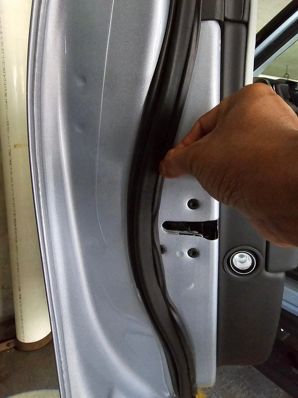

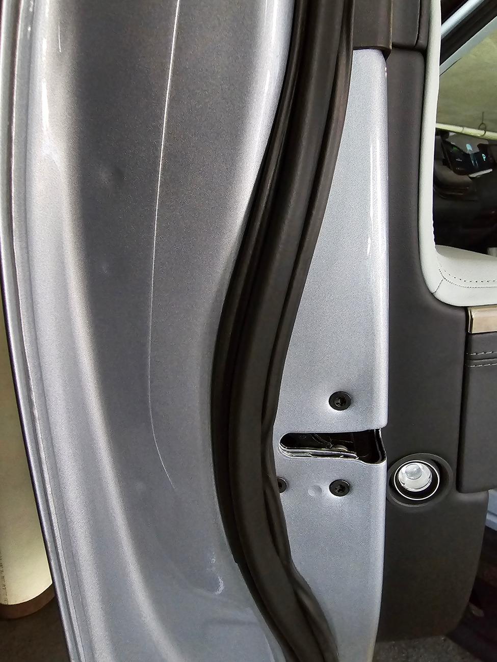

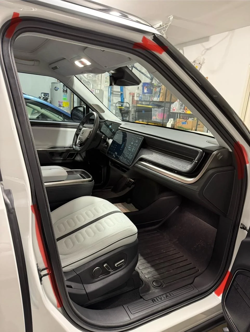

Door Frame Fix
For the door frame, I used the L shaped weather stripping and placed it around the existing seal on the car frame, and behind the existing seal on the door itself. The idea is basically to puff up the existing seal on the door, and to give more rubber surface area on the door frame to make a tighter seal
Doing this helped make the car quieter, but the buffeting kind of wind noise was still apparent at highway speeds. The rubber can be inserted around the existing seal quite snugly. I was able to make it look pretty good, with only minimal adhesive use. You do not need to buy adhesive, the seal comes with an adhesive back arleady. I used one solid piece all the way around the door and put the ends towards the front bottom of the door, so you really can't see any gaps.
Outer Door Seal Fix
The leading front edge and top of each door also has a rubber seal. However, due to the door tolerances not being great, I think a lot of wind noise slips in here, especially at highway speeds. I would recommend placing a continuous Trim-Lok cord seal along the entire seal. FYI, it does shrink a little bit in the sun, so I would cut the piece a little long initially.

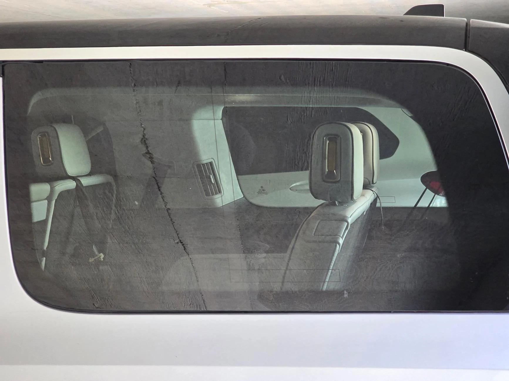

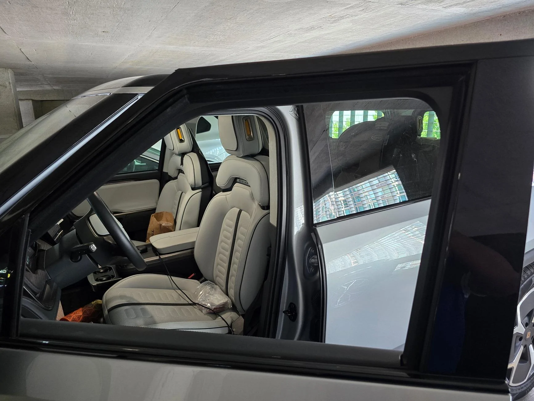

Inside Window Fix
After adding rubber seals to the door frame and outer door seals, I would say my wind noise went from a B- to a B+. However, I would still get some buffeting noise at high speeds. To put it in terms of numbers, I used to hear significant wind noise above 60mph. After the Door Frame Fix and Outer Door Seal Fix, I would hear wind noise around 75mph (quieter, but still noticeable).
My windows do close all the way (this was verified by Rivian Service), but listening carefully, I could still hear wind noise coming through the window. Once I rolled down the window, I saw the same type of seal as on the outer door seal. There are two layers, but again - I guess the manufacturing tolerances aren't great yet, and I don't think the seal is making a tight contact with the window glass.
I also placed a continuous Trim-Lok cord seal along the entire path, and one for each track inside the window. I used a guitar pick (or you can cut a plastic strip from an old credit card) to pry the seal more open to stick the Trim-Lok underneath it. I verified that the windows roll up and down without any interference
Seal Locations:
Pry these open a bit to insert the trim-lok cord seal:

Rear Doors
Do the same as the front doors, with the seals around the frame, and behind the door seal. I also put the trim-lok round seals inside the window seal. My car was quiet after doing the fronts, but I could hear some faint wind noise coming from behind me. Putting these in pretty much eliminated that.

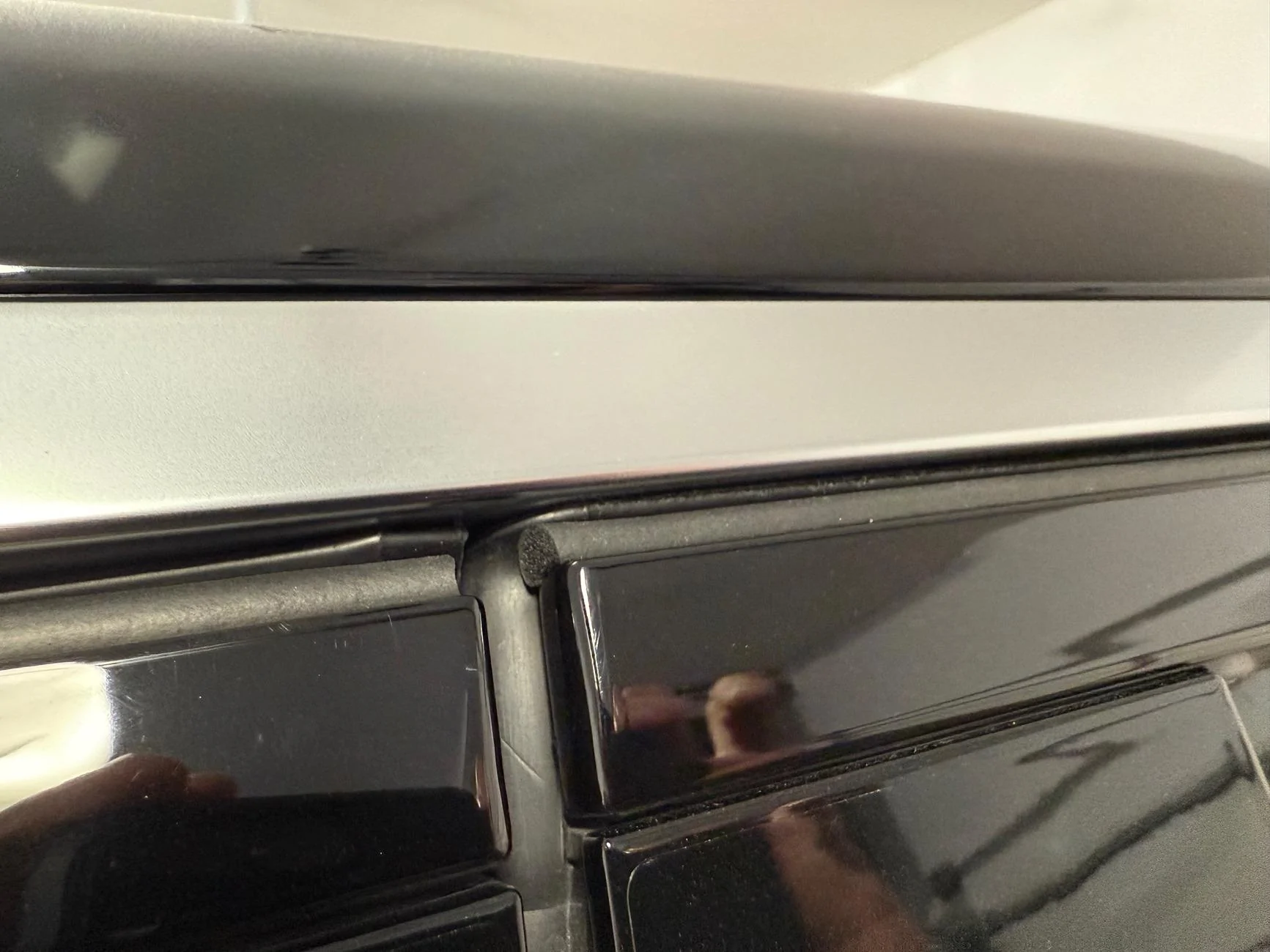

Windshield/Roof:
The only windnoise that was left was some mild noise coming from above me. I thought it was the roof, so i taped it up, but it did nothing for me. Still, some people have success, so where you can try to seal it is where the applique meets the glass moonroof. The applique should sit a little higher than the moonroof (so that it blocks the wind). If it does, sealing it or taping it up really won't do anything.
Use a 0.25inch trim-lok to wedge in the gap, or you can buy this :
https://www.amazon.com/gp/product/B0BYSNVCFS
and use the 14mm "T" shaped seal to bridge that gap

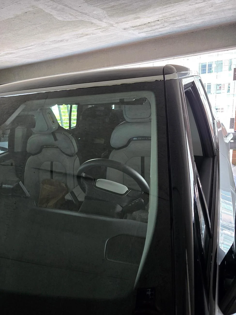

What did help get rid of the wind noise above me was actually the windshield. I think the grooves along the windshield funnel the wind up to the top, where it is catching and causing some noise.
What helped for me, was the vertical sides of the windshield. On the BMW, there is no groove between the car frame and the windshield, but there's a trench on each side with the Rivian. I bought this uxcell 8mm (0.31inch) round seal, that wedged perfectly into that groove.
https://www.amazon.com/uxcell-Rubber-Weather-Diameter-Meters/dp/B07ZNH29FH/
you can see how it fits nicely along the windshield groove and then I have to wedge it in at the top of the roof (see above picture)
you can snug in the round seal at the bottom of the windshield

1. L-weatherstrip around the innermost front and rear door openings on the car body. I didn't do the outermost seals on the door frames themselves. I only needed 2 kits (1 kit will do 2 doors) that neophyte suggested. At the red marked areas, I used the included 1/8" adhesive strips to better tack down the added weatherstrip seals to the car (this secures the weatherstrip from coming off around the curves and on the long exposed stretches). During install, I put little to no tension on the L-weatherstrip so it was less likely to peel off. The EPDM should last for the life of the car.
2. Exterior door frame seals (around the top of the doors). I used the 6mm EPDM round foam as suggested. Just cut and place.
I should have done a before and after Sound Meter app measurements but definitely noticeable improvement in doing these 2 things--I can hear my passengers a bit more clearer and not have to talk as loud.
I haven't filled in the front windshield/A-pillar side exterior gaps yet and I'm sure that's a cause of wind buffeting that I hear above 75mph. However, I'm quite happy how much quieter the car already is with just these 2 minor fixes.
Rivian R1T R1S Guide: R1S / R1T Wind Noise FIX! IMG_0646
Thank you, boise_mountain_biker! This makes a lot of sense.
Can you please post some pictures of the L-weatherstrip installed around the innermost door openings?
