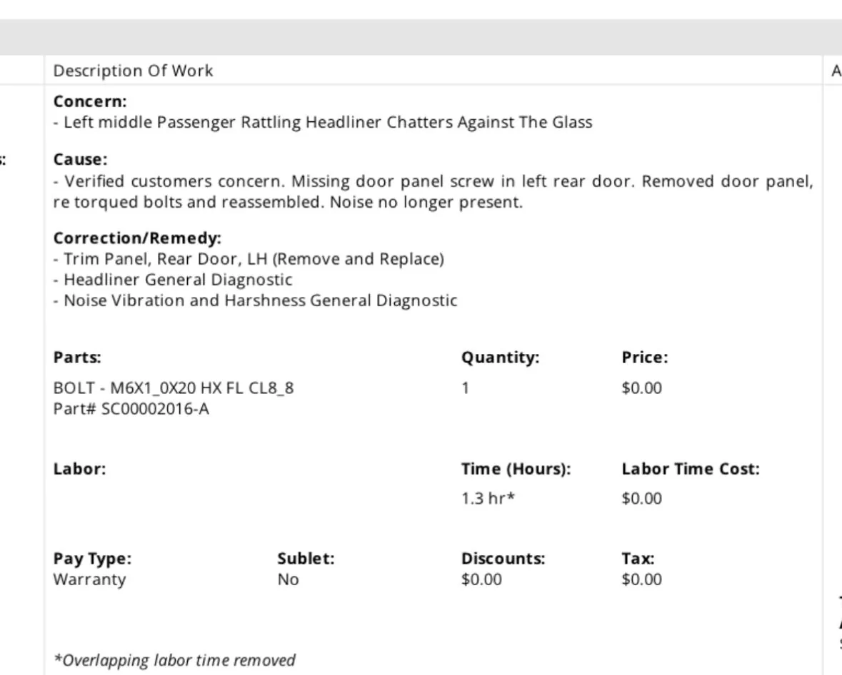

I just had a similar (the same?) rattle fixed. I thought it was the headliner chattering against the glass but is was the middle row left side passenger door. Something inside the door was rattling. Took an entire day at a service center but they did somehow fix it. They thought it might require a new door or trip to an auto body shop to take the door apart. Praying it doesn't come back because the rattle made the car undrivable. Its all i could hear.

Just watched the video of your sound and that’s exactly the rattle I have. Does your service ticket say what they did to resolve? They usually have something that describes a fix in there. ā€œRemove and replaceā€ type of language. Describes the action related to the fix. And what service center did you go to? I can tell my SC where the fix occurred and hopefully they can connect. @Jper123 Thank you for the reply and help!
Rivian R1T R1S Geiger counter rattle sound from B Pillar/rear door. IMG_5248

Alriiiight! Now we’re getting somewhere. I’ll share this with my SC here. What SC location did this fix for you? I’ll let mine know to contact if they have questions. Much appreciated and if this resolves mine, I owe you one!! @Jper123
Happy to help! It was the sc in Chelsea MA
