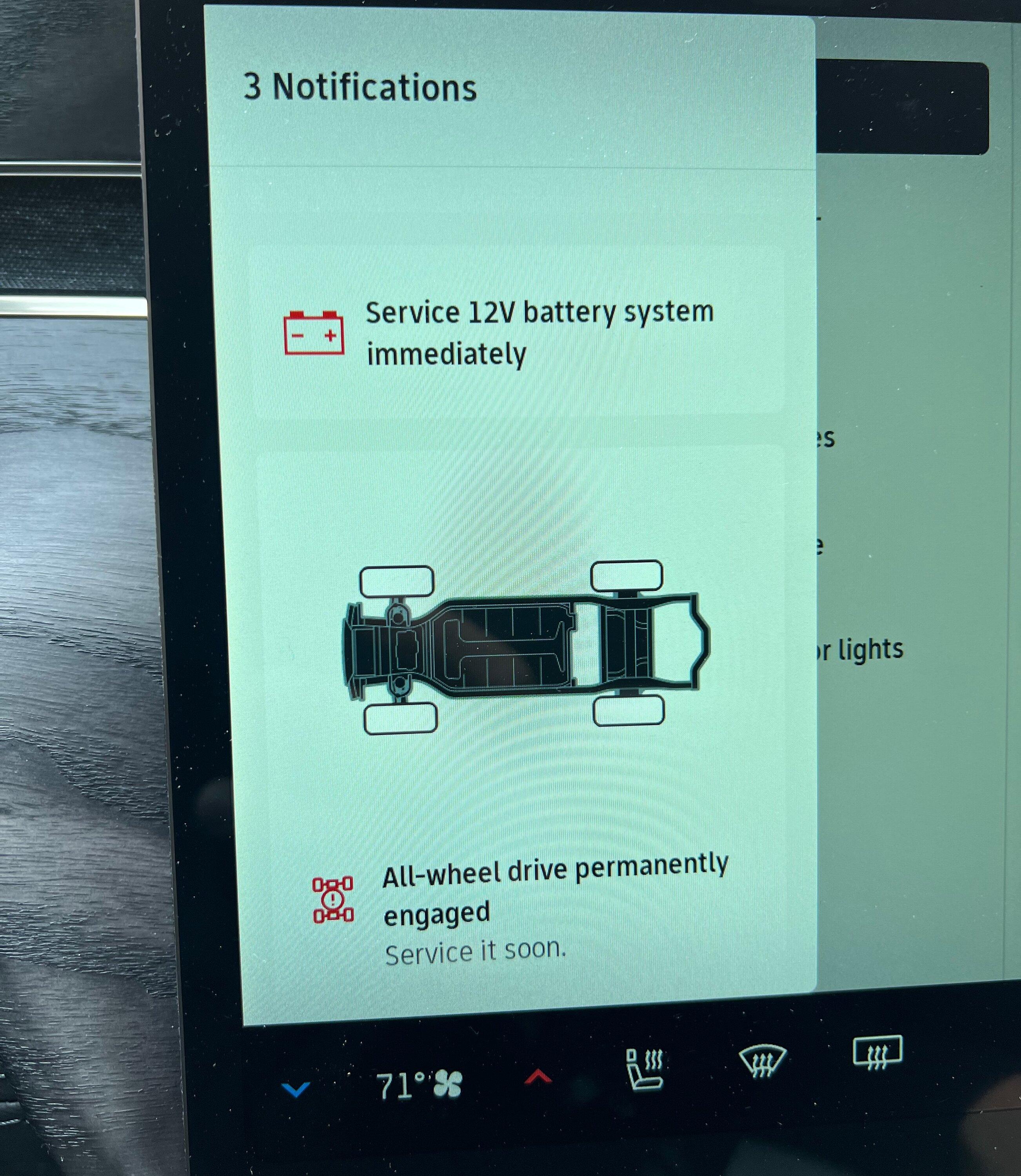

Thank you, sorry to hear about a week of pain for a software glitch. This is actually sounding familiar to what they had diagnosed on mine back in late Jan. At the time I did a reset and went away. AT next SC visit, they told me it was a software bug...
As for the work they did this time, see below. Both 12v replaced, picking it up in Brooklyn tomorrow. Funny as as I have been to Brooklyn 4 times in 6 months vs 0 in the past 10 years :mad:
Concern:- Customer states that his vehicle is unresponsive.
Cause:- vehicle was unresponsive due to vehicle experienced dead 12v, removed 12v batteries &replaced with new battery Due to vehicle having 12V alert concern last service visit.
Approved the one-time goodwill 12V replacement.
Correction/Remedy:- 12V Batteries Other Labor (0.5 hours)
Error message from Jan for reference
