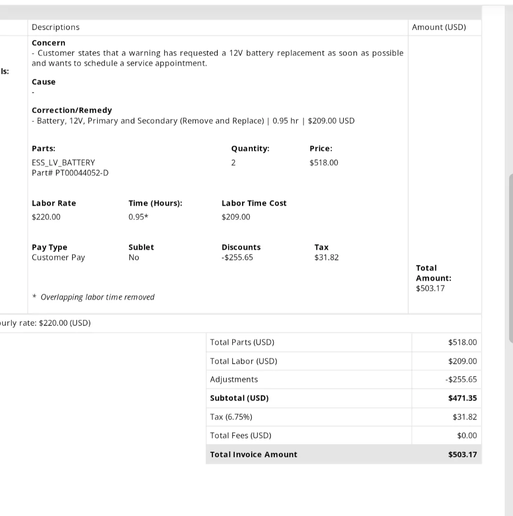

To bump this thread just got my 12v warning ironically a week after being in the service center for routine maintenance/break flush and I'm just out of warranty. There's (at least for now) a bit of a discount either because we're all complaining about it or if it's because I just asked them if I could buy two batteries off them and do it myself. All in $500(250 off).
Rivian R1T R1S 12V Battery Replacement Megathread 1000028245
