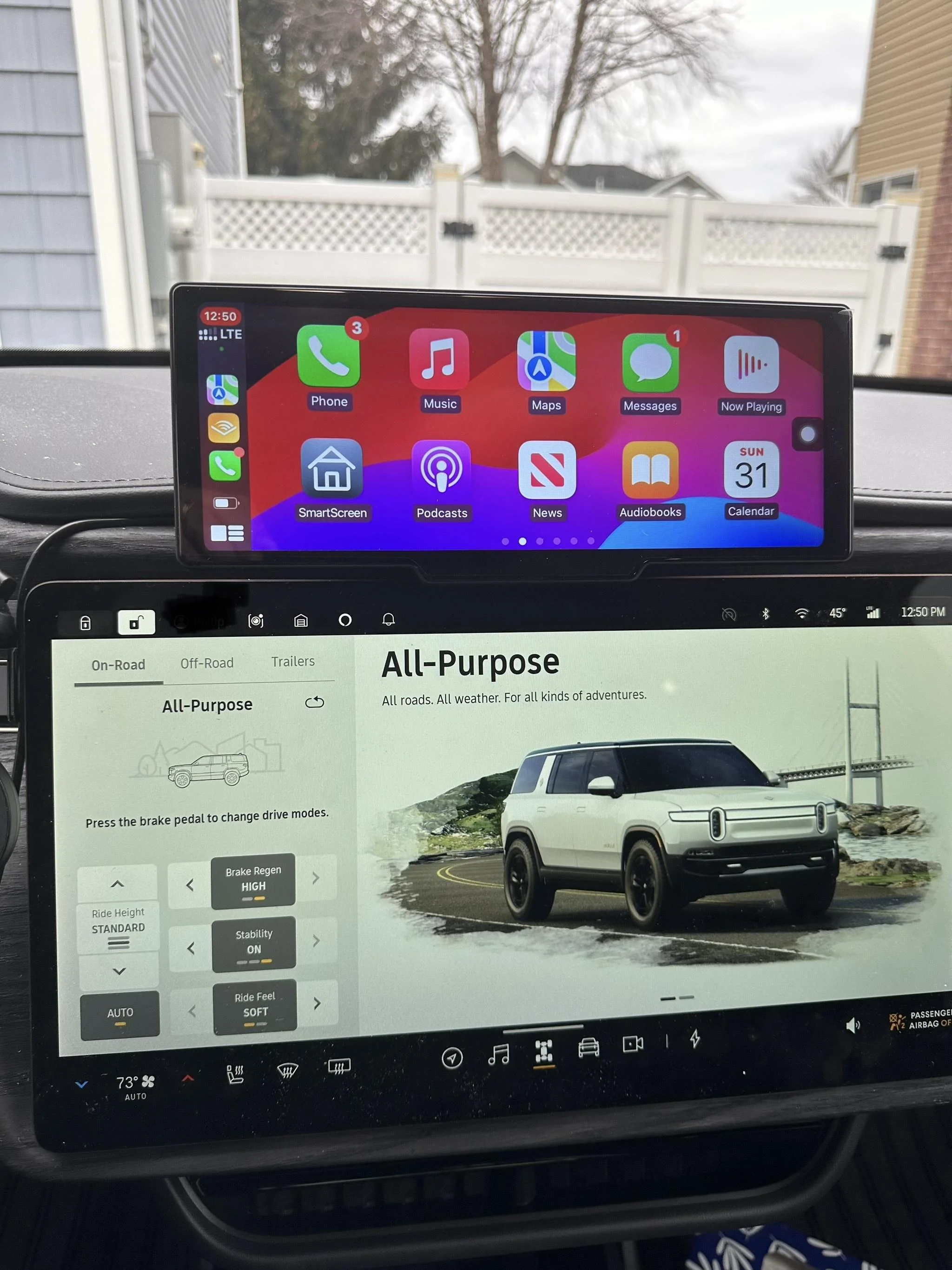

Anyone receive their unit and have an installation report to share?
Rivian R1T R1S Master Thread: JEBINC’s installation tips and review of 1EV / EV Sportline CarPlay / Android Auto display kit IMG_8934

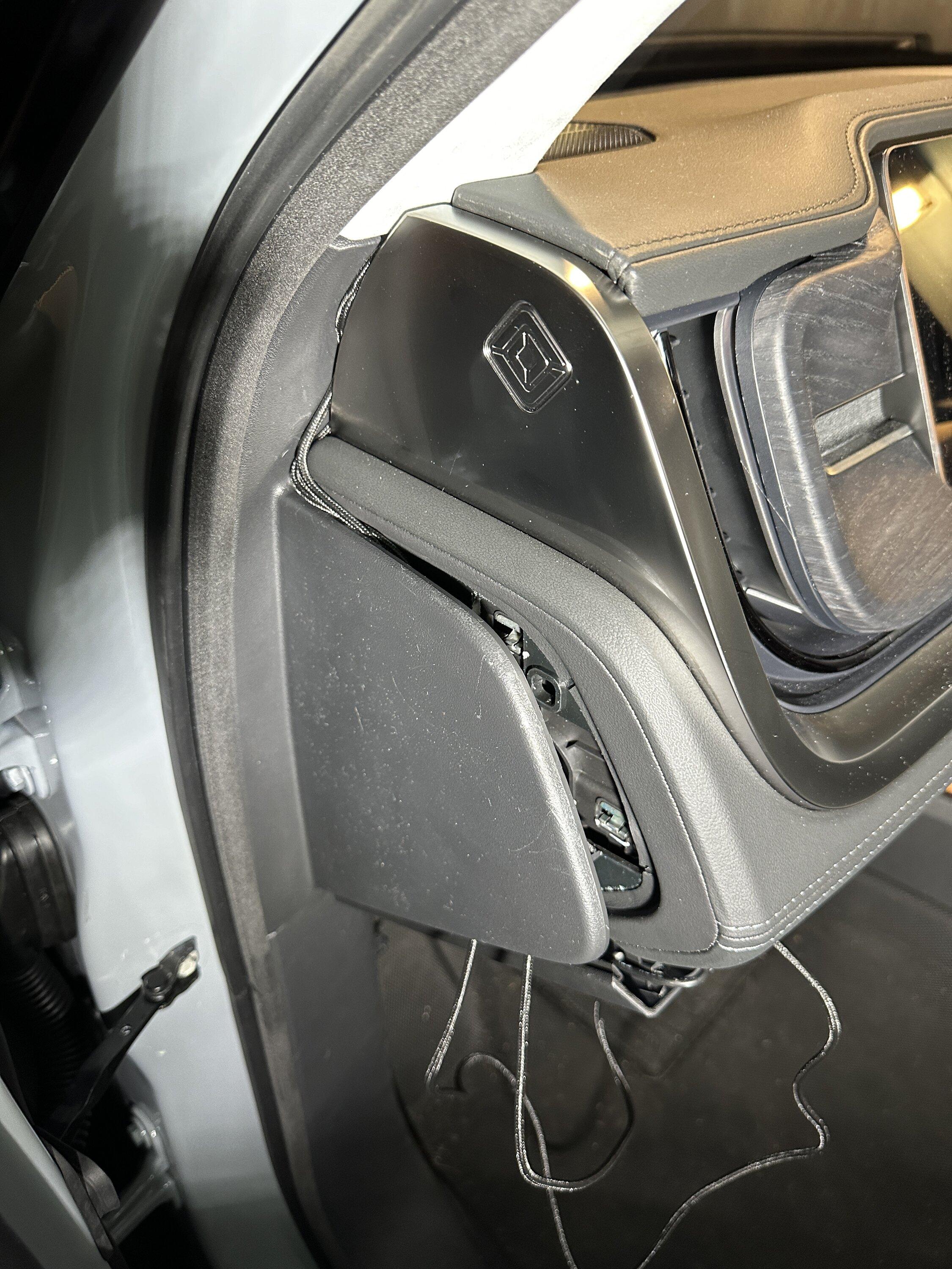

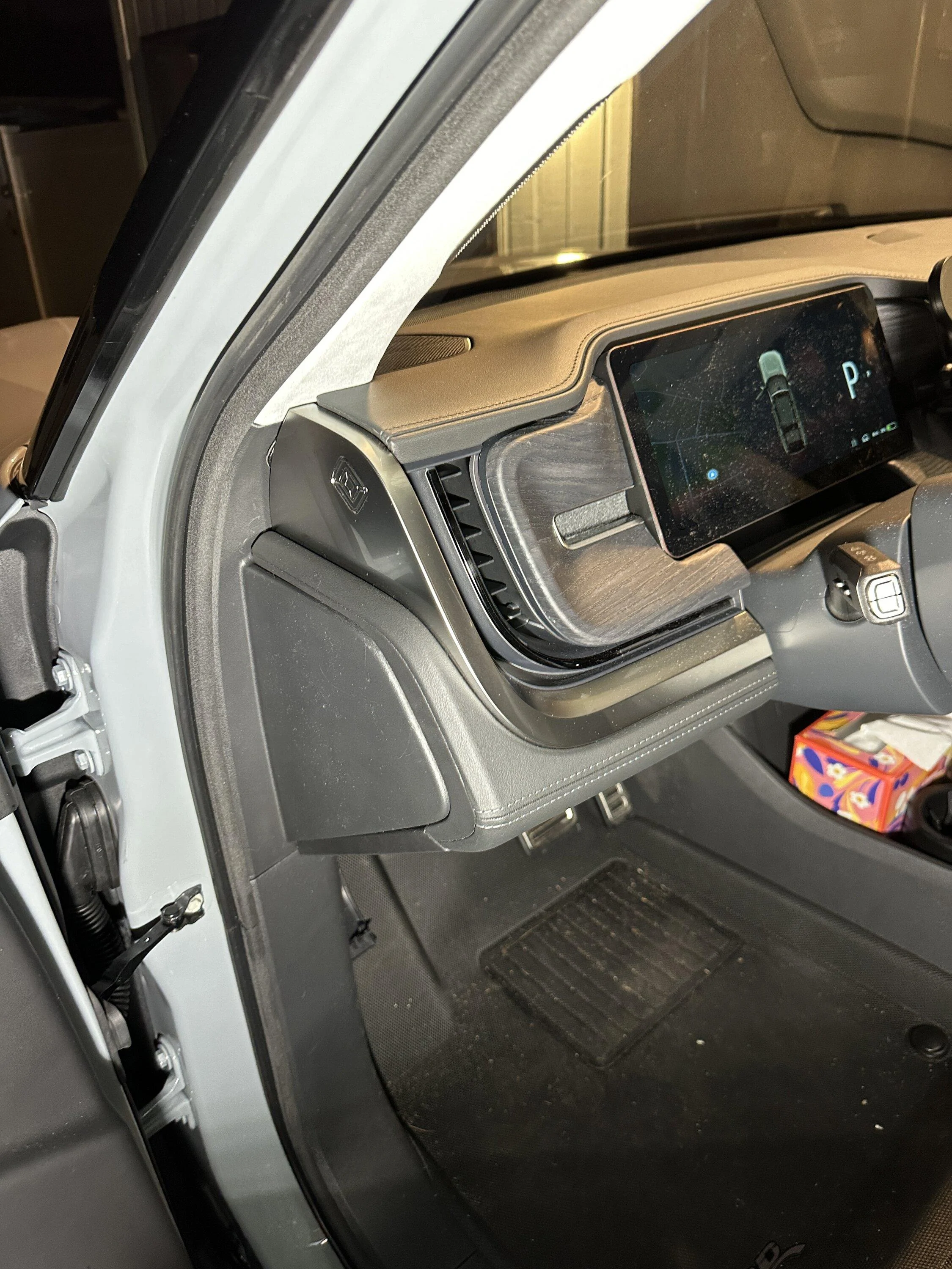

I received mine and hardwired it into my R1S in about an hour. It was relatively easy following @EV Sportline ‘s video. You have to be comfortable contorting yourself a little as mentioned by @jebinc earlier in this thread, but otherwise it’s pretty straightforward. You can hide most, but not all of the wiring in routing it from the fuse panel to the screen; the wires are not completely hidden. I like the fact that you can apple play from the built in speaker or via Bluetooth as well.

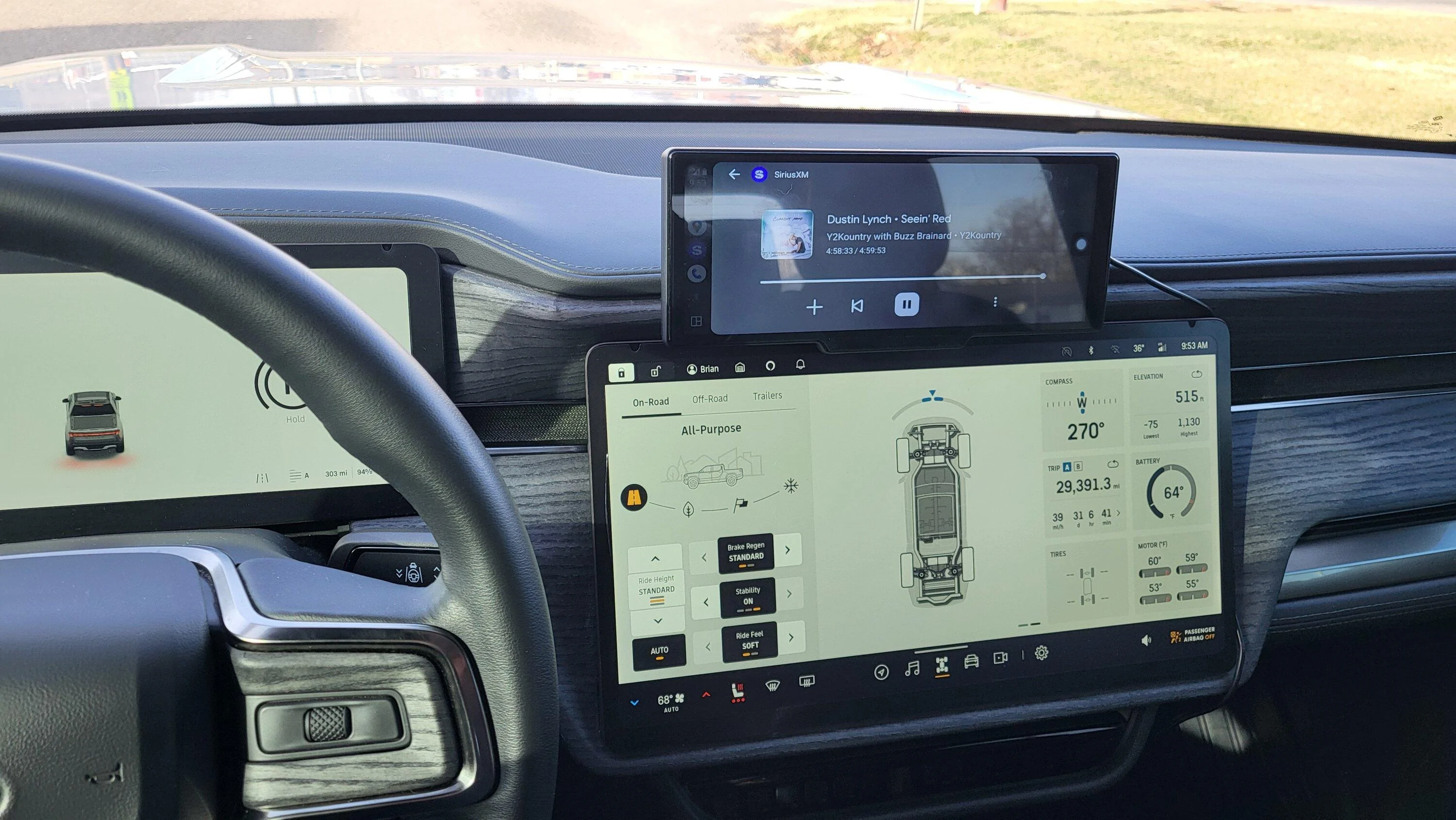

Installed mine on 26th. No issues. Does use up the battery of phone more which is understandable. No dash scratches. 12v would not power unit so did hard wire install. Not 100% sold on it. I use Android auto w Google maps and love my Sirius XM so thats nice. Chargepoint and Plughare work well w AA and the EV sport line unit.
Riv maps and Google routing about the same. I will use both for long trips for charging w Riv maps and traffic concerns w Google.

What are you not sold on? The hard wire vs 12v dash plug?

The price is right. Just may not need it over time as in dash unit improves. Traffic updates makes it worth it alone at this point. I like it don’t get me wrong…just a lot of screens lol

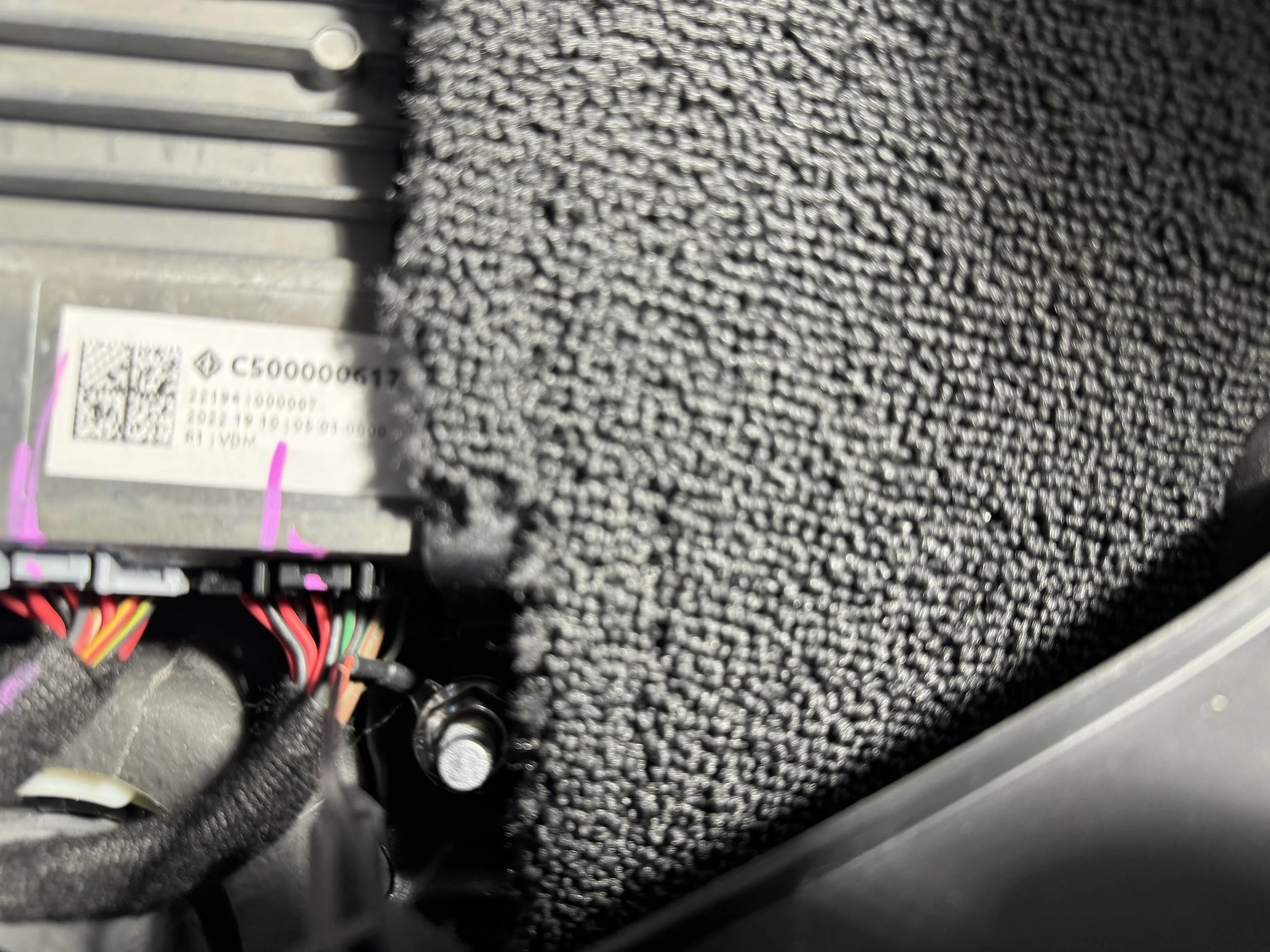

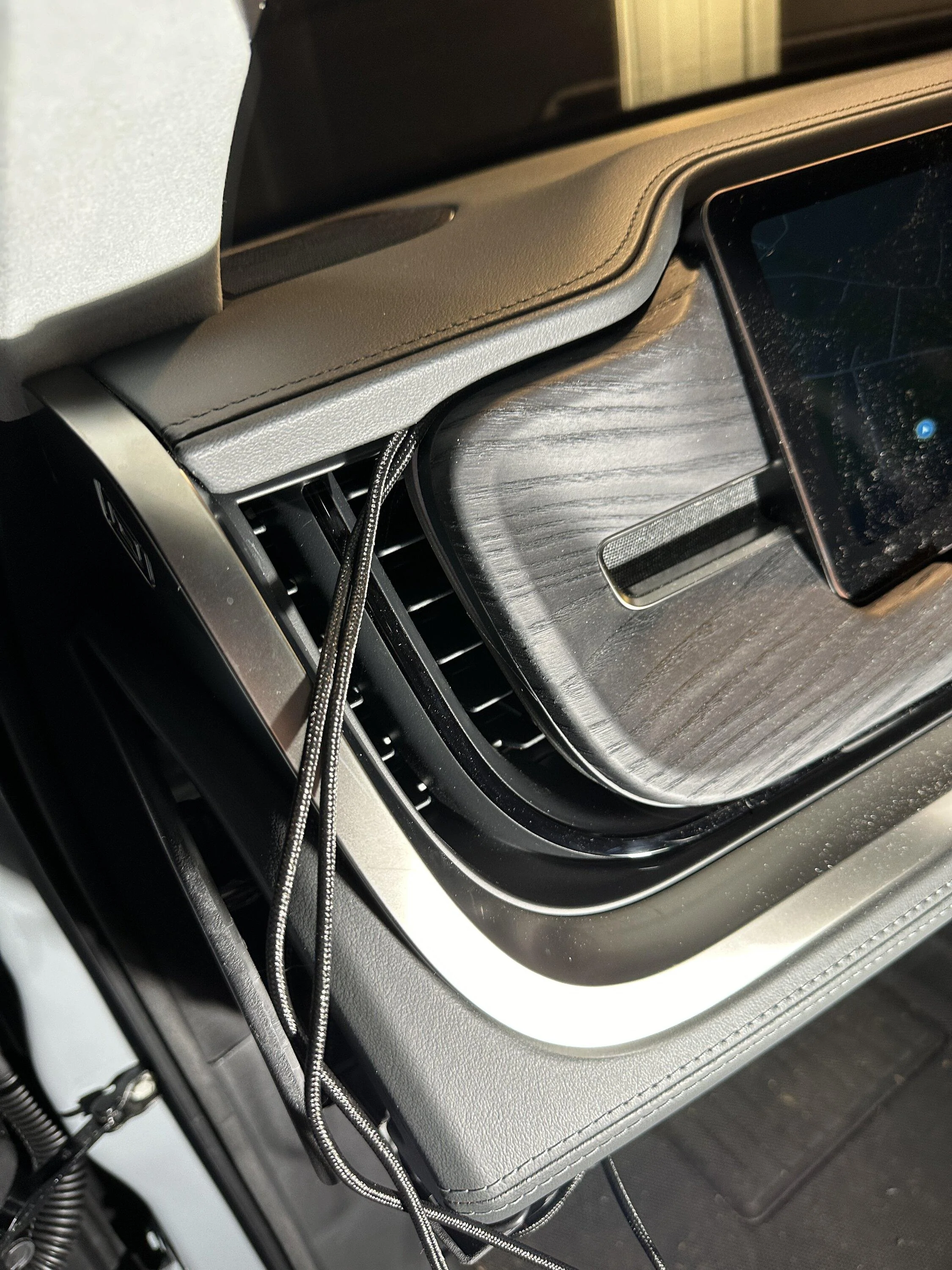

You can hide the wire better if you keep on going to the driver's side door past the speedometer screen and down the left side of the car.

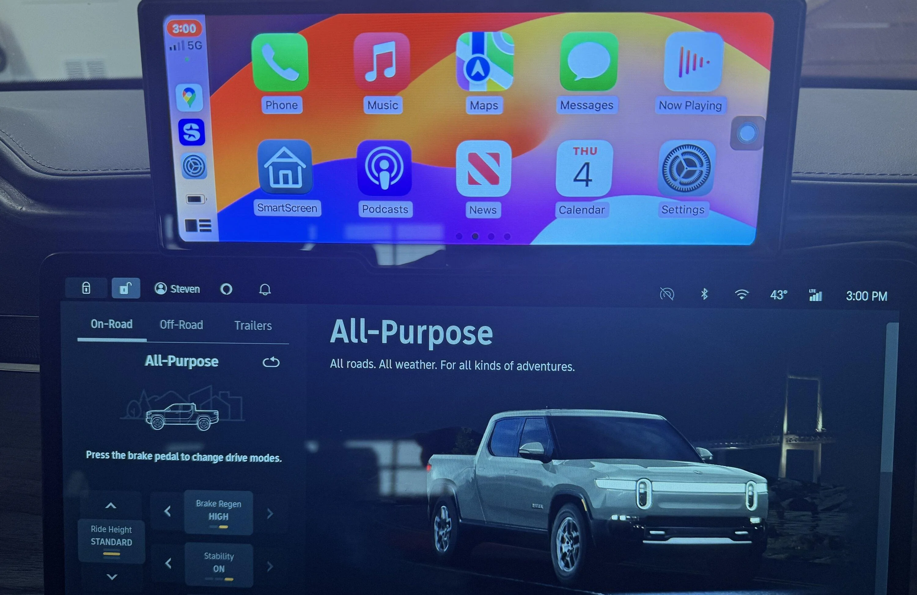

Just installed my CarPlay display and it maybe took 10 minutes very easy for me I am for now using my under dash cigarette adapter which is working fine for me.
as I am an iPhone user this display is a game changer and more importantly a huge safety enhancer. I hope Rivian adds CarPlay support though I’m not holding my breath
