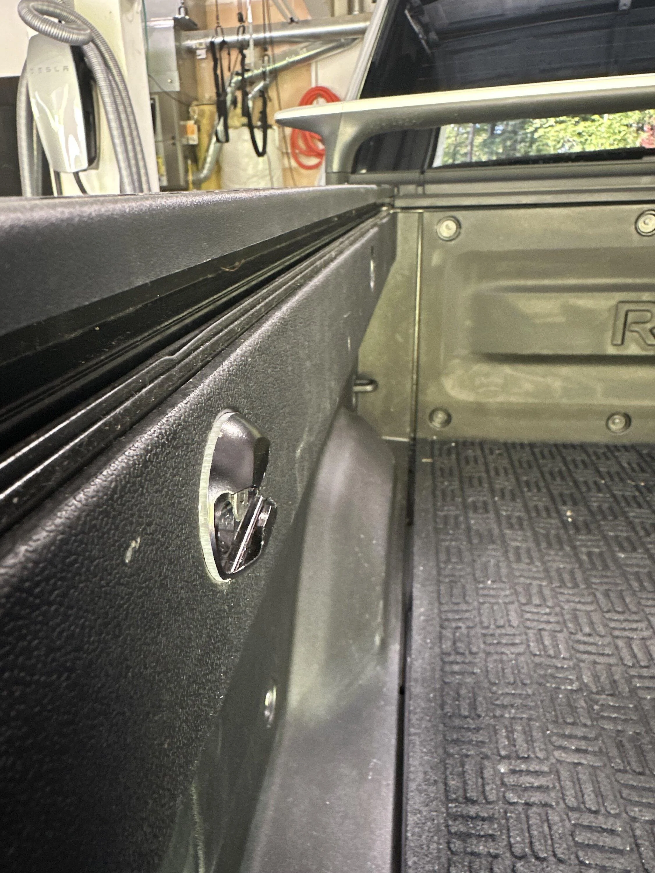

I’ve been too busy modding a cottage and haven’t installed mine. Thanks for the head’s up! I would suggest reaching out to them as they may have received a bad lot, etc. I will test mine in the morning and will report. I can say for certain, the prototype works well. I modified it a bit more since the original OP to make the design even better.

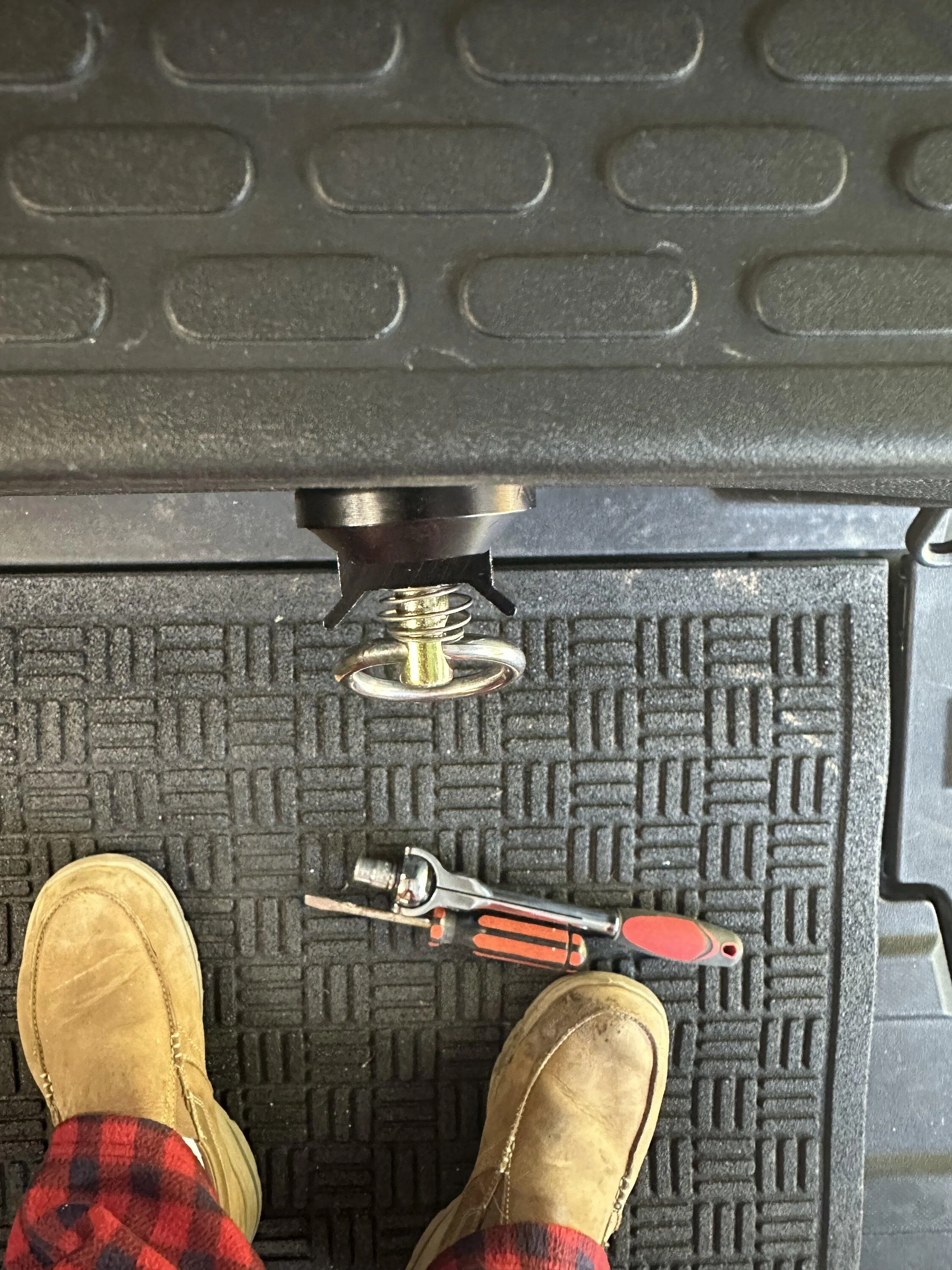

@CommodoreAmiga I test fit one just now, and have the same situation you reported. No comments on my pajama pants, please - it’s early here and your post was on my mind.
I reached out to @EV Sportline on the matter. I’m fairly certain there is a bad lot of parts from the manufacturer getting out, and that @EV Sportline will quickly rectify whatever the issue is - while taking care of us early pioneers who recieved less than ideal parts. I also asked them to comment in this thread, re the issue and next steps.

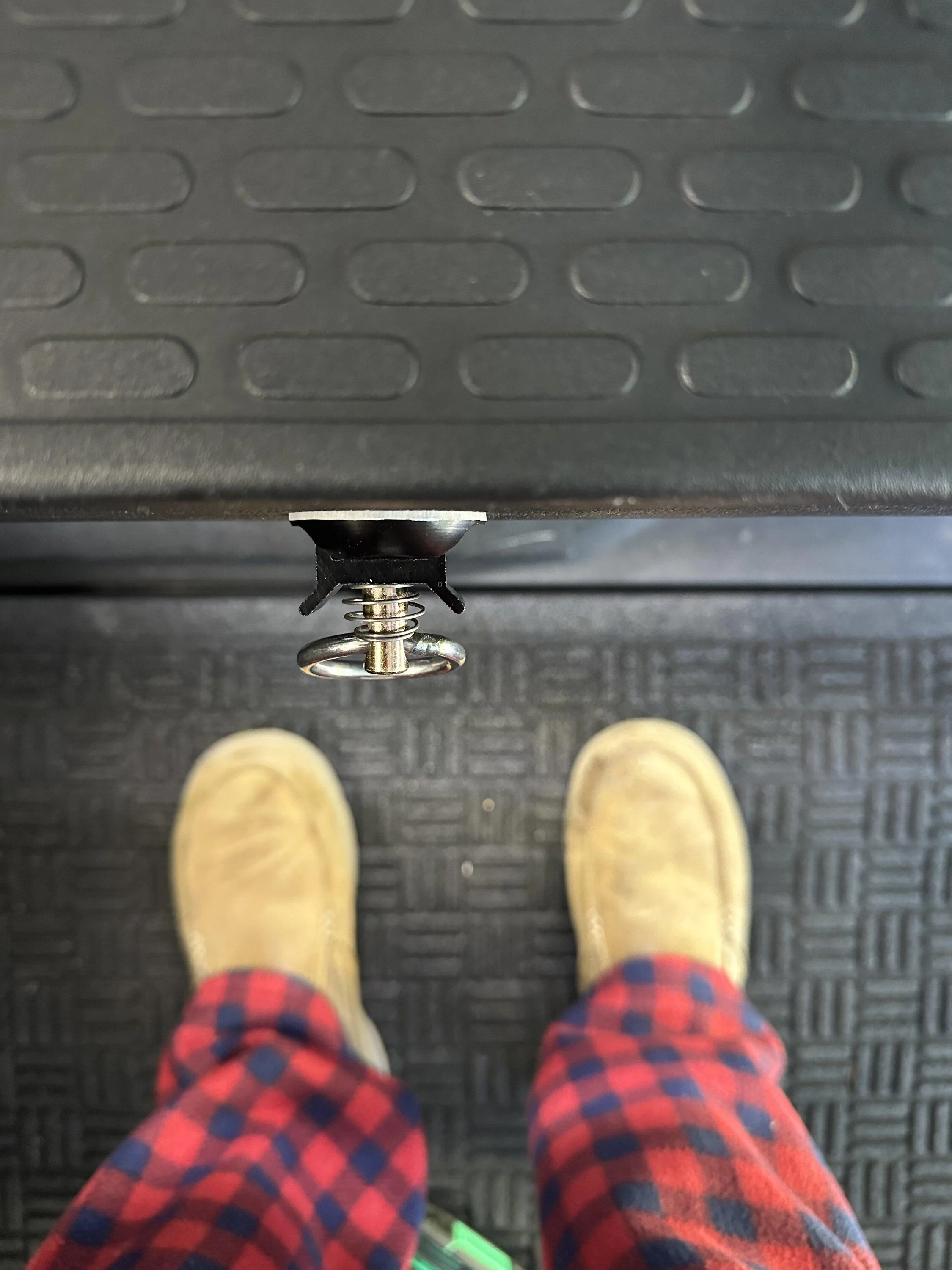

Again, my prototype works wonderfully and is flush and tidy. My experience tells me @EV Sportline will certainly sort and make things right. We must all remember, they took this project on per our request as making custom prototypes, as I did, is not viable for the masses. Hopefully we will hear more in the next day or so.
Rivian R1T R1S JEBINC’s bitchin’ no rails tie downs mod! IMG_7697
My prototype
Thanks. Both for confirmation of the issue and taking point on reaching out to EV Sportline.
I did try rotating the pucks so the long-slot is almost vertical and that let me tighten things to be less askew (still not perfect). With the included ring accessories it technically works since they can rotate freely. But it is not how L-track should normally be oriented, may impact the ability to use other attachments/accessories, and honestly it just doesn't look right, to me.
I'm going to hold off on installing the rest until we hear more about what can be done.

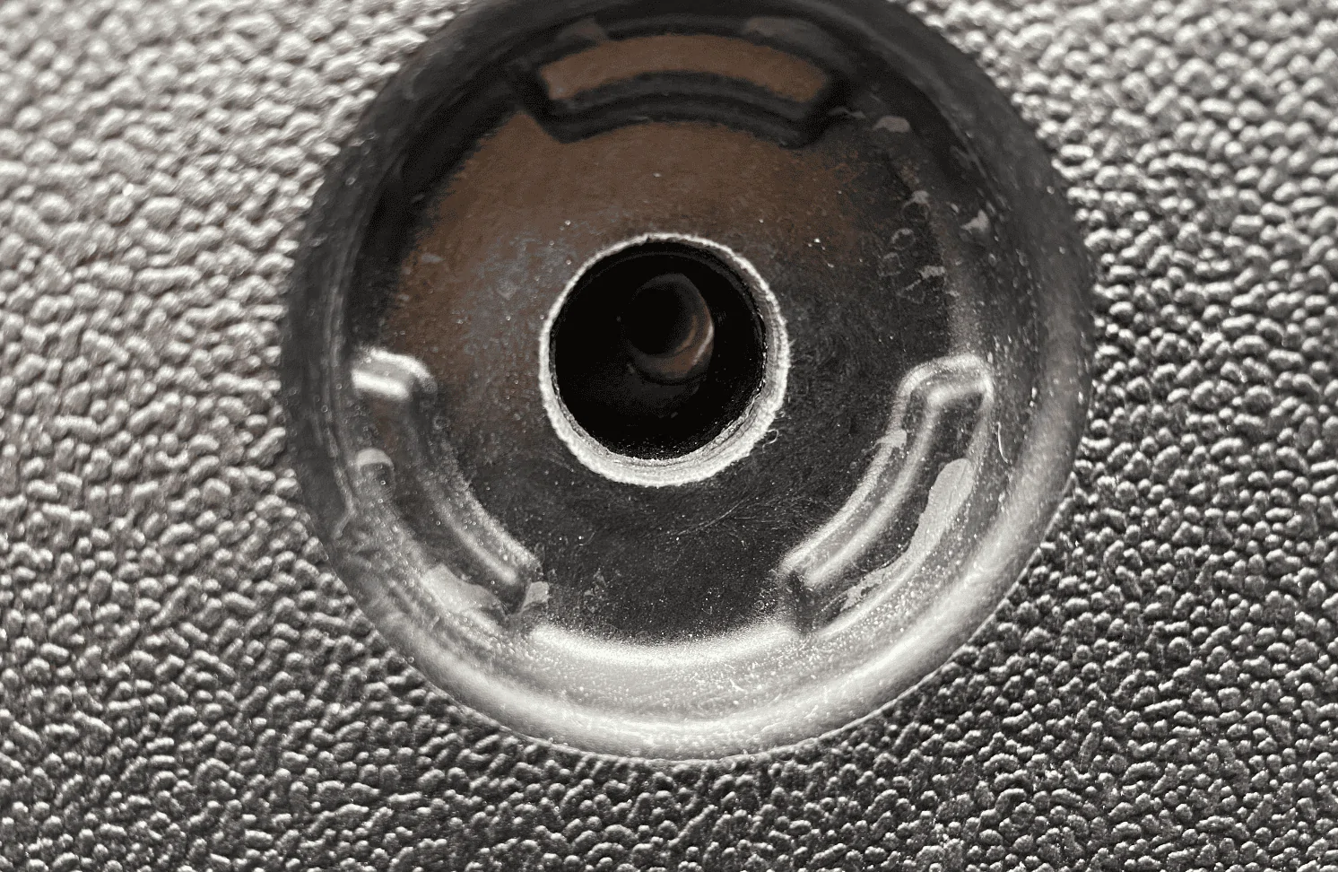

Hey guys, sorry been on vacation - back in action now.
Couple things:

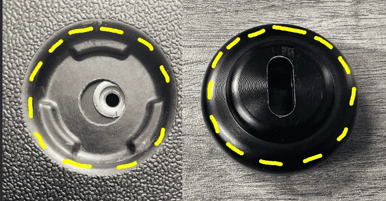

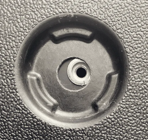

The Rivian bed liner has A LOT of variability / tolerance. We've tested several Rivians over time for our tonneau covers and this product. For example, see how askew the factory well nut is vs the bed liner here...this is very common and varies between each Rivian anchor location:
Rivian R1T R1S JEBINC’s bitchin’ no rails tie downs mod! Screenshot 2023-06-08 at 10.33.13 AM
Secondarily, the depth of the well nut behind the bed liner varies significantly. For example, compare the depth of the well nut vs liner below, vs the photo above:
Rivian R1T R1S JEBINC’s bitchin’ no rails tie downs mod! Screenshot 2023-06-08 at 10.35.02 AM
We designed the product to center itself on the bedliner port outer diameter, so our fitting is always concentric with the port diameter, regardless of Rivian well nut and bedliner variations and tolerance, and still allow for proper bolting-on. The following dashed line shows how we center the fitting:
Rivian R1T R1S JEBINC’s bitchin’ no rails tie downs mod! Screenshot 2023-06-08 at 10.45.50 AM
This design ensures the fitting can always be centered and doesn't bottom out on the well nut and / or never requires 'trimming' the bedliner to access the full well nut surface.
The product can we aligned with the bedliner during install and the bolt tightened once desired alignment is set. The factor 'washer' can be re-used if desired, and can help make alignment easier, but is not absolutely necessary.
Are you saying the intention is that these not be installed level with the horizon, but rather rotated to other angles to try to align the slot with the nut?
this is how they look installed

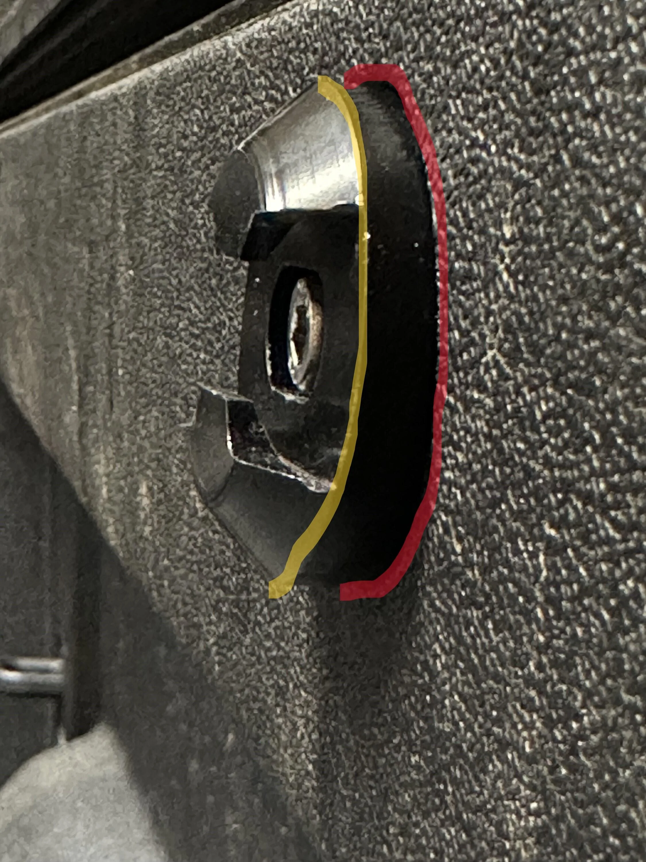

My kit arrived today and I must say I'm not really happy with them. They do not sit flush. Is this consistent with what others are experiencing? If this is how it has to be then I'm inclined to scrap them and go with a more traditional rail that I can mount flat against the bed sides.
for clarification, are you saying you want the yellow edge to be flat with the bed liner (red edge). That was my understanding.

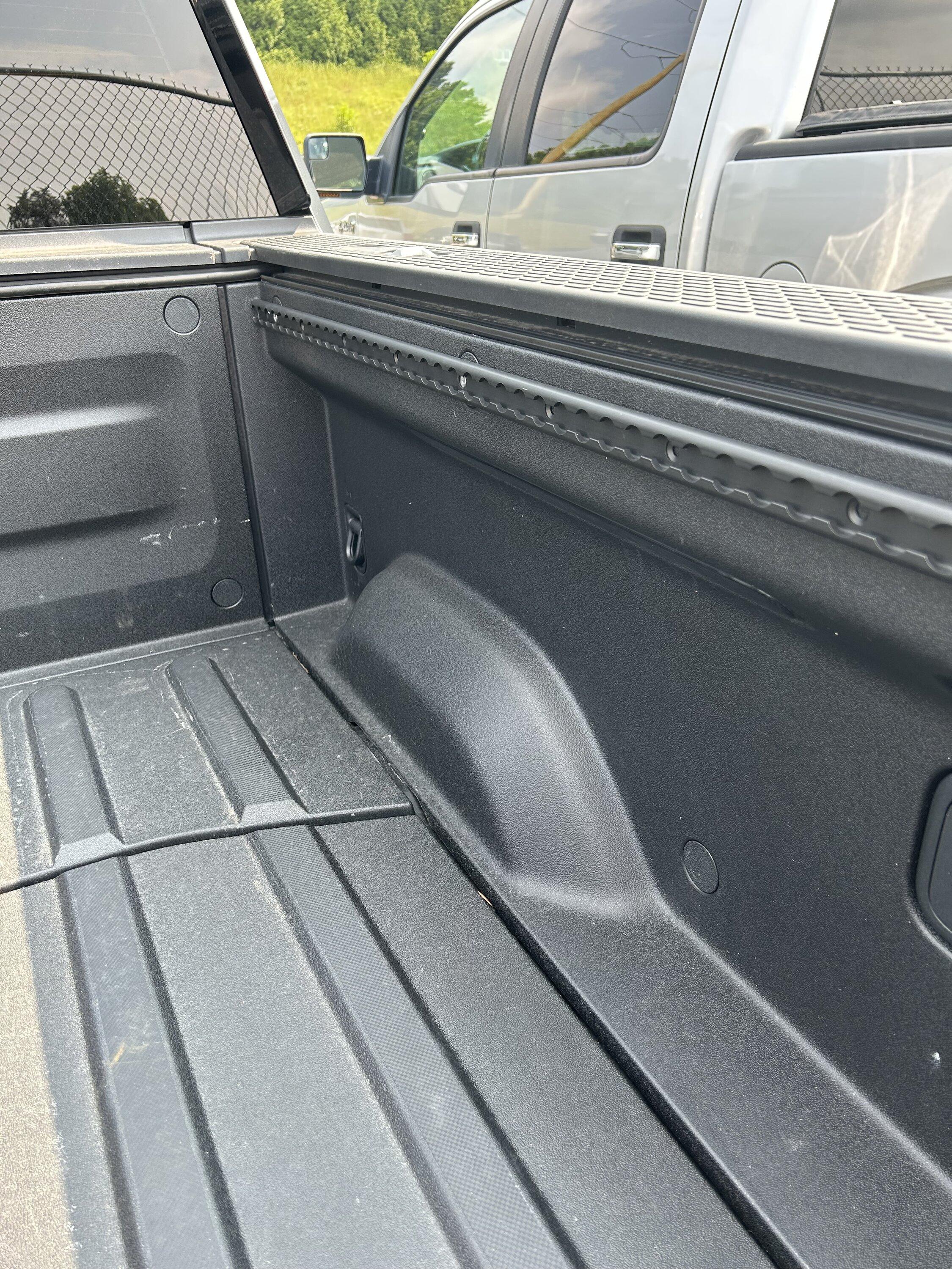

Disappointed these are not sitting more flush. I went with the rails for the top mounts for flexibility and am loving that solution so far, but I was planning on grabbing a set of these to do the lower bolts as well as the front wall.
I at least want the edge to be parallel to the bed sides.

To keep everyone updated:
I removed the pucks and installed the Rivian OE metal cup (3D washer?) behind them. This provides some support behind the puck and does improve alignment. They aren't perfect, but they are much closer to what I want and I can live with them this way.
Re the yellow line, you may be thinking about my “home-made” prototype, which is largely flush at the yellow line. The prototype was made this way to ensure the slide is just a hair above the face of the plastic panel. I reduced the OD of “two hole off the shelf” fitting (you can see the black edge has been turned down). I did some other mods as well, to ensure it secured properly. I could have “sharpied” the exposed edge, but didn’t bother as these were temporary while EV Sportline did their thing.
