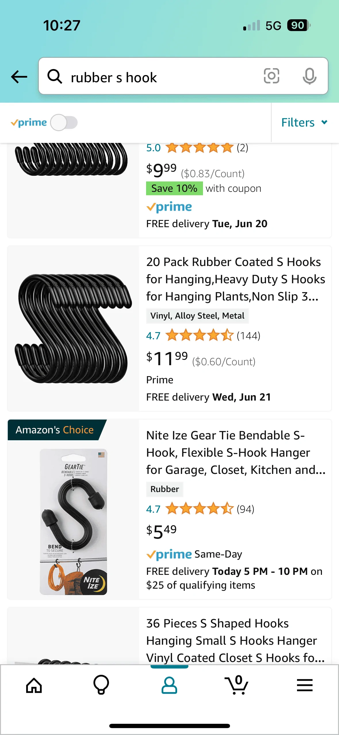

Why not just use a rubberized “S” hook, with the provided loops, for those odd occasions - rather than going through all of this hook rework with @EV Sportline?
Because those hooks are going to get lost or jostled off the rings when not in use. A semi-permanent fixture is preferable.
I would be more likely to use a carabiner rather than a s-hook. Actually, that was my original idea before I found the L-track hook and decided a native implementation was ideal.
I was thinking about pulling out the S hook on those rare occasions, not leave it dangling in the loop.
First world problem, I know... But I like the idea of a hook just being there when I need it and not having to store it somewhere and fish it out when I need it. Just put the bag on the hook and go.
