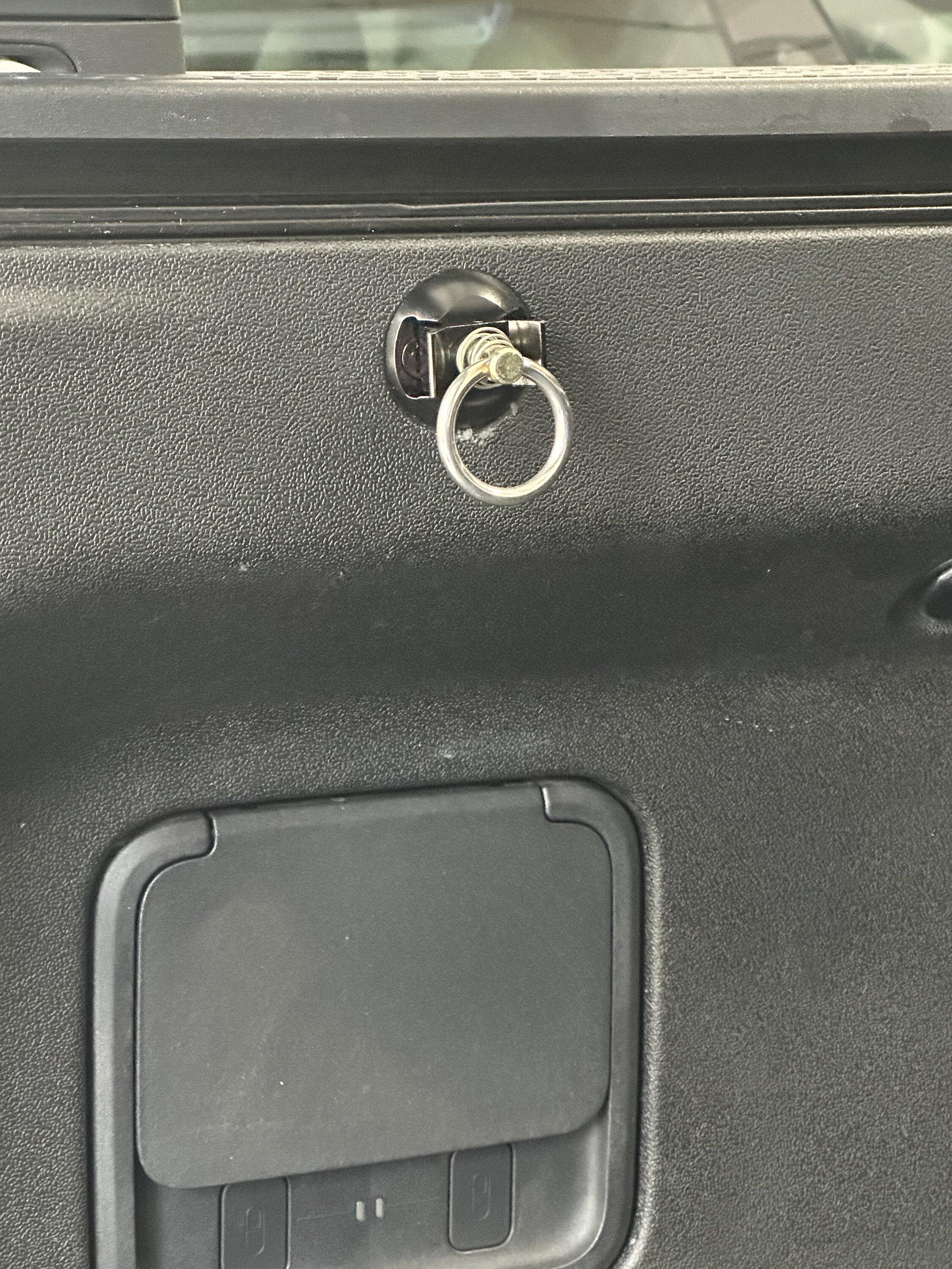

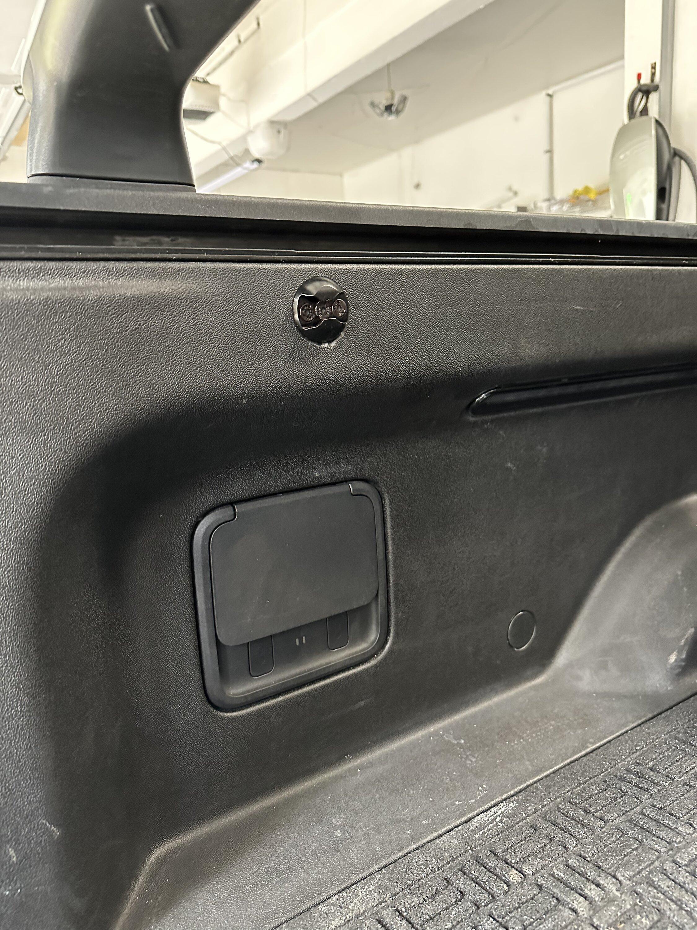

Thank you! Parts used were for prototype purposes, but I like the black anodized finish over black power coat paint, so I plan to keep. Would love to find mounts with one center drilled hole only, so we don’t have to plug the two side holes and drill a new center one. Perhaps an after market company, with access to a source of these mounts, can have these made and kitted? I figure that aftermarket company would;
Sell three kits; 2 mounts (Upper rear of bed), 6 mounts (all upper bed mounts) and 8 mounts (6 kit plus the two lower bed mount locations). Probably a 100% margin play, @EV Sportline.

@jebinc cant get much cleaner and factory-looking than that. Any concerns on strength? I’m assuming not, or you would have mentioned it. I’m thinking more on the vehicle side and the material being screwed into. Looks like a well nut?

@uthatch No concern with RB plate or hardware strength, if fact, the very thin, not water absorbing, flat welting piece between the plate and frame cushions the trend plate while protecting the sharp plate edge from pre mature paint wear- not to mention protecting little one’s knees!

I'm not sure what Rivian intended for these eight mounting points. The Rivian bolts are 6mm (M6) 1m thread (course), so at least a strong as that rating. The welded nut in the bed seems pretty robust as well. My addition of the right length filler bolts, and nuts, provides additional mount stability in that spot. For my every day tie down needs, I have no worries. I wouldn't use these ties downs as recovery points - to pull some poor bastard in a Ford out of the mud! 😆
Having said that, many have mounted 4' L-tracks up top, using only the top three mounts. I poo-pooed that idea for my use. Think about locating a clip-in L-track tie down mid point between where the L track mounts to the bed - then applying a perpendicular load (like across the bed - side to side)... That is the weakest point, and not for me. Having three of these mounts of top (at the bed mount points), instead of L-track, made more sense (to me), and doesn't require a long track on standoffs running the length of your bed. Also, these eight point mounts cost about 1/8 of an equivalent track set up. Make sense, @uthatch?

Looks good, but I don't understand the 'filler bolts'... Are they just to cover the holes in the mount, or do they have a purpose other than that? Did you modify the mount in some way behind?
