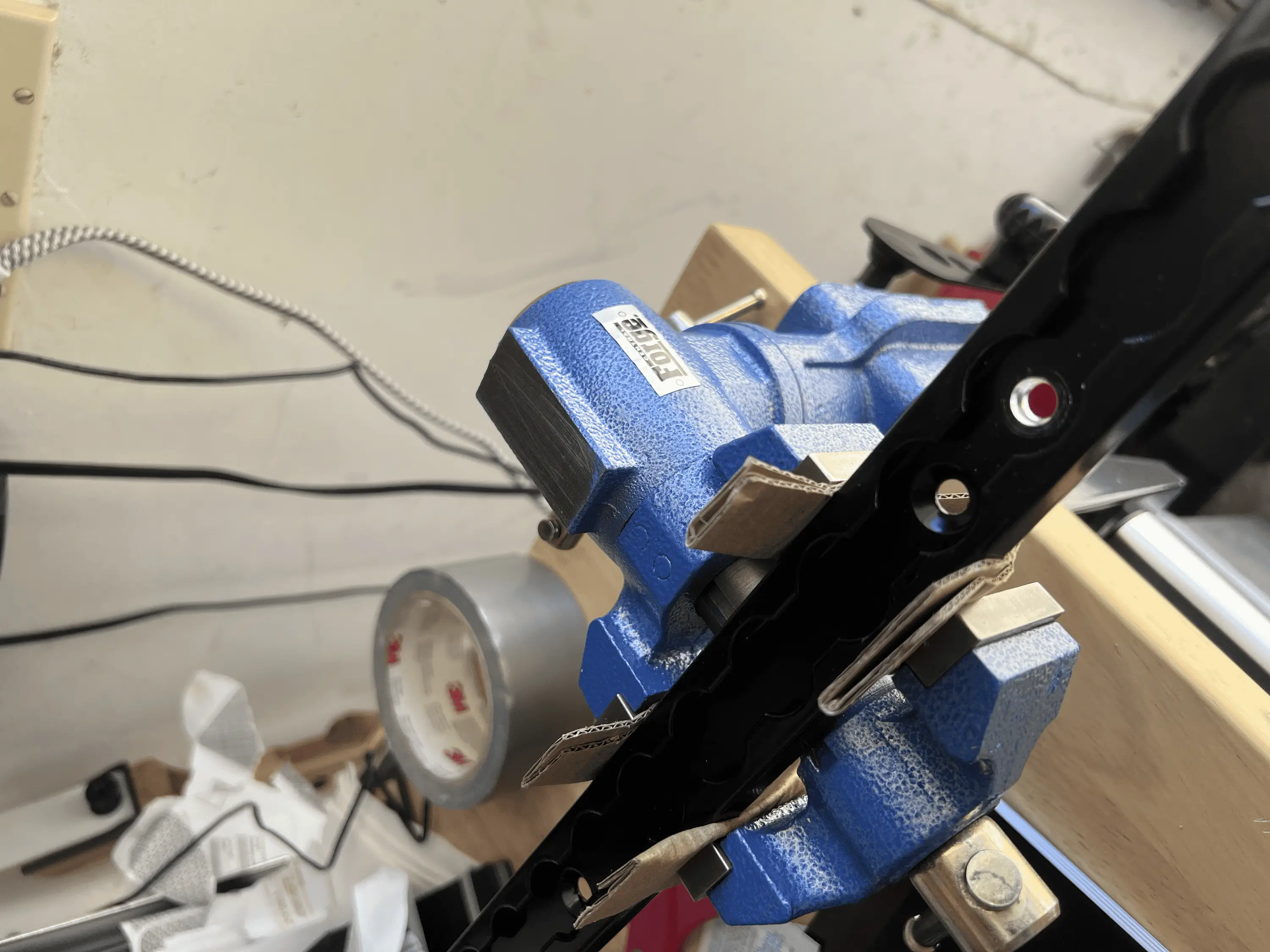

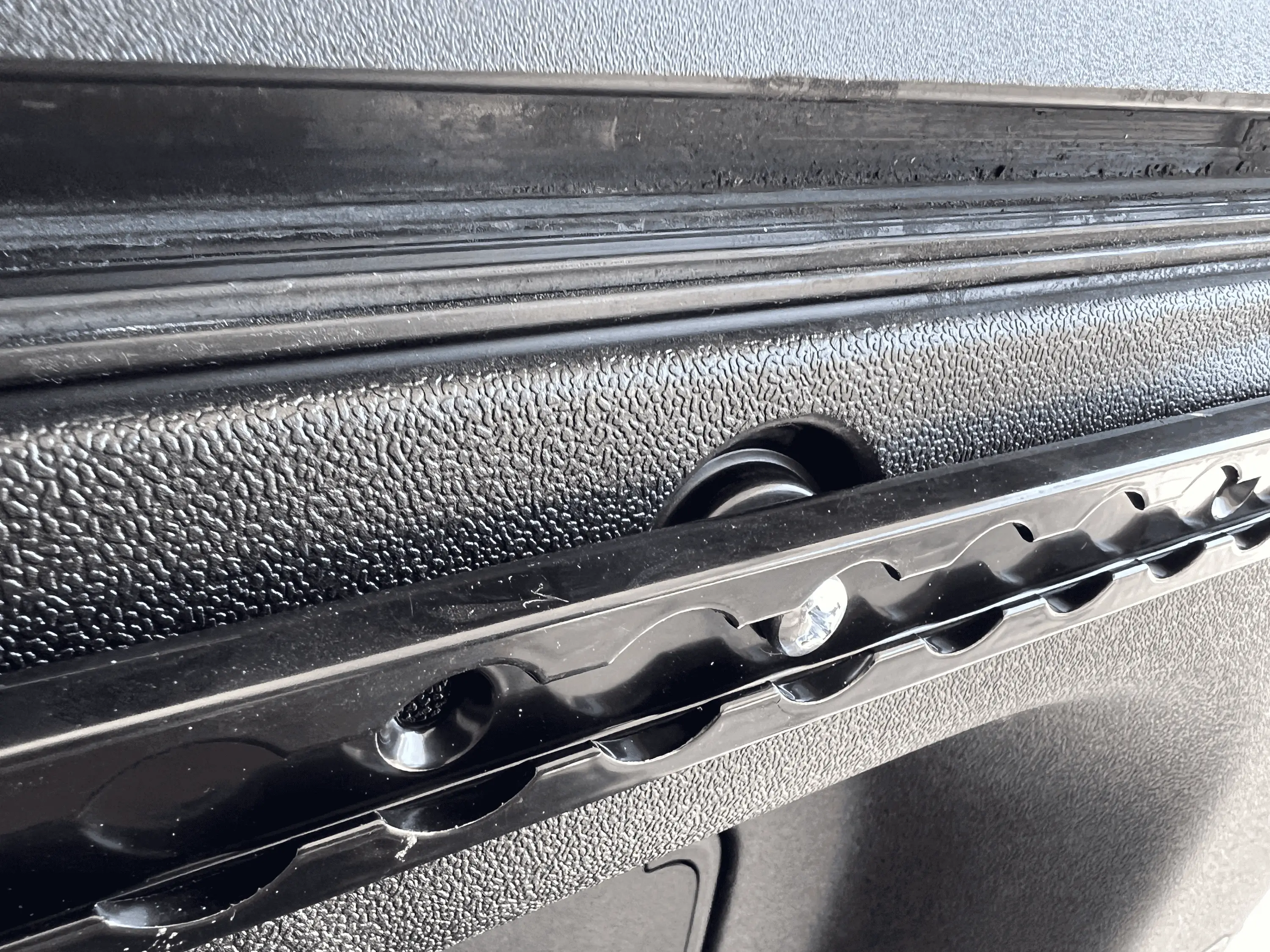

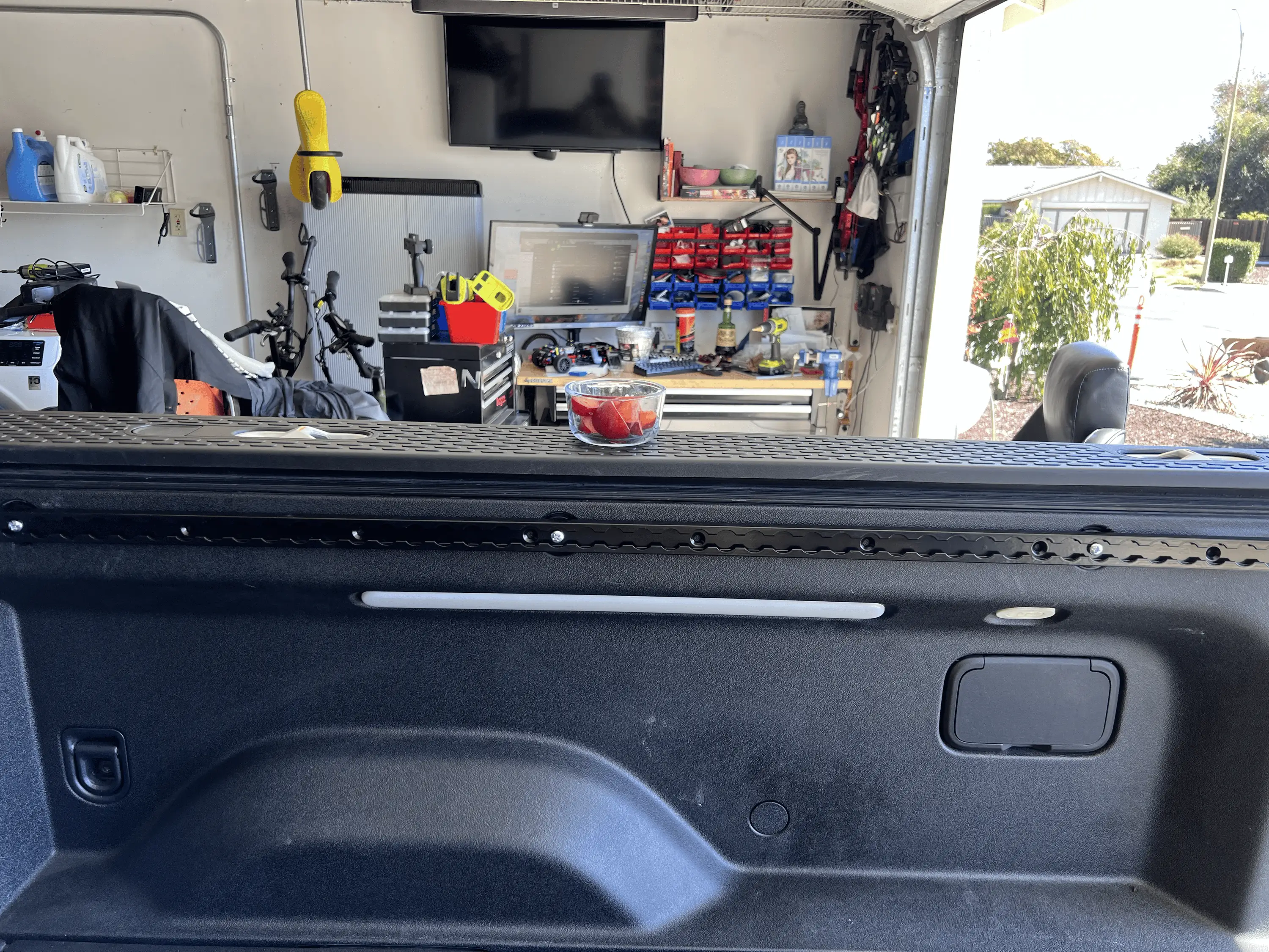

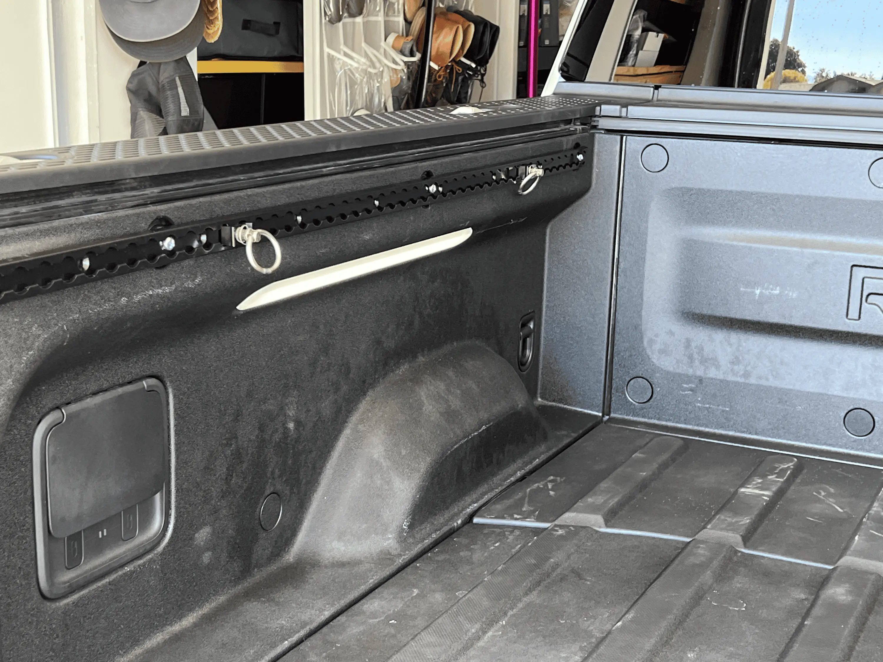

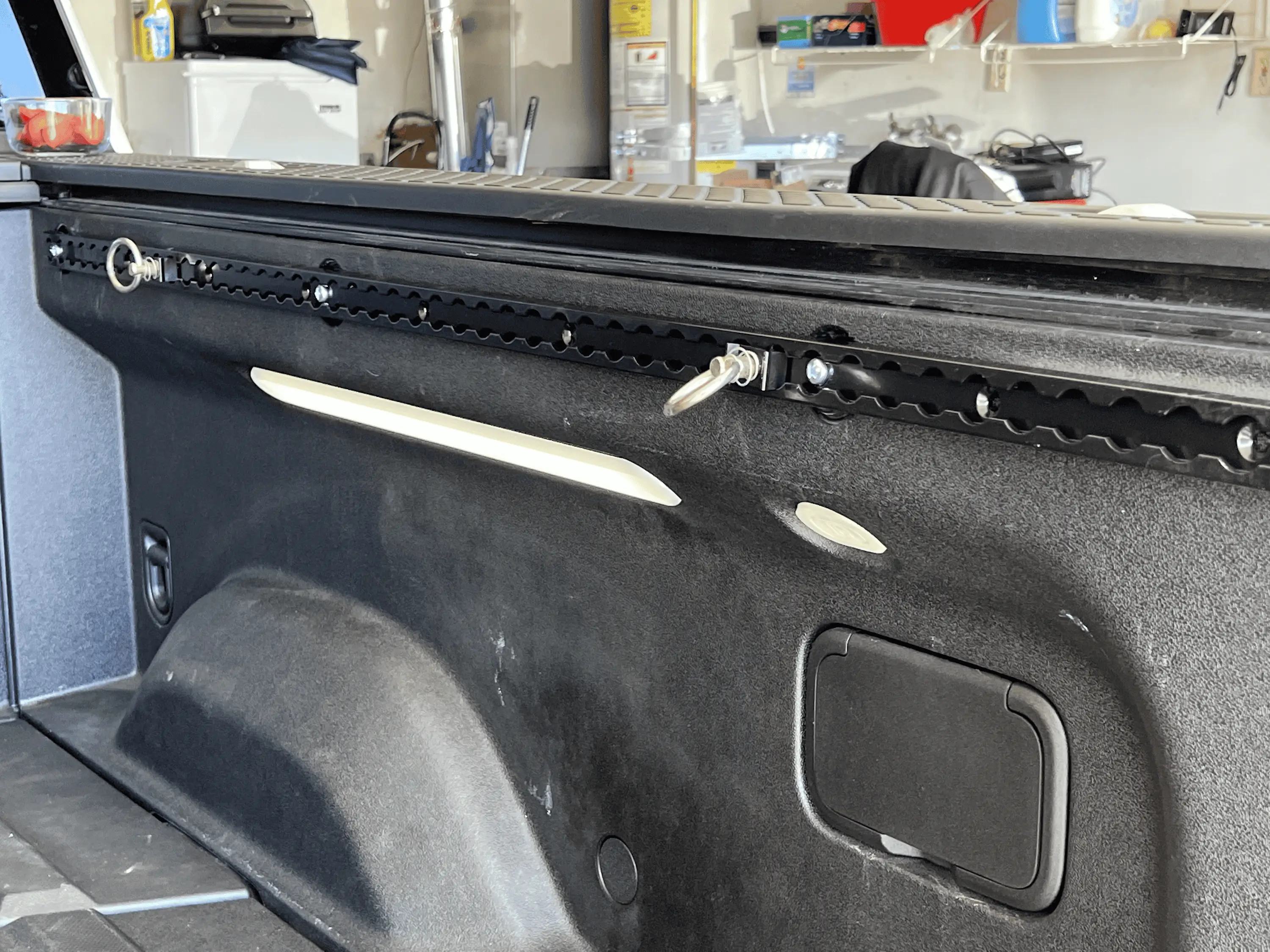

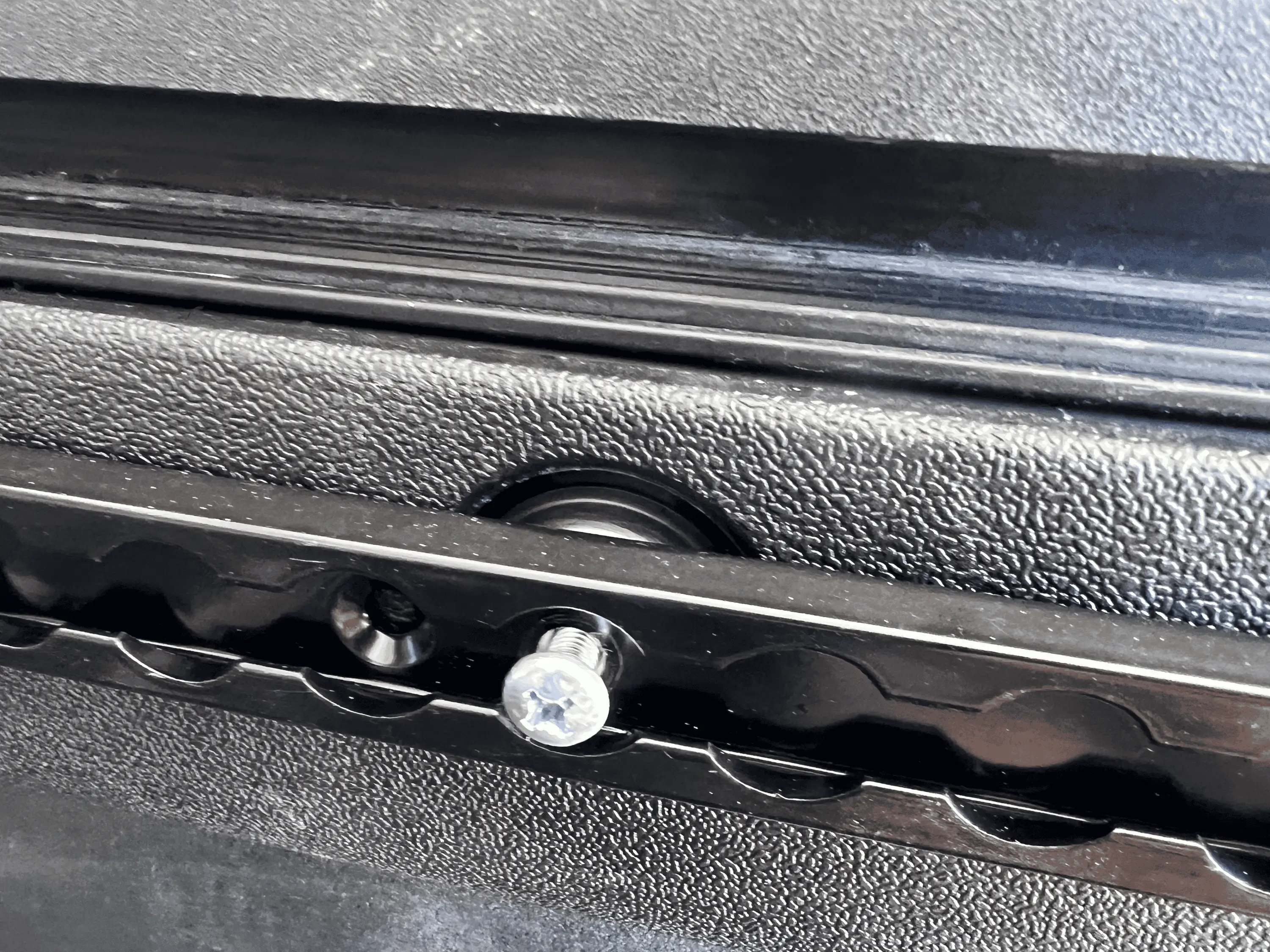

Saturday Project: S Track Tie Down to Rivian R1T
Time: 40 minutes
Difficulty: 1-10 about 4
Parts:
M6 Screws
Small slim flat head
Power Drill, Metal drill bit
Table vice
Shout out inspiration from BedSide Rack Systems Cab Wall Mollie Panel!
Will swap out for black M6 Hex screws. Stupid Lowes... can't find anything....
Added S Track Tie down to the truck bed. Felt mounting/tie downs were very limited. This is Mark 1 Version will look for better kit and mounting options. Overall very happy... reused existing mounting holes. Not looking to tie down thousands of pounds of gear..... just tie down stuff from rolling around in truck bed.

I would like to mount D-Rings in the bed. I saw a YouTube video of a guy that did something similar, but he mounted them at each end of the spare tire hatch. This doesn’t seem like a good structural surface to use. Plus I do t think the latches that keep the hatch shut we’re meant to handle force in an upward direction.
I never used the cargo rails in my Toyota trucks because it was usually better to tie the things I was hauling “down” vs “across”. But nevertheless this S/L track DIY is a sorely needed addition to the only four points we’ve got.

Rivian_panda, what's the correct length M6 screw for this?
Leonbmx
Jan 28, 2022
134
133
2022 Rivian R1T, 2020 Tesla MY
Boeing Design Engineer
I ended up using M6x30 countersunk fasteners and they have plenty of thread engaged.
