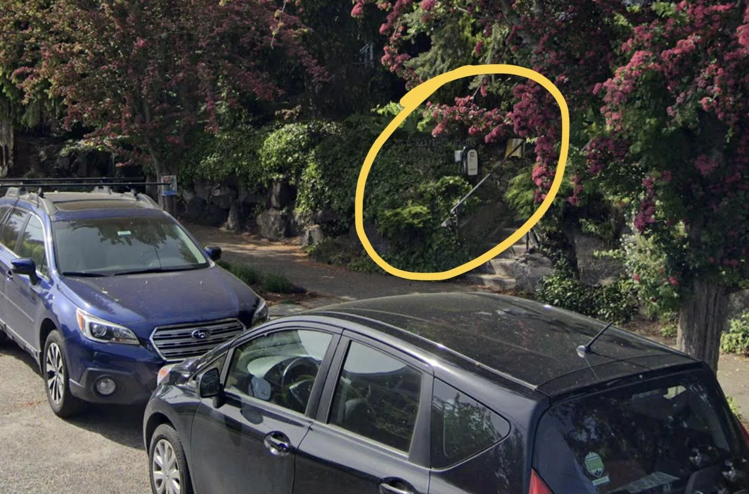

It took me a minute to find, but I have walked/biked past this front yard EVSE in Seattle several times. I have never seen it in use, but it sure seems like the city is open to it.
https://goo.gl/maps/bkBouTL8nzDeafRR8
How is that expected to be used? Is a BEV suppose to park where the blue car is and then hope the cord reaches. Not to mention the cord going across the sidewalk and being a trip hazard.
OR is there a parking spot right up by it that we are not seeing in this picture?

The median between the sidewalk and the curb is typically off limits.
The parking strip is generally not within ones property lines and is legally considered part of the public right of way, so I wouldn't expect it to truly be "curbside". But this setup is clearly used to string across the sidewalk and charge a street-parked car (and I've always thought it odd enough that I was able to figure out where it was on street view).

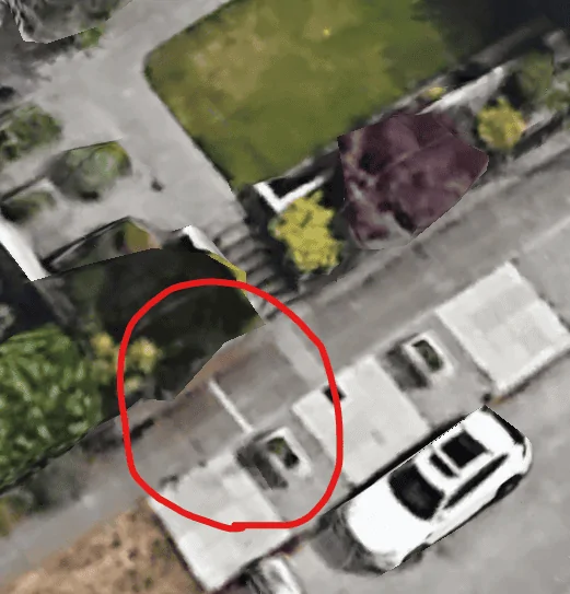

There's a home in my neighborhood where the homeowner has actually taken the charger right to the curb. This is a blurry Google Earth photo but you can see the brighter strip on the sidewalk which is new asphalt under which they buried the conduit. They then put a planter on the curb with a nice little electrical box where the charger is housed. They didn't have another option (no garage or driveway). I might swing by and drop them a note to figure out if they got this permitted and how much it cost.
