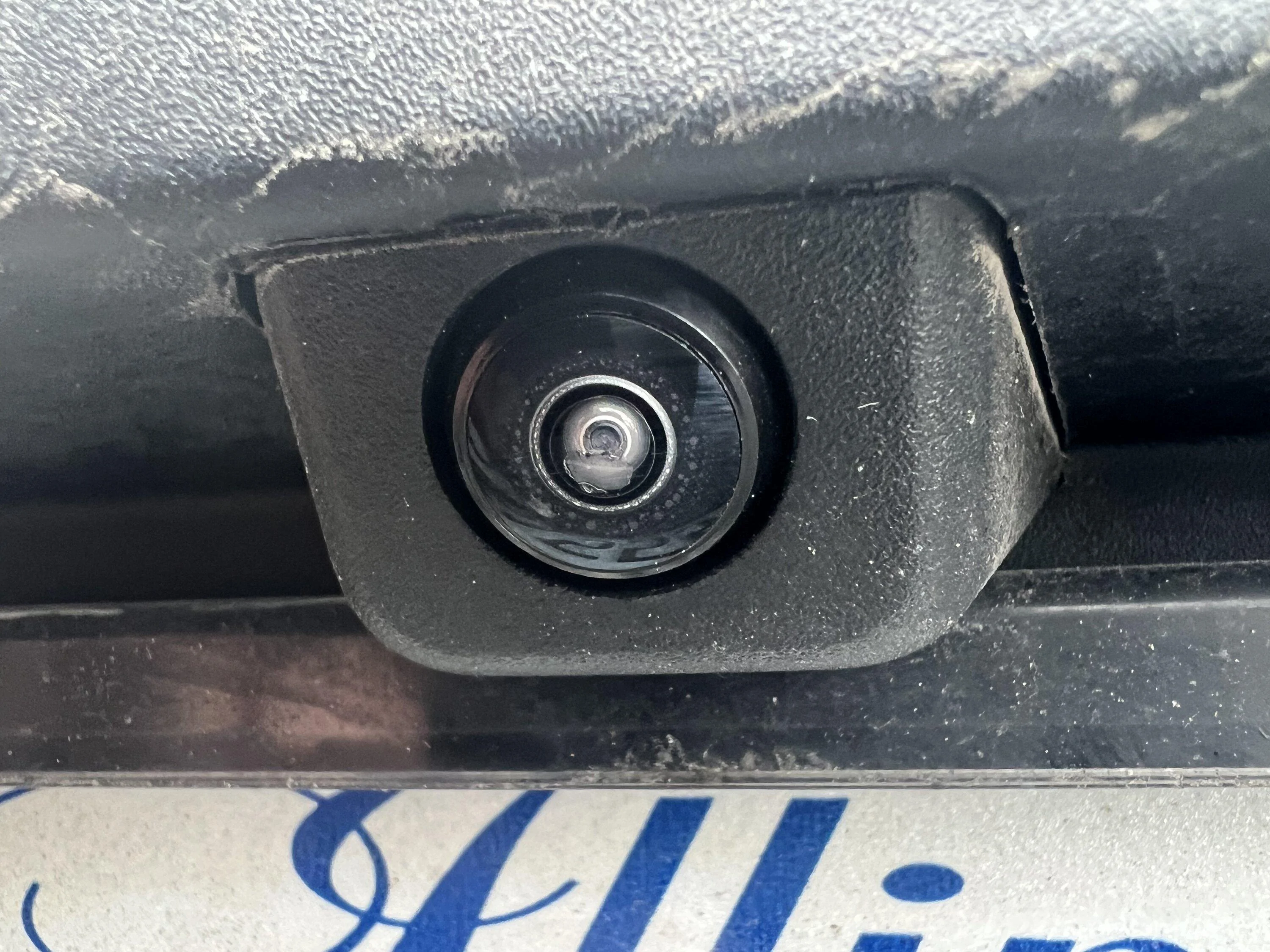

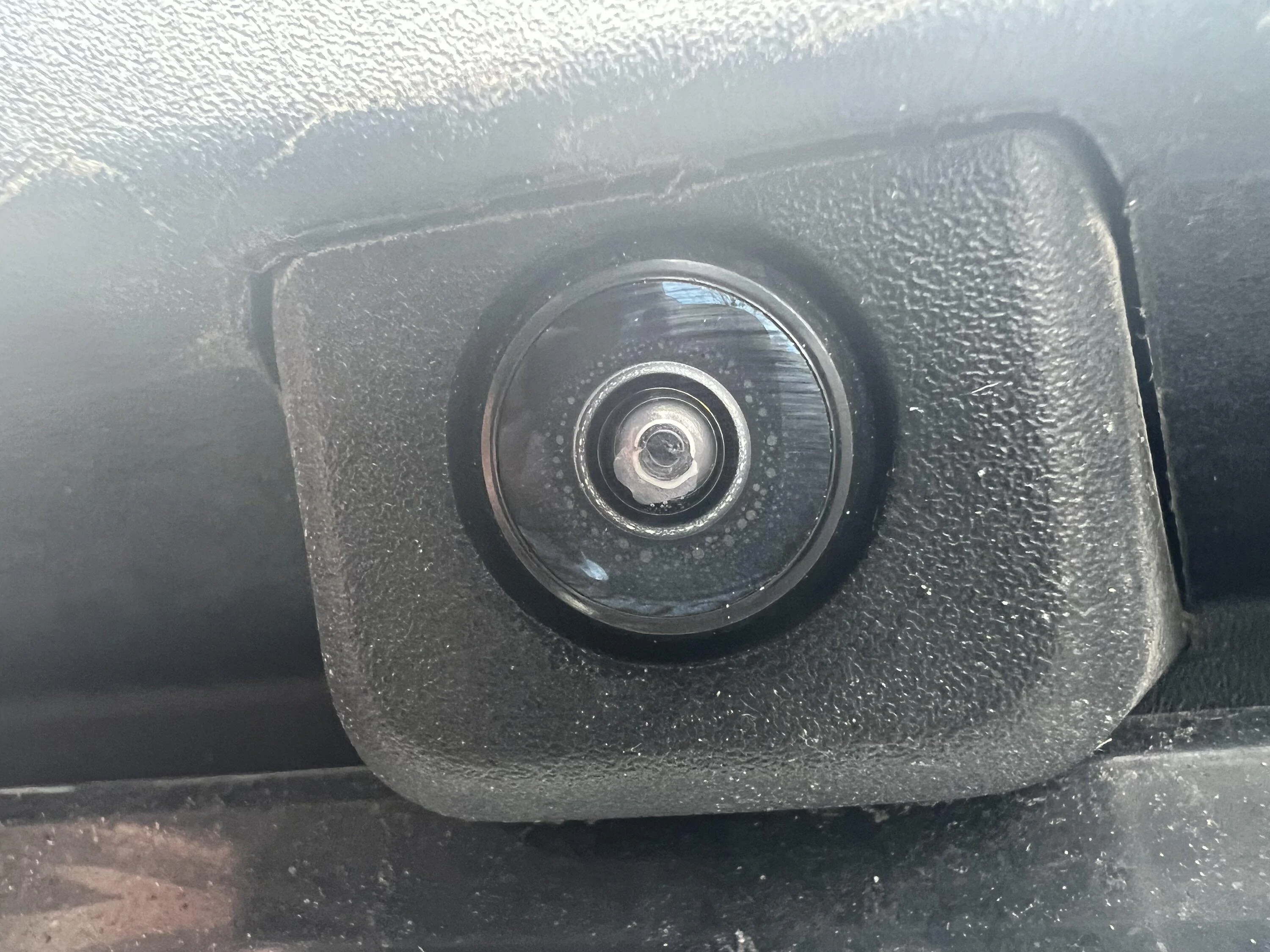

I cant clean the cloudiness off my backup camera. I rely on it heavily for my long driveway.
I'm embarrassed to say I did use rain-x for glass on it not knowing whether the lens was glass or plastic, but didn't think it would hurt.
I have had terrible salt on the truck from winter here in Chicago, but salt has never harmed my other cameras so i doubt thats the problem.
Have others had this problem or been successful at remedying it? I am contemplating trying a headlight restoration kit before taking it to service for likely replacement.
Any suggestions appreciated.

Well there you have it. It’s usually dark when I go to work and dark when I come out so today is the first day I got a good look.
Water droplets and ice crystals inside.
Looks like back to service.
