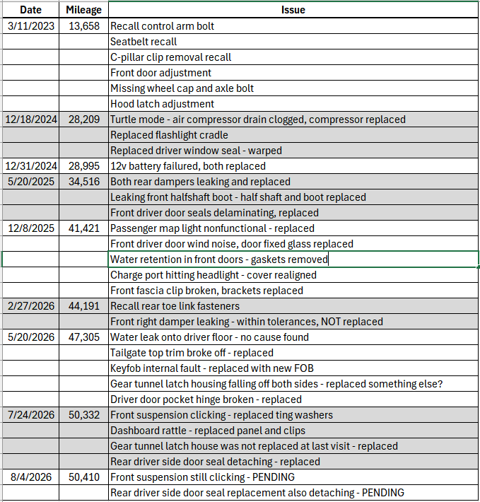

So I need a little vent and maybe reassurance (or forewarning to bail?). I've owned Truckdor the Drivenator (a 2022 Launch Edition R1T) since October 2025 (around 40k miles) and it's definitely been the most enjoyable vehicle i've owned and when all is well, I'm a huge Rivian fanboy to everyone around me. Lately, I'm starting to get tired of visits to the Service Center. Up until the last two weeks I've been pretty nonchalant about it as the service center folks are fantastic and have always had me set up with a rental, loaner, or rideshare credits based on my preference. My last visit with them 2 weeks ago, I didn't need a loaner since we were going out of town and they had issues with their rideshare credits website so one of the staff just drove me home (I live about 7 miles away).
That being said, the issues, though often minor, have been mounting and they recently sent me all the prior owner service records. With about 10 months and 10k miles left on the basic warranty, I'm starting to get second thoughts about keeping the truck beyond the warranty period. Especially now that the last 2 visits i've had it in there's been 3 issues where they fixed the wrong parts, the replaced part also failed immediately, and the fix did not solve the problem. On top of that, my loaner today, a 2023 R1S quad for which I got only a keyfob, failed to recognize the keyfob and unlock as I was leaving to get my kid from school and required over 30 minutes on the phone with service to remote unlock and was quite past pick up time getting my kid.
I guess the rose-colored glasses are fading a bit. I absolutely love the vehicle if there aren't any issues and everything listed here has been covered by warranty, but that part will end over the next year... I'm mostly concerned the front air suspension, which is original, continues to sag. It was nearly bottomed out after sitting for 4 days at the service center this last visit and I had the tech look at it and he said they have specific parameters using the position sensors and twice it's passed this evaluation.
Here's the 9 service visits I am aware of:
Rivian R1T R1S Beginning to get frustrated... 1785889310535-g6
So like I said, I don't know what I'm really looking for here other than to vent a little, maybe have someone say they had a similar experience and the truck was magnificent the next 50k miles so just stay the course?

You latest one (8/4), I had the same issue with the seal flopping down on the drivers side. Instead of taking it to the service center for repair (and probably couple hundred dollars, I grabbed a bottle of Gorilla Glue (the clear kind), put some on it and pushed it back in. Shut the door and waited a few hours.......voila.....fixed it!

Love the R1T, but even with extended warranty, the vehicle suspension and half-shafts are just too problematic and even if covered by the warranty, I don't want to spend time getting things fixed in the future. Moving to R2 for simpler build, but the same Rivian experience with (hopefully) fewer service visits.

That's much more than what my 74K '22 has seen, but she's been in the shop more than I'd like. All in, it's still the best vehicle experience I've ever had; unfortunately, there's no equivalent vehicle for sale that offers the same upsides. Maybe someday Tesla will take the "cyber" out of their CT.
As for the halfshaft washers clicking, that seems to go hand in hand with the Bosch motors on the early builds; I just live with the clicks at this point. I don't see the tanneau cover on the list; if you have one, this is a common failure point too. Mine was replaced under warranty at 59K mi.

Keep a a close watch on the wet front floorboards. The Gen 1's have been known to get a plugged AC condensate line and they will then start condensing inside the cabin. I just had mine in for the second repair on that two weeks ago. The fix is about 11.5 hours of labor as they need to remove the dash and replace the insulation on the firewall, as well as the front carpets. Apparently on the first fix, the SC managed to leave a 10mm bolt in the drain area and that's what caused the second issue. Now I need to ask them about the scratched window tint as a result of that second repair.
