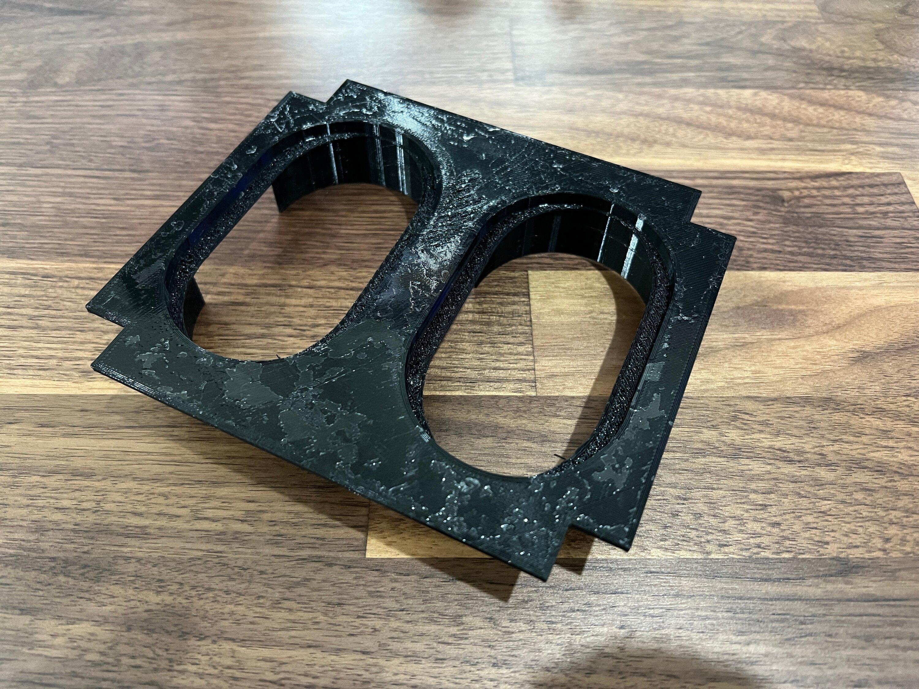

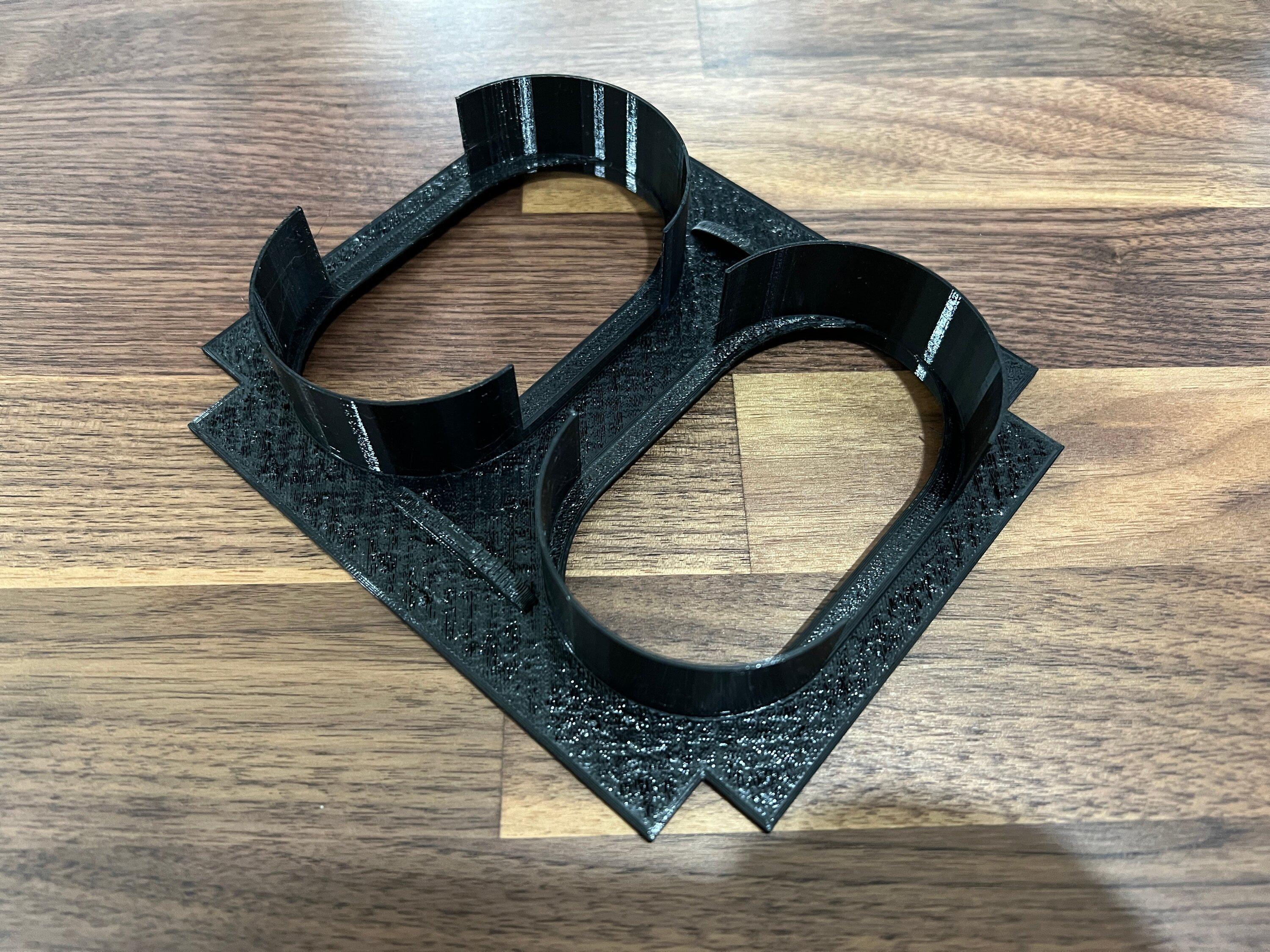

I've successfully printed the first version of the shelf which I'm comfortable publicly sharing. This version has a bunch of improvements over the last version:
  1. Significantly more robust legs that provide more consistent support to the plate and wont just snap off.
  2. Better ledges for the wireless charging pad that provide additional support for that as well.
  3. Two additional supports (the little domed areas) on the bottom of the plate to more structurally stable side to side. Before it would bow slightly if you pressed on the center front front and rear with the high sides being at the driver and passenger sides.
  4. Slight tweaking of the dimensions of the shelf to better just a bit better. The gaps were just a bit too big, IMHO, despite it not really causing an issue. There is still a bit of room there for it to shift around, which is desirable.
  5. Eliminated some printability issues with the STL file.

(again, please ignore the finish as it's an artifact of my 3d printer, not the design)
I've published the STL file here: https://www.thingiverse.com/thing:5420183

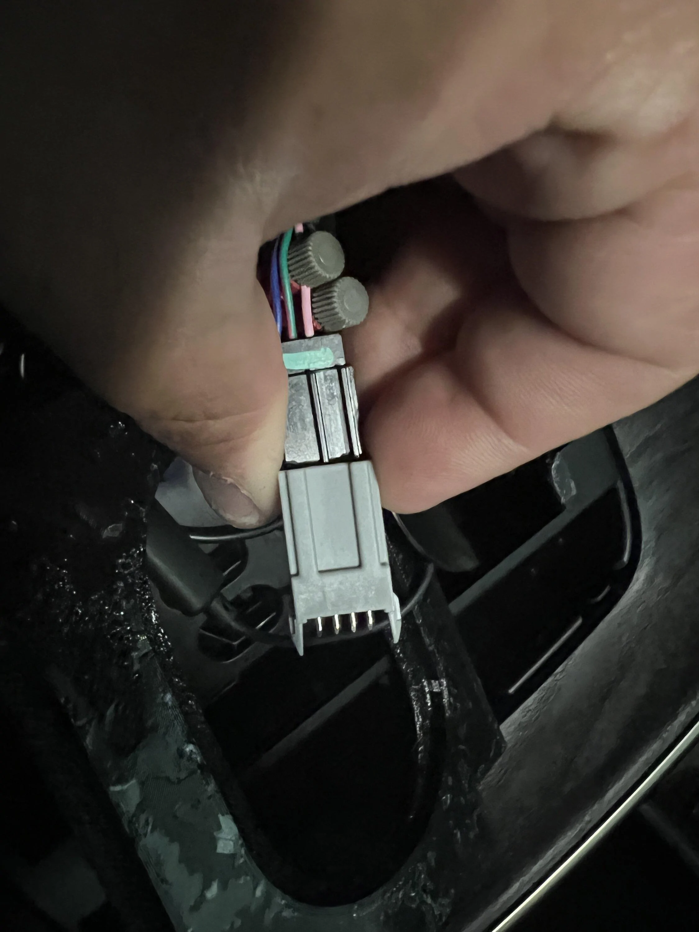

can someone post several pics of both ends of the factory harness and charging pad connector? Instead of posi-taps, it’d be great if we could identify the connector and source the right bits to make it plug-and-play. I bet they’re using an off-the-shelf conmector.
This thread has some speculation on the connector, hard to say definitively which one is correct: https://www.rivianforums.com/forum/...-charging-pad-photos-observations.5317/page-2
I’m with you, though. I don’t want to posi-tap those wires.

FYI - The link below looks to be the other end of the wiring. I purchases a few of them from Arrow using the second link below:
https://www.molex.com/molex/products/part-detail/pcb_headers/0311010041
https://www.arrow.com/en/products/0311010041/molex?region
Like everyone else, I would be thrilled to use it. I'm probably going to see if a dupont connector would fit onto the pins coming from it. Something like below. My guess is no.
Rivian R1T R1S Working Magsafe / Magnetic Qi Wireless Charging Pad Install! - DIY Writeup 61eE1zN9TbL._AC_SL1500_
One other way to do this would be to solder the connectors directly to the pins and shrink wrap over them. I might also give that a whirl. If anyone has thoughts on this, I'd love to hear them.

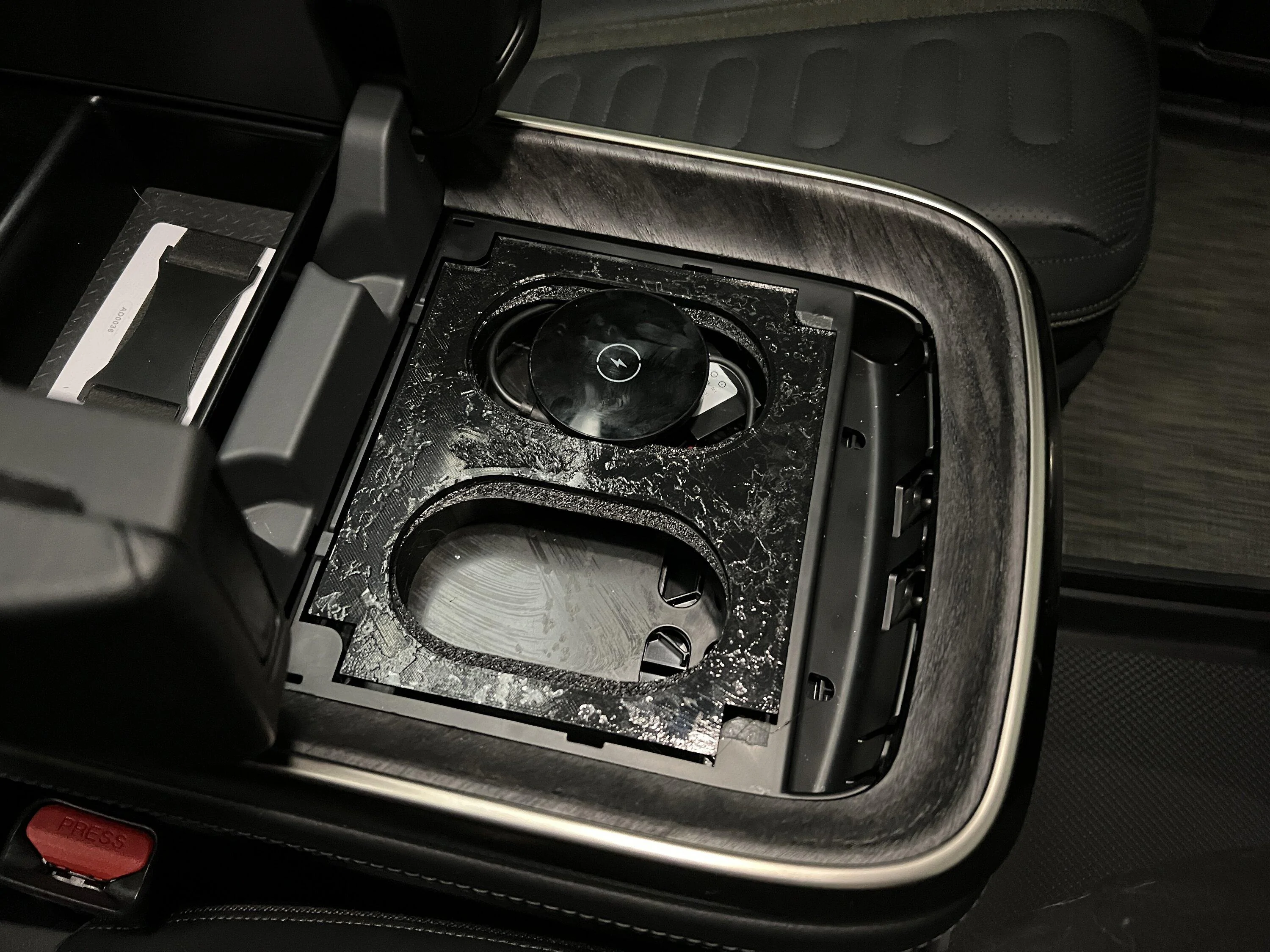

Welp, my dudes, I've done it. I have successfully replaced the POS wireless charging pad with a Magsafe / Magenetic Qi chaging pad that functions correctly. It's 100% powered using the existing lead in the wireless charging pad cavity and does not require using the USB-C ports in the center console.
I may see if I can source the components here in bulk for a group buy or similar. If you're interested, please post below. Right now, everything here is pretty hard to come by, and the posi-taps are stupid expensive if you're looking for lower quantities.
That's it. Happy to answer any questions!

The connectors as identified earlier are not correct. Please do not purchase / recommend them. Theoretically they can be made to be right however, but I think more research is required.
