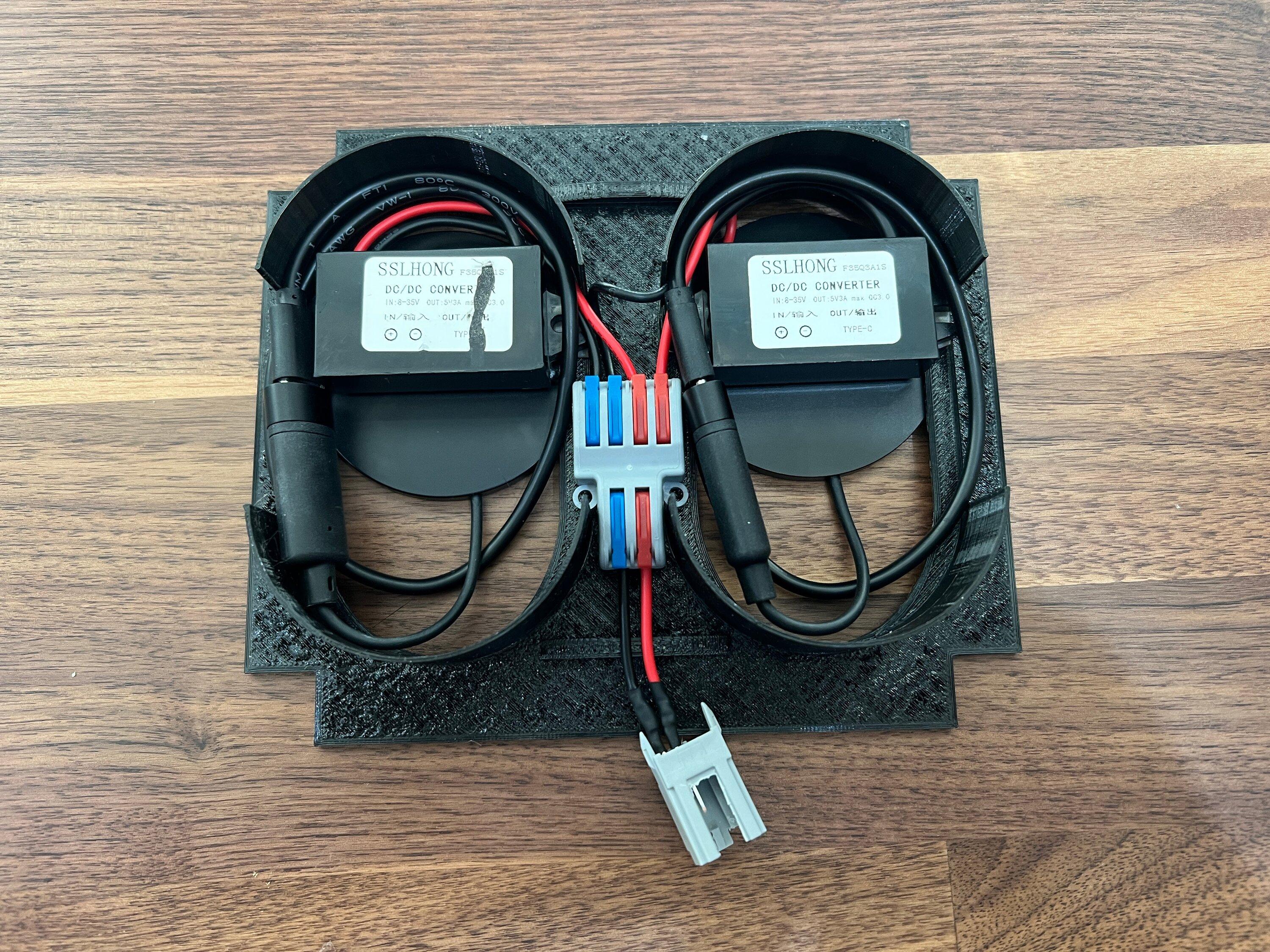

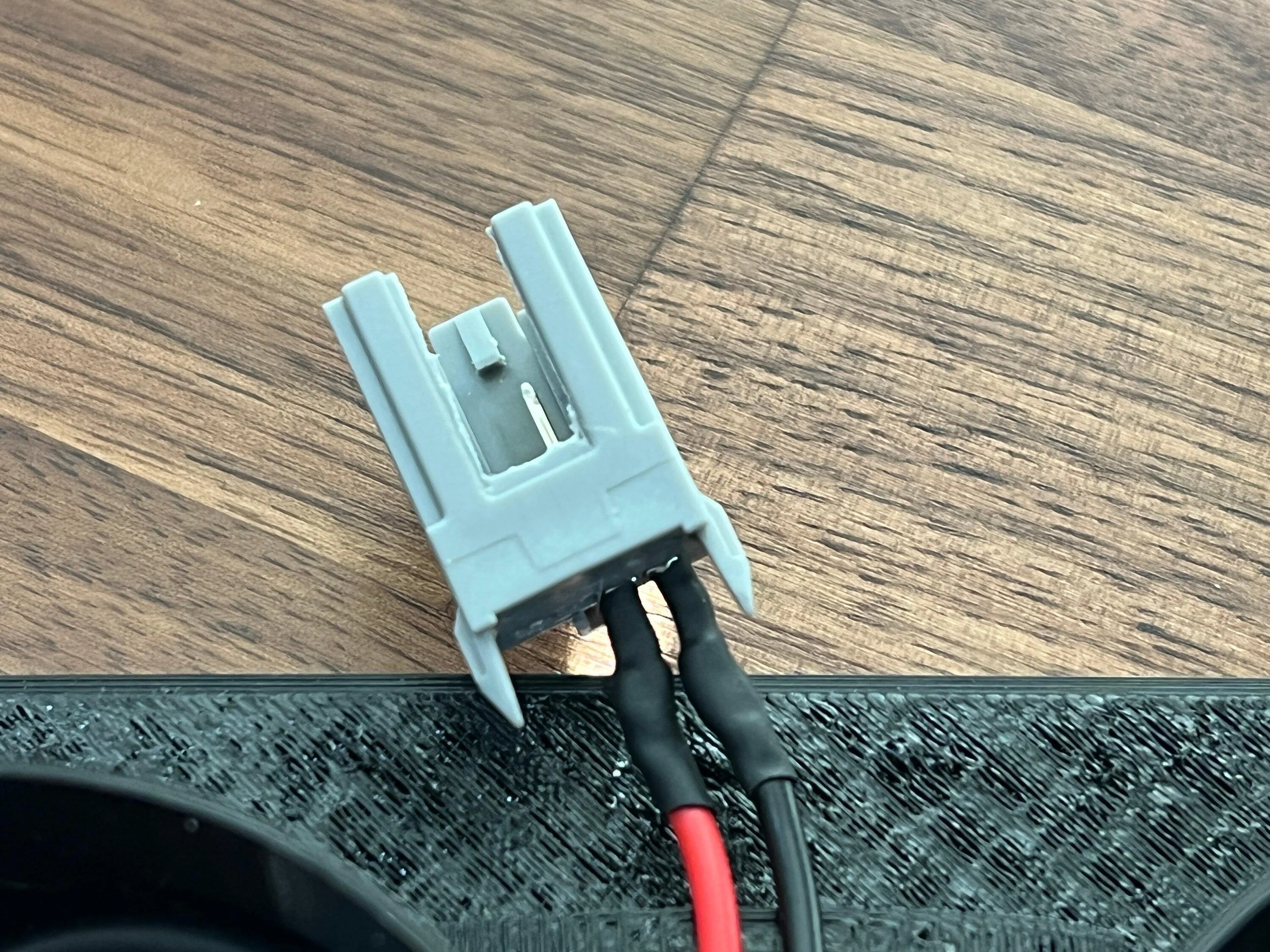

Well, my dudes, I think I have done it. Below are pictures of what I believe to be the first dual Magsafe Wireless Charger for a Rivian that uses in the OEM connection for the POS wireless chaging pad.
There are a few changes from the last pictures I posted:
  • There are now two DC to DC converters and wireless charging pads installed.
  • Wiring now uses a little tool less junction box + a modified version of an OEM plug that I ordered (it's the wrong one, the correct one is inbound now)
  • I've soldered a power and ground wire to the OEM connector. (this was very detailed work) I've also insulated shrink wrapped over it.
  • I've double-sided taped the converters and the junction block to the bottom of the shelf and loosely routed all of the cabling so I should be able to drop it right in.
And that's pretty much it. Wife has the truck for the evening, so I can't test to verify. I do have to do a bit of driving tomorrow though, so I should have a really good idea then.
Oh, and pictures:
Rivian R1T R1S Working Magsafe / Magnetic Qi Wireless Charging Pad Install! - DIY Writeup IMG_0463.JPG
Rivian R1T R1S Working Magsafe / Magnetic Qi Wireless Charging Pad Install! - DIY Writeup IMG_0462.JPG
Rivian R1T R1S Working Magsafe / Magnetic Qi Wireless Charging Pad Install! - DIY Writeup IMG_0464.JPG
Rivian R1T R1S Working Magsafe / Magnetic Qi Wireless Charging Pad Install! - DIY Writeup IMG_0465.JPG
