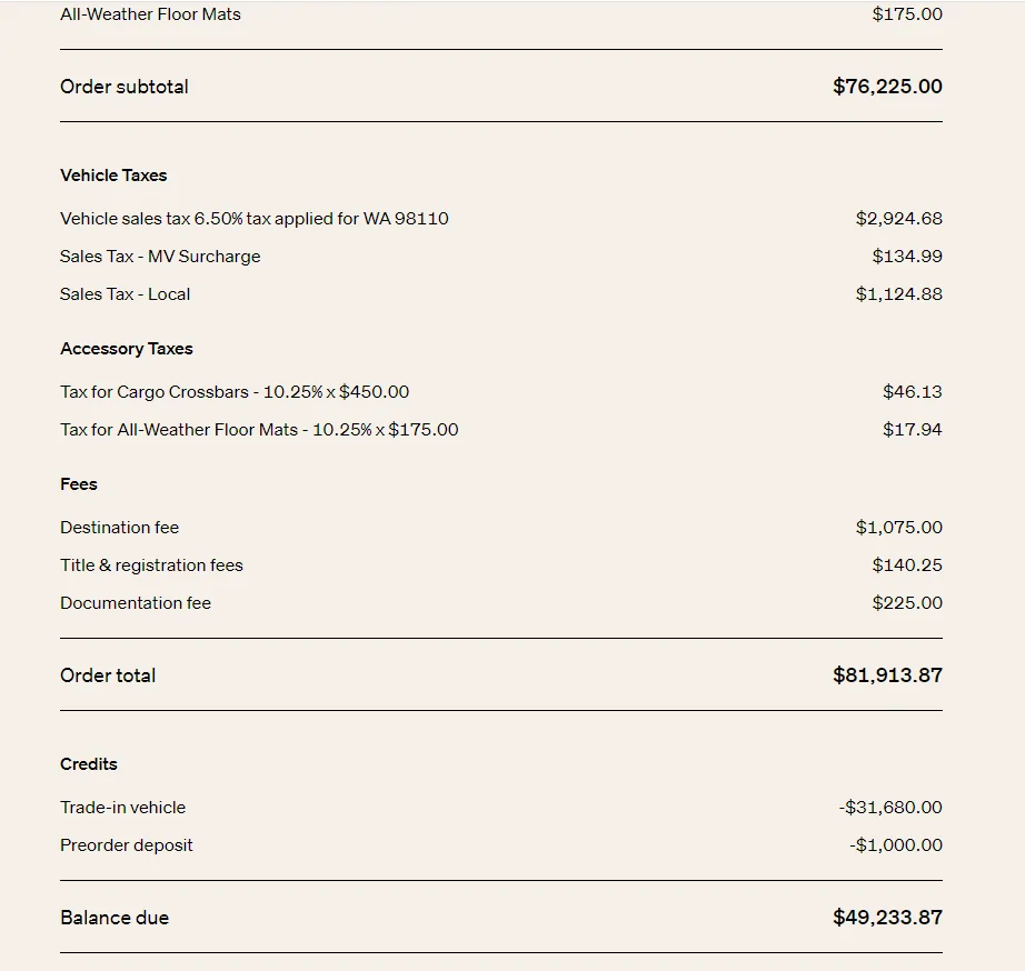

Here is my breakdown. It seems like I was charged 9.53% total tax before the doc and destination fees. Granted that is partly because the truck is registered on Bainbridge Island so there isn't the huge RTA tax. Not quite sure how they calculate all that in with the Destination Fee and such. Also, my fees on my registration were listed at $261 instead of the $140 they charged me.
Seems like a crap shoot haha
Thanks, yea I think your taxes are all lower because of the trade-in. If we run your percentages based on the net cost after trade-in ($43k?) they seem to line up, except your local sales tax might be lower for Bainbridge.

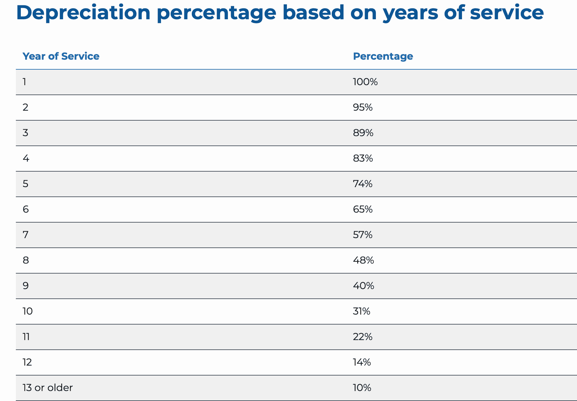

Reviving an old thread here, but wanted to see if others were getting billed an RTA tax rate of 1.827%? All the other tax line items check out, but this one seems higher than expected but it doesn't align with official documentation stating a tax rate of 1.1%.
NVM: seems like RTA tax isn't calculated like other taxes on (sale price - trade-in value), but instead on MSRP + destination
That is correct.. RTA is not like a sales tax (based on Net value after trade), it is based on the full MSRP of the car with a ridiculous amount of annual appreciation, as they charge it annually. If our cars only depreciated by 11% through the 3rd year, we would all be very happy, instead it is just the state that is happy.
