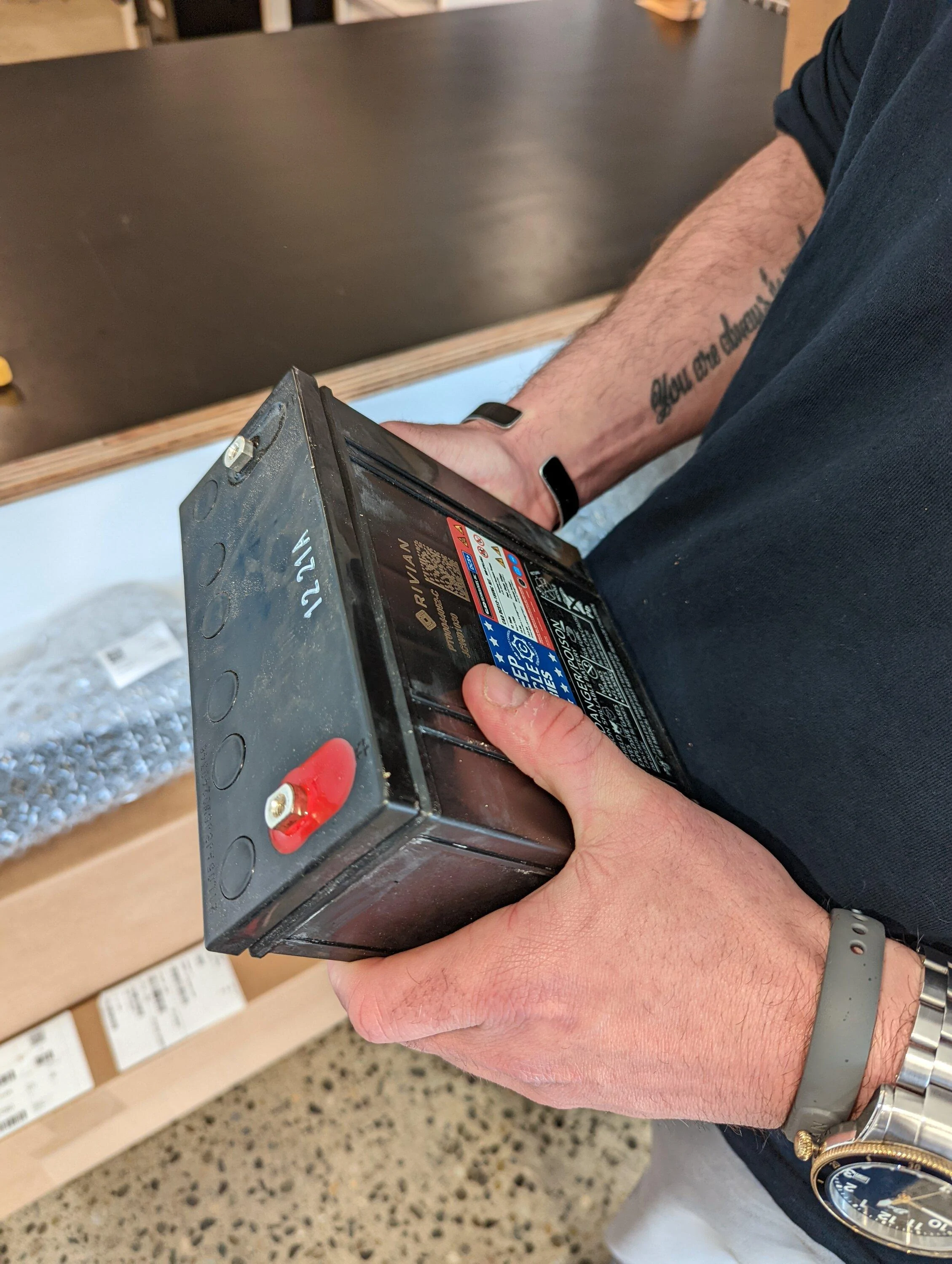

Fix / update by @bael who had the same issue:
Link: https://www.rivianforums.com/forum/...attery-trickle-issue-needs-software-fix.5313/
Got the truck back.
The module that tells the truck it’s going to sleep and the high voltage should trickle the 12v doesn’t always tell it. It’s being worked on, hopefully the next software update contains the fix.
12v batteries got replaced because of it.
Fingers crossed it doesn’t happen again before another update.
Original post:
This morning I got into the truck and both screens were in night mode even though it was daytime. When I attempted to shift into drive multiple warnings popped up. Service airbags, a red truck icon with an exclamation point and others. Was in a hurry so I left. Came back about an hour later and same warnings were on.
Called Rivian service and they started asking questions and I sent them pictures of the screen. We attempted a full reboot (left steering wheel button and hazard flasher button). When I attempted to shift into drive even more warnings popped up including the tortoise. Service advisor said let it go to sleep and he'll get tech support. After 45 minutes the screens wouldn't come on. Just got off the phone with Rivian again after being unable to unlock the doors. They will get back to me. Not great. Had the truck about 5 weeks. Loved it otherwise...
Got the truck back.
Original post:
Less than 24 hours (total) the truck is now fixed. Software issue (supposedly only a few trucks) that doesn't allow the 12 volt battery to get a charge (mentioned by others in this thread). They replaced both the 12 volt batteries, calibrated my windows and detailed my truck (it was filthy). Excellent service, really the best and the Bellevue lot is full of Rivians waiting to be delivered. No R1S yet but they did have an Amazon electric delivery van that I could only see at a distance. Here's one of the batteries they replaced. Love the truck even more. Absence makes the heart grow fonder!

I had my 12v battery die on my 2019 Tesla Model 3 during the first month of ownership. I went the go to work one morning and the car was bricked. No power to anything. The tow driver that towed it to Tesla knew about the 12v battery issues and connected his jump box to the 12v port on the front bumper. The car woke up immediately. Tesla replaced the battery with a different type and no issues thereafter. After that episode I have always carried a fully charged jump box in my trunk in my EV’s, just in case.
For those of us who venture far from pavement and cell service, it may make sense to keep a fully charged compact jump battery with us if we are locking the vehicle. I could see getting annoyed with myself if I got back to the truck after a hike only to find that I couldn’t unlock it because of a low 12V battery while knowing there was a jump battery unreachable inside.

Picked mine up from Bellevue on Monday the 9th, 12v had died, and were replaced. Invoice said both primary and secondary 12v batteries.
HV battery was low, after a few days of sitting around, the 12v quit, and bricked. Was towed in. Seems like a bug, I would expect it to protect itself from completely draining the 12v, and causing damage. Sure brick, and need charged, or jumped and charged, but killing both primary and secondary 12v doesn't make sense. Even my previous ICE truck has a low voltage disconnect, so you could start your truck even if you drain 12v somehow.
Service was not an overly great experience, and I was in a hurry, had a trip to Boise. I paid the bill, but I have some follow up on this being an issue that needs to be covered under warranty.
Was on 2022.11.2 when it happed.
