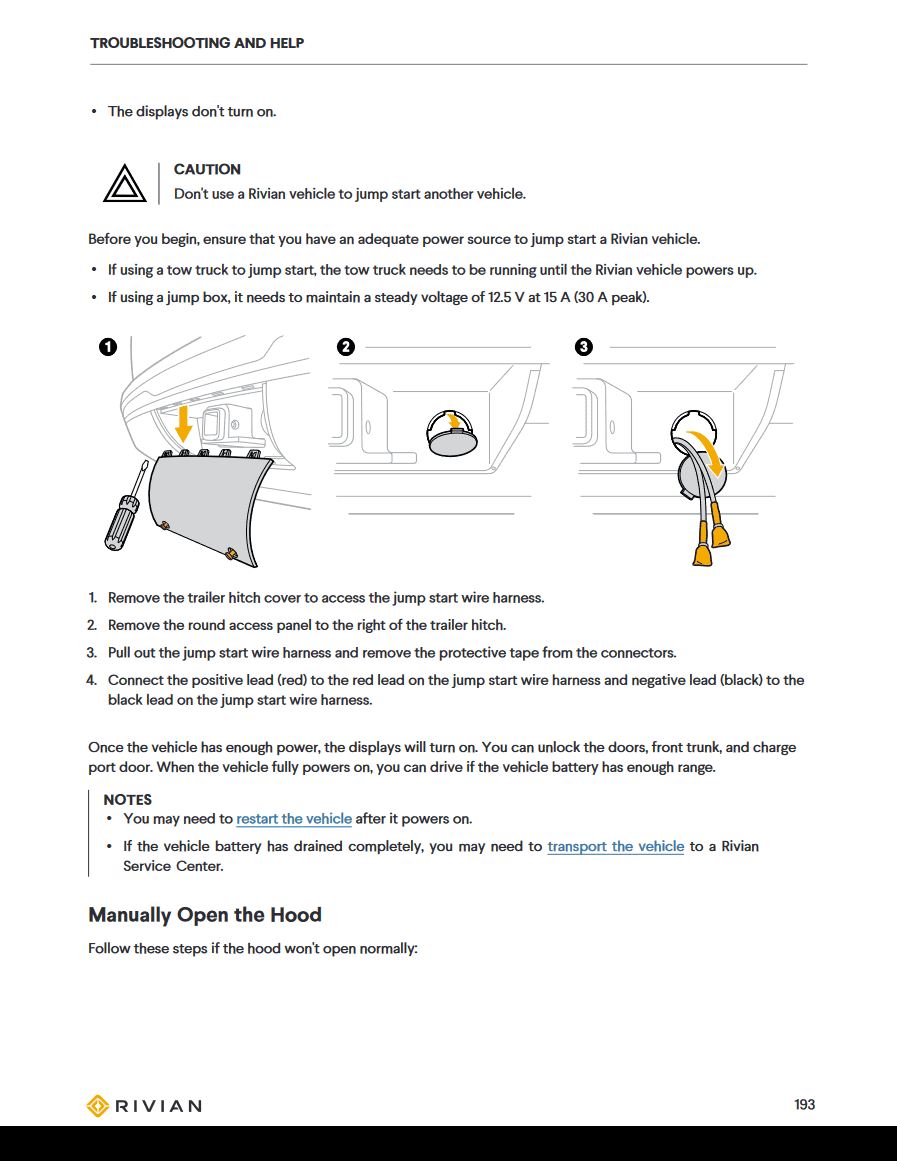

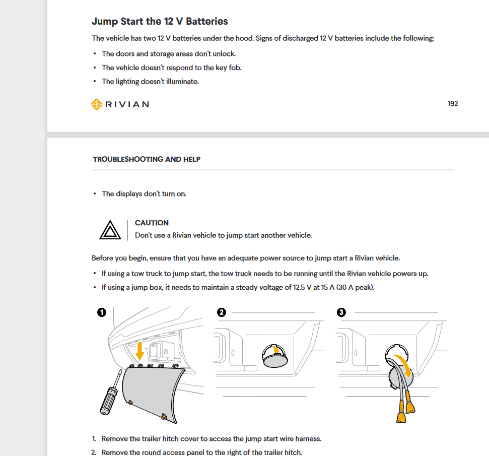

Look at pages 192 and 193 of the latest R1T manual. It shows how to jump start the vehicle with leads by the hitch receiver. You should be able to charge the battery there as well.
