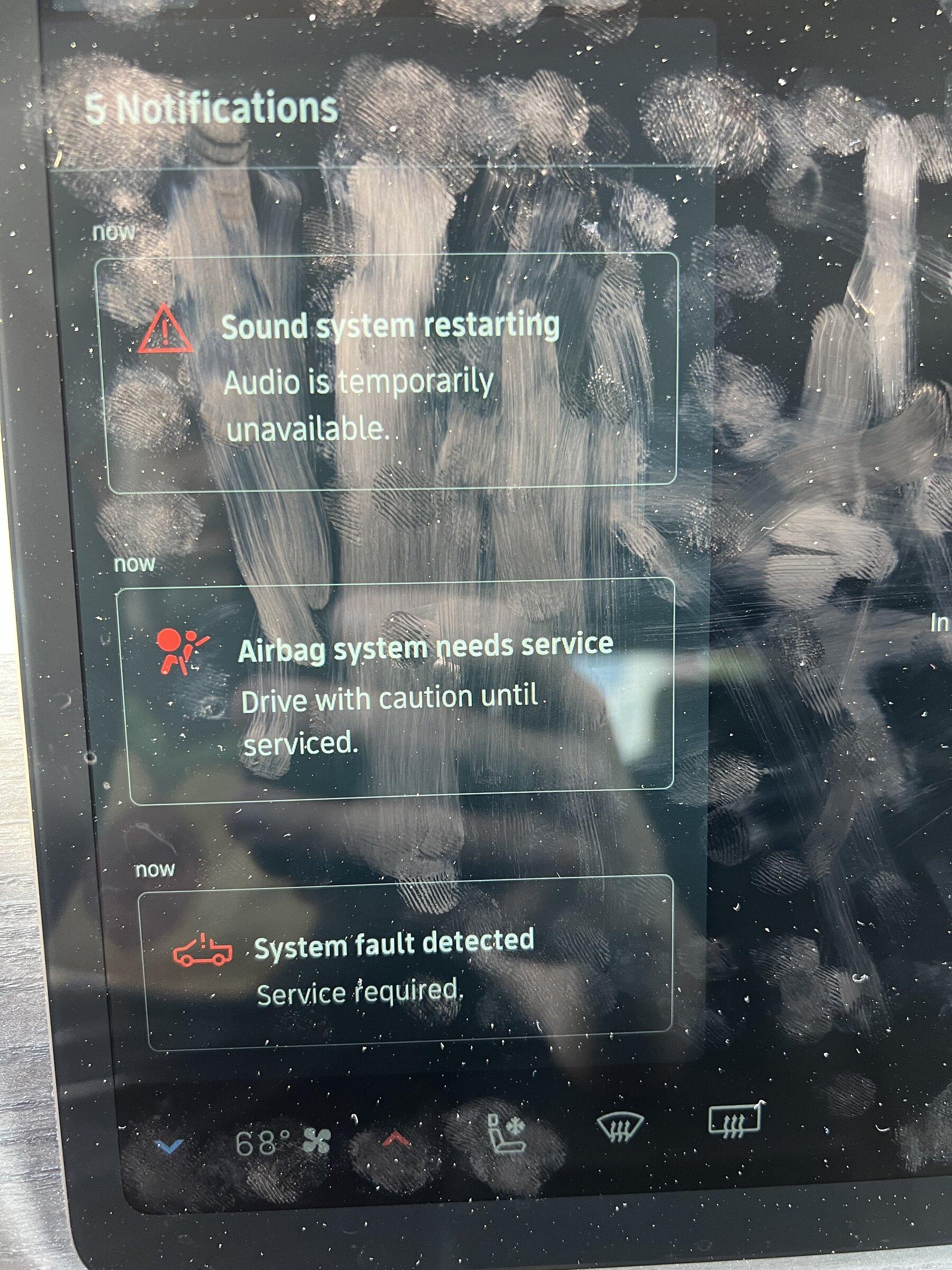

Was driving around today and after a few stops, and showing off the truck, got in to depart and was met with system faults and turtle mode. Full truck reboot didn’t solve it nor an additional sleep cycle on top of that.
Parking brake is locked on and greyed out. Rivian is sending a tow and taking it down to the service center.

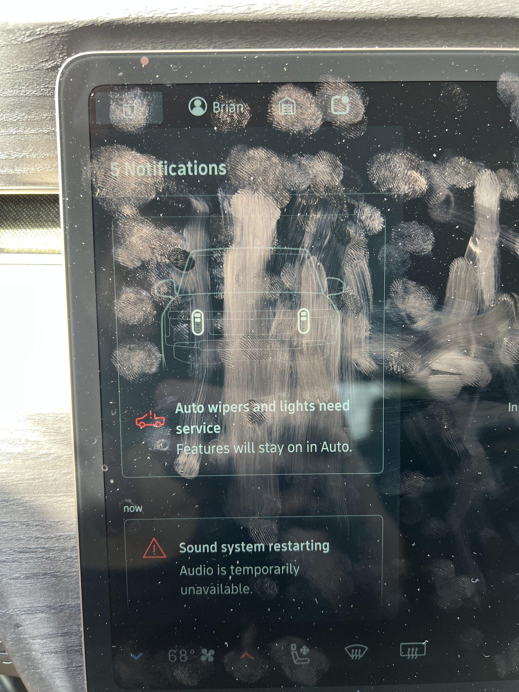

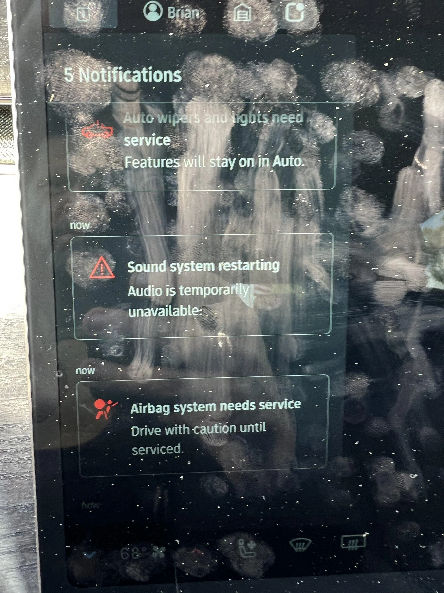

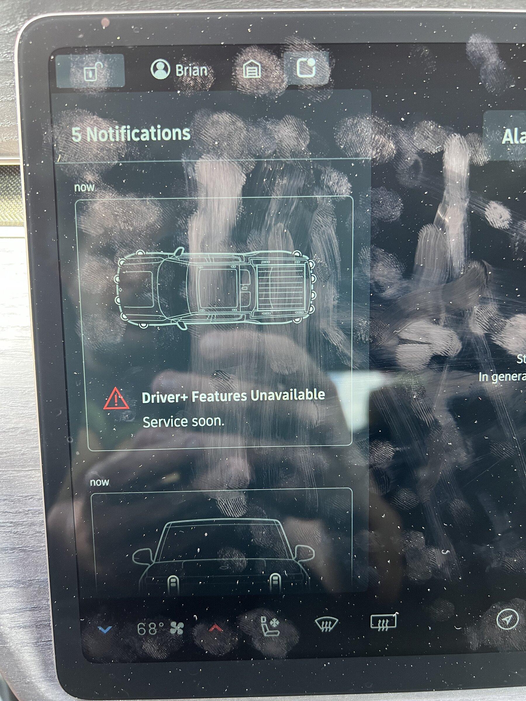

Lots of glare and fingerprints, but here were the errors that lit up
On 2022.15.0 as well

Did it show a battery (12V) error? Some vehicles will start showing a ton of codes if the voltage is out of spec. If that’s the case it may not be as dire as it looks. It could be like HAL singing “Daisy”
if it is a voltage issue then it should be easy to fix once the root cause is identified. I hope. Please keep us posted and good luck!

My bet is 12v as well. Seems like it really upsets the status quo
My understanding of the issue is that modern vehicles rely on numerous modules which communicate on a bus/in-vehicle network. When the voltage gets out of spec (typically too low) the modules can start acting flaky and/or communication issues arise. In either case the main computer thinks a lot of stuff is broken/offline and starts spewing error messages or fault indicators.

One of the Christmas tree looked like the 12v - but that wasn’t always showing when running through different attempts to work with it
just got towed away. With the parking brake locked, had to be done with skates and from the rear as it was nose into a spot.
