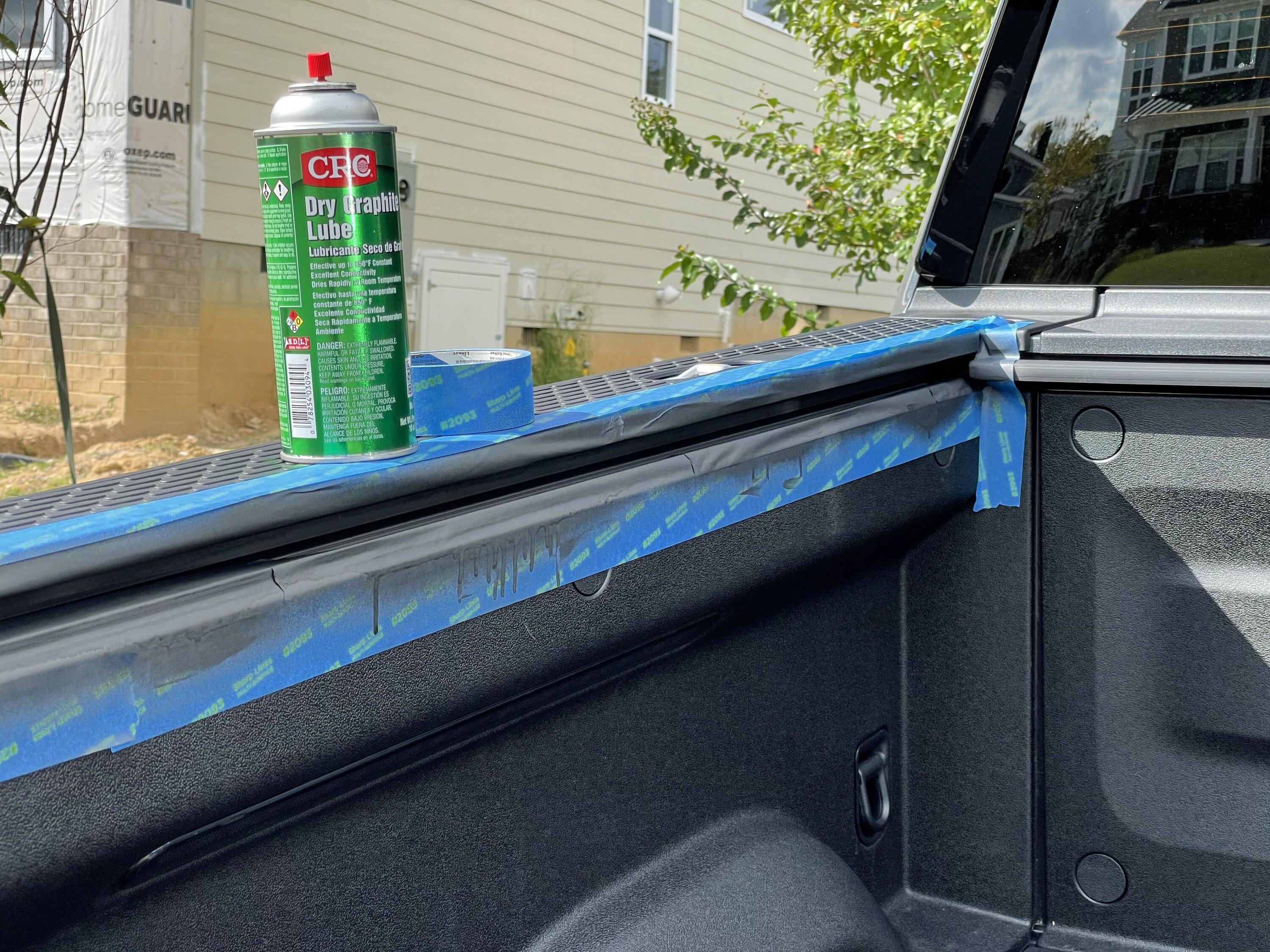

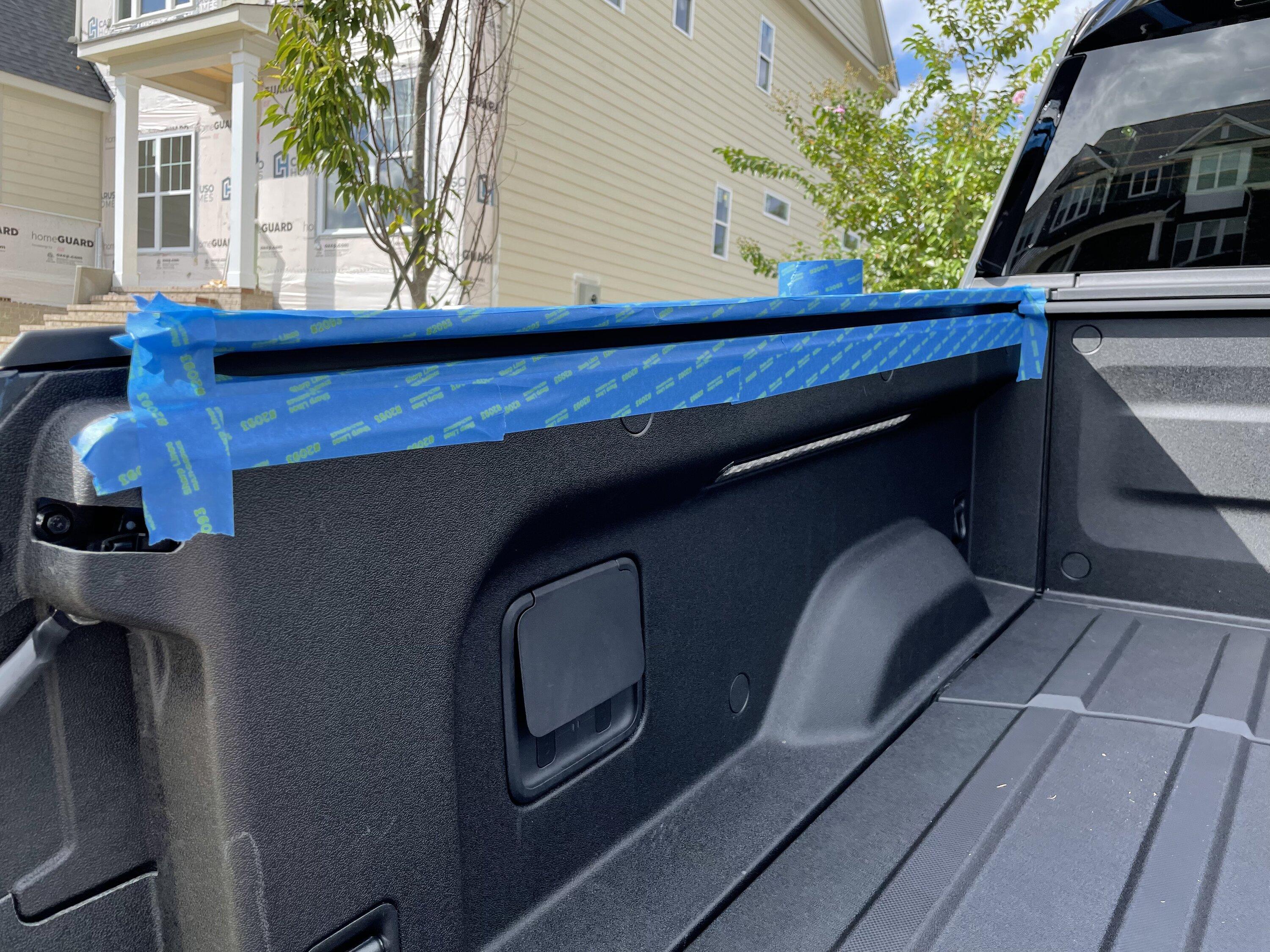

Always use protection with yer lube:
i asked about overspray of the CRC stuff. Glad I practiced a bit and masked off.
The golden rule is you always use protection when you are using lube. :angel:
Stay safe out there!
