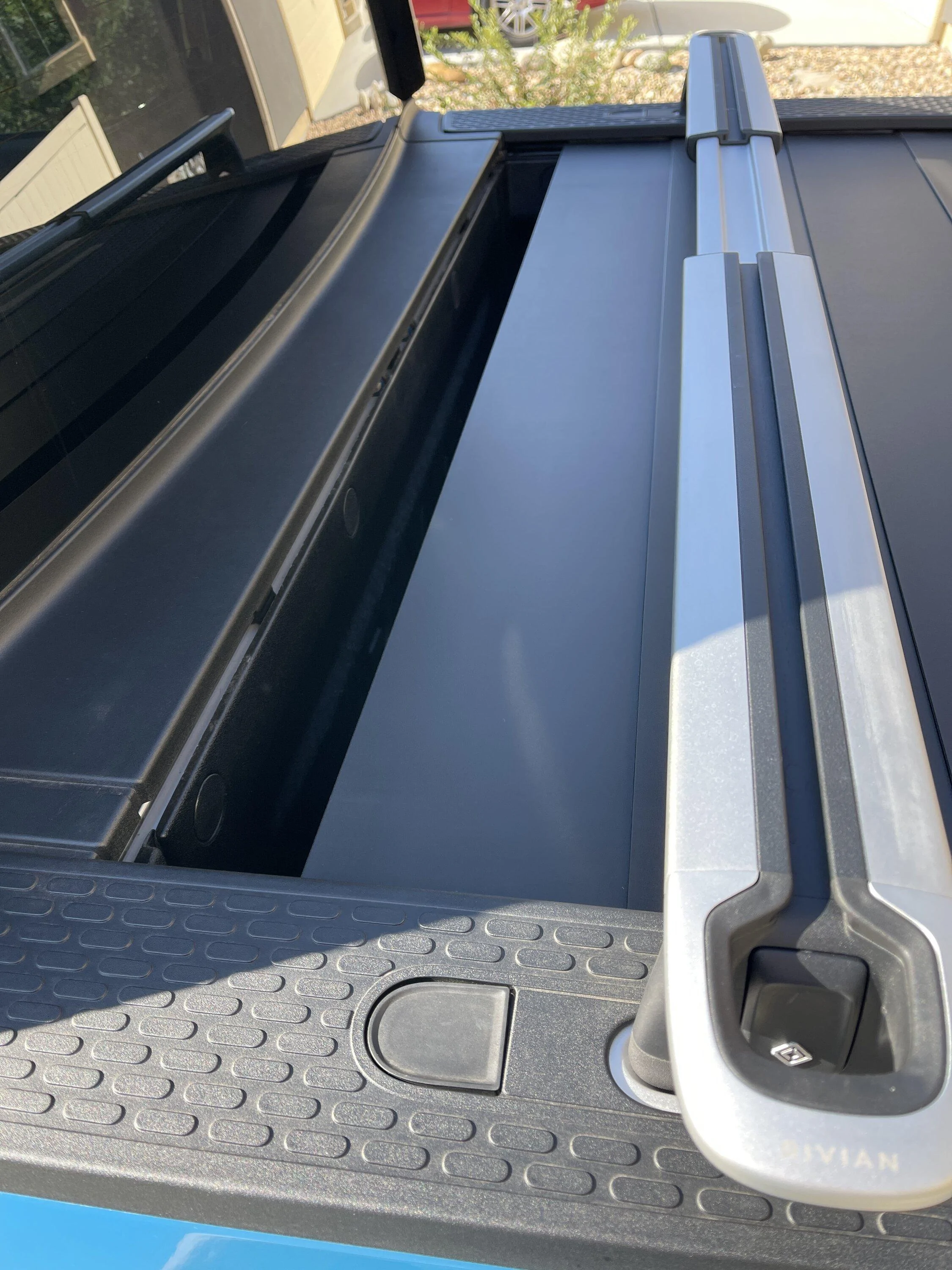

Appreciate this thread! I was having the issue where the tonneau cover would lock after opening about 6 inches. Managed to manually reset it and get some dry lube in the rails (Blaster Dry Lube w Teflon) and not only is it noticeably smoother, but it also retracts quite a bit faster!
As mentioned in another post, this particular brand leaves a white residue, so I might clean it up and redo it with dry lube that doesn’t dry white, but for now this solution is working great!
