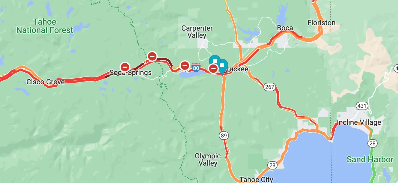

I think that's true for I-50 for example. Once there's trouble, there's no access, a cliff on one side, a rock face on the other. For I-80 from Sacramento to Truckee, it's two wide lanes and two wide hard shoulders for both directions with overpasses every few miles. A snowflake wafts over the summit and they close both directions for 50 miles. : )
Yesterday, clear blue skies, damp or dry asphalt, no snow on the ground and a single vehicle spin-out … looked like a horrible fatality crash, the first responders need safe working space (which they did not create, there were no vehicles positioned to protect the EMTs) and the CHP and Caltrans blocked the left lane for a few (10?) miles, left traffic to deal with itself (immediate chaos.) I encountered the same situation near Chicago, they put up a string of cones to snake the traffic across to the right to kept three lanes open using the right hard shoulder as a lane … a slowdown, but not a stop-n-go for an hour (!) ...
Fortunately, we charged at Auburn and had ample (pun) reserves, but mi/kWh dropped to 0.8 … if I'd been relying upon averaging 1.5 mi/kWh (mountainous area, high speed) and not stopped to charge, hoping to "squeak it in" on 5%, I would have had to stop somewhere and charge at 50kW (or less) to "top up" … anyway, practically impossible to make that 50 mile stretch without having a sensible charging strategy and that's in part due to knowing Caltrans cannot keep that freeway open.

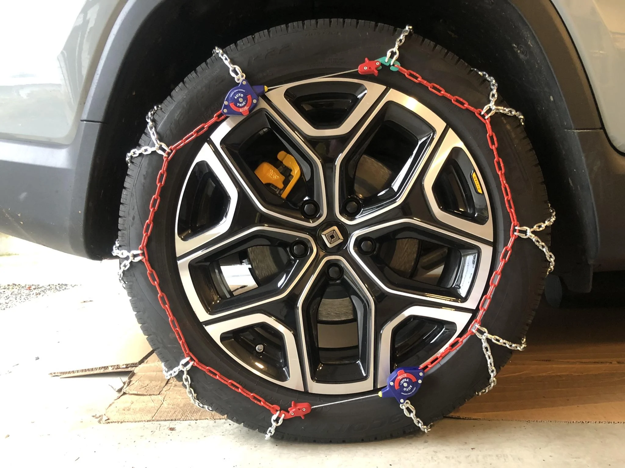

Tried super z8 today on my R1S. I admit I am not the strongest person but that thing took me like 10 minutes to install. I had to pull really hard to to connect both the front fasteners. then the tensioner also need quite a bit force as well but still that’s quick.
The Peerless AutoTrac are super easy to install. Took a minute or 2 to install each
and are self tightening

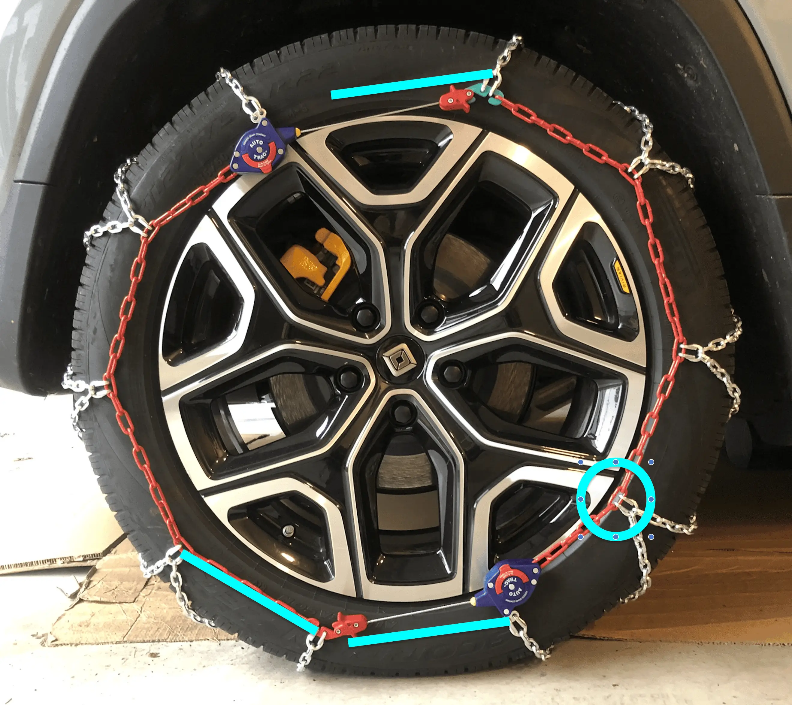

I think the largest fitment is 275/50R20, not 65, so you're lucky (ish) the larger 22" wheel diameter is wrapped in an overall smaller diameter tire, 275/50R22.
I think you can see the spacing of the links around the tensioners is wider than the other links. I've positioned some equal length blue lines to illustrate. The's also one link that's over the wheel, so there needs to be some initial slack for the chain to reposition itself before the tensioners snug up.
Rivian R1T R1S Snow socks for the 20s. Screenshot 2022-12-29 at 10.27.10 AM
I like the new dual-tensioner design, I have it for the Model X. Quick and painless compared to most diamond chains with the hoop (and conveniently smaller) but I think it needs a little more thought in how the tensioners function (and at least one larger, beefier size for heavy off-road vehicles with 275/65R20 or larger tires.) Great for a quick on-road problem solver, but could be a lot better for off-road and rough conditions.
p.s. I exchanged emails with support at peerless, they seem to realize the rubber tensioner is too small and too stiff, but don't seem to want to do anything about it. I kept asking them "just tell me a larger tensioner size" and they kept asking if I could send more detailed photos and part numbers … it's not a little too small, it's absurdly too small …

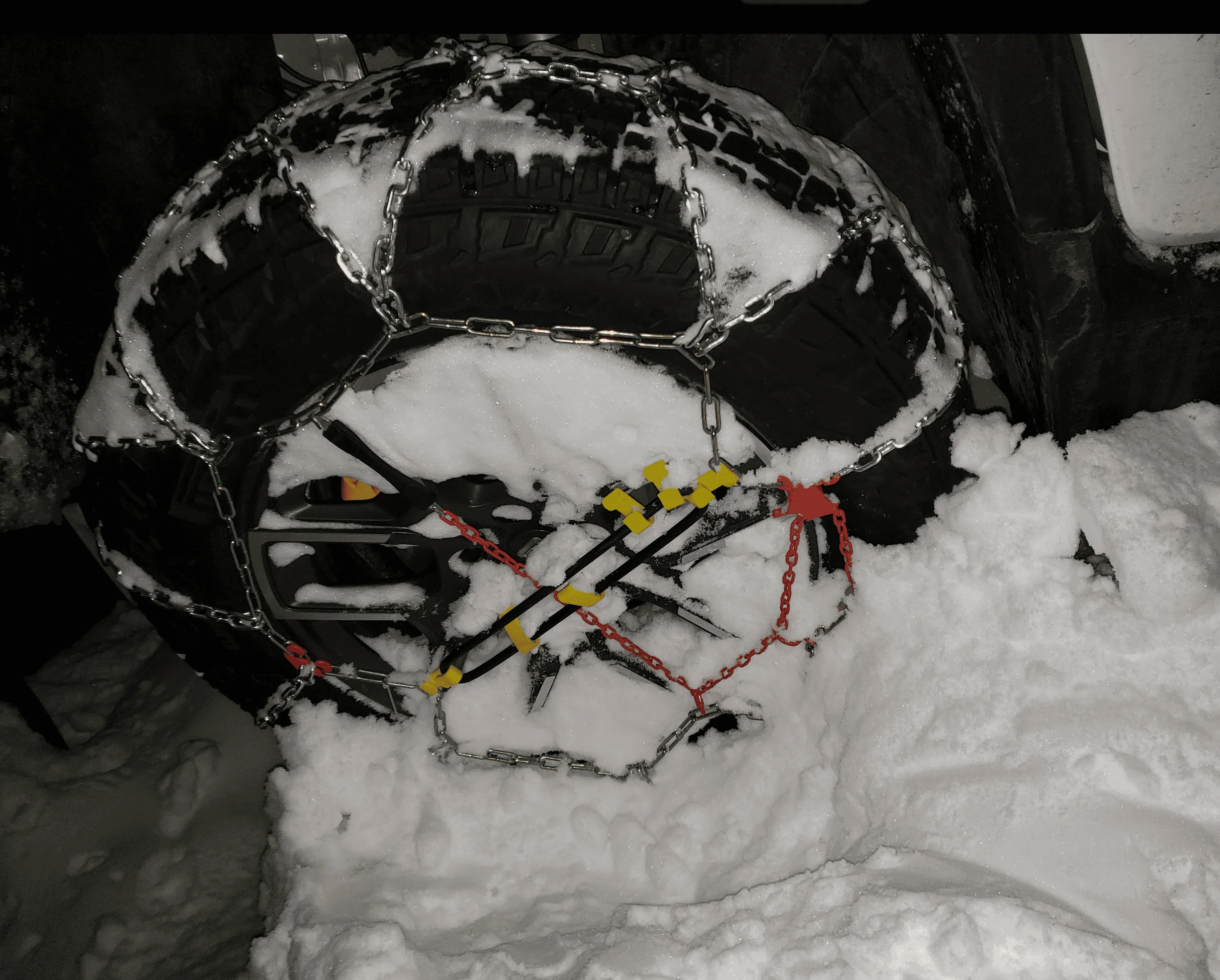

here's the older style chain-bungee tensioner … stuffed onto the rear of the R1T with 20's in snow … good enough to get me moving … not pretty …
Thanks for sharing! Does this works with high suspension height in all purpose mode? Or have to be highest in off-road?
plenty of clearance at all heights and with the steering turned to both locks (with the chains "tested" on the fronts)
Pretty sure I could have aligned them better but all I wanted to do was quickly make sure they fit. And, hopefully never have to use them.
