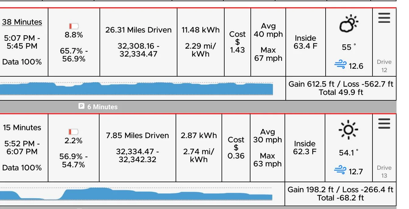

Here is a highway run with a 13 mile an hour cross wind, low setting, 47 psi in all purpose mode. Used driver+ 70mph on main stretches.

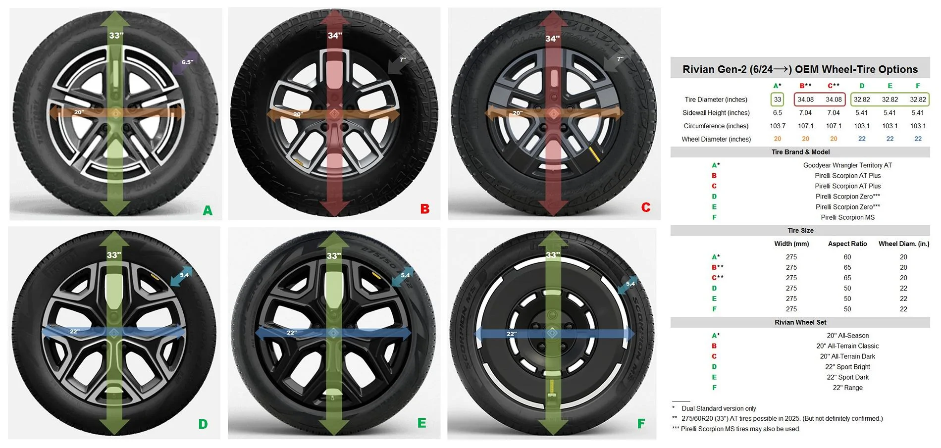

For this hypothetical experimental test design, I will ignore Rivian’s (Gen 1) 21-inch wheel and (Gen 2) 33-inch (275/60R20) tire. That leaves the following wheel-sets to be compared:
  • 20-inch (OEM) wheels with 34-inch (275/65R20) tires
  • 22-inch (OEM) wheels with 33-inch (275/50R22) tires
These wheel-sets (a) stay within the Rivian factory OEM playing-field, (b) represent current wheel/tire sizes for most unmodified Gen 2 vehicles and, I believe, (c) provide the largest difference in sidewall height (≈profile) between two stock Rivian OEM tires. (So they stand the greatest chance of revealing a range difference if my premise has any merit.)​
Rivian R1T R1S Range Against the Machine¹ - Rivian OEM Wheels, Tires, and Range Considered Rivian Gen 2 Wheels & Tires
Rivian Gen 2 Wheels & Tires (from OP #1).
(Note sidewall measurements.)​

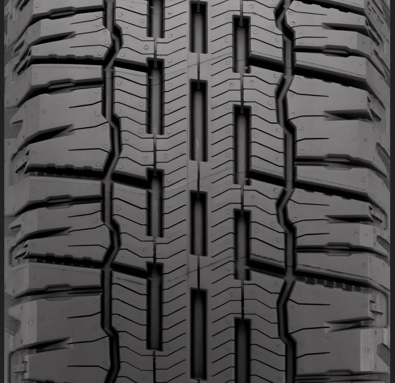

Rivian R1T R1S Range Against the Machine¹ - Rivian OEM Wheels, Tires, and Range Considered Michelin Defender LTX M-S2 - 22-inch
Michelin Defender
LTX M/S2 tread
(275/50R22)​

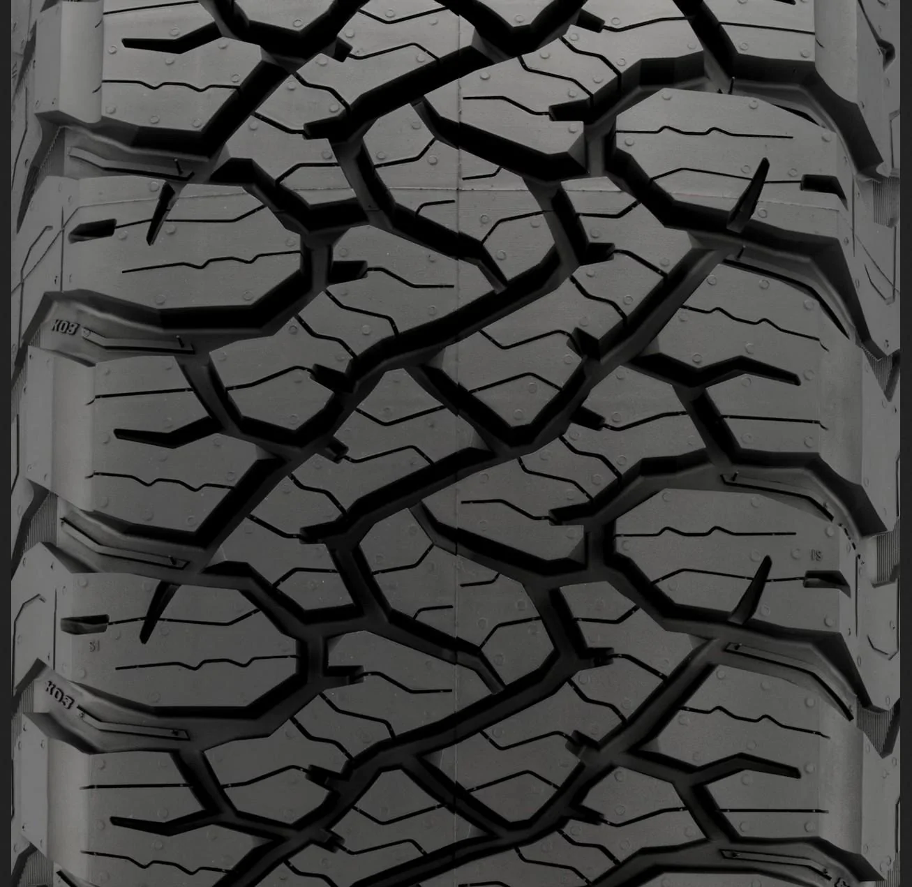

BF Goodrich All
Terrain T/A KO3 tread
(Note the more aggressive,
potentially range-robbing
tread design.)

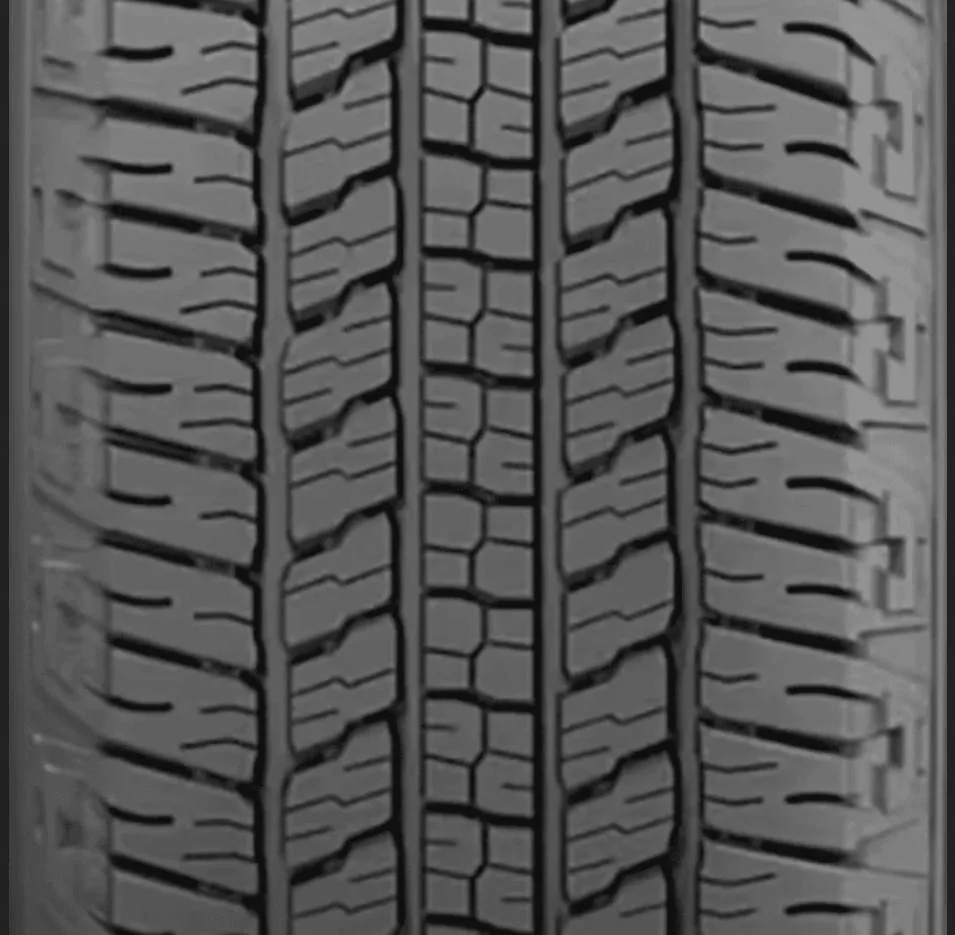

Rivian R1T R1S Range Against the Machine¹ - Rivian OEM Wheels, Tires, and Range Considered Continental TerrainContact H-T - 20-inch

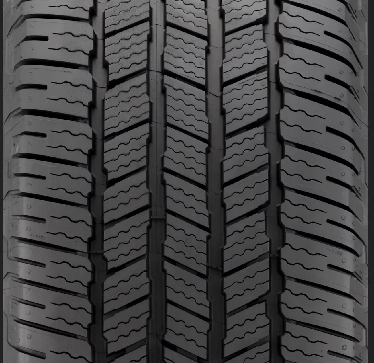

Continental Terrain
Contact H/T
(for 20" wheels)​
Rivian R1T R1S Range Against the Machine¹ - Rivian OEM Wheels, Tires, and Range Considered Goodyear Wrangler Workhorse HT - 20-inch

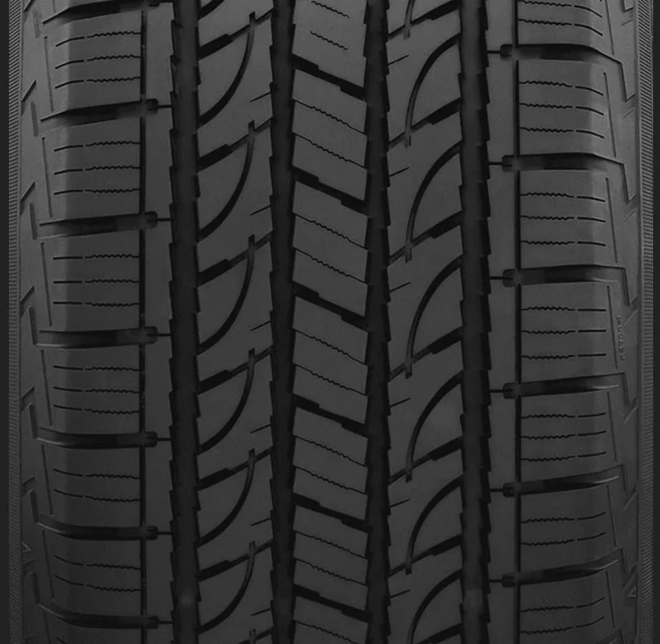

Goodyear Wrangler
Workhorse HT
(20")​

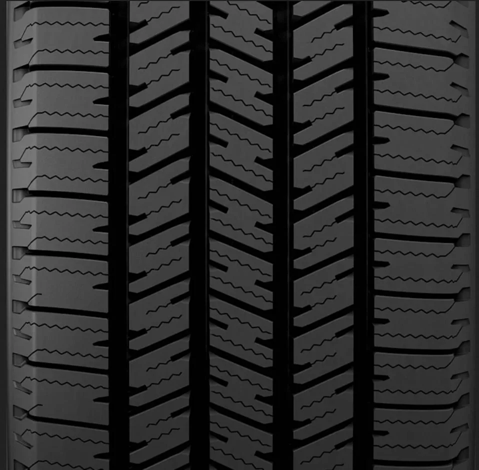

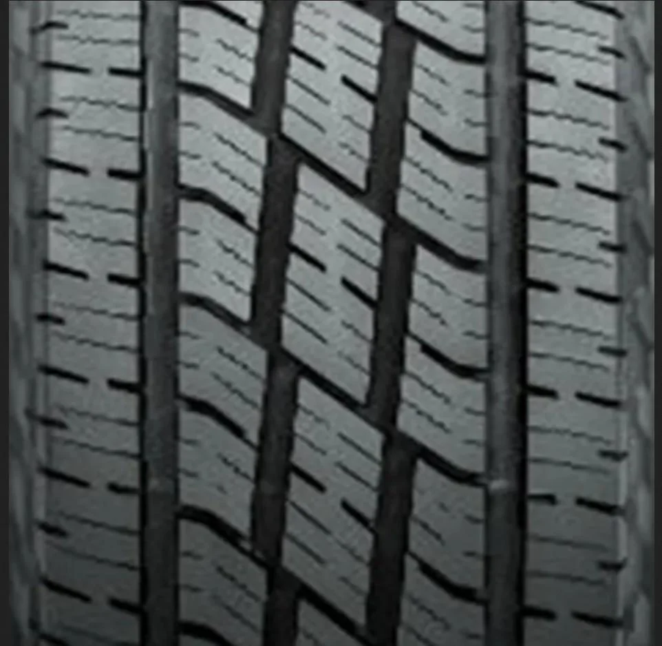

Toyo Open
Country H/T
(20")​

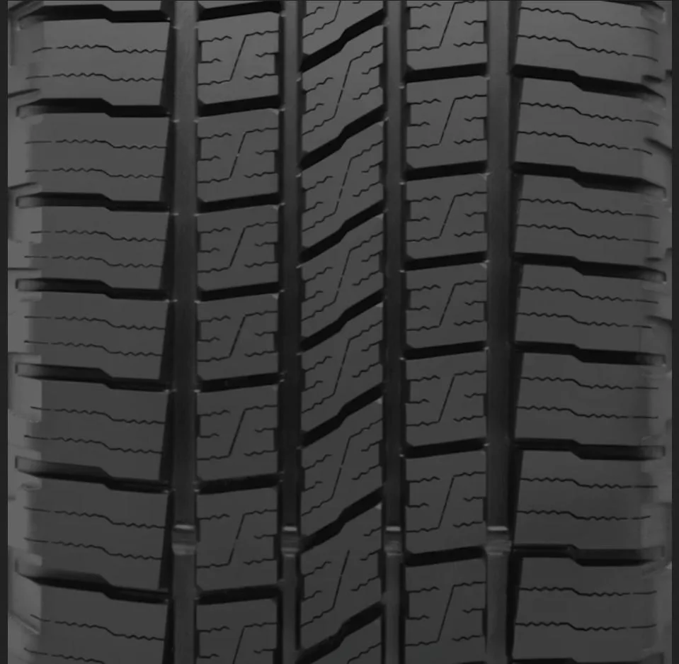

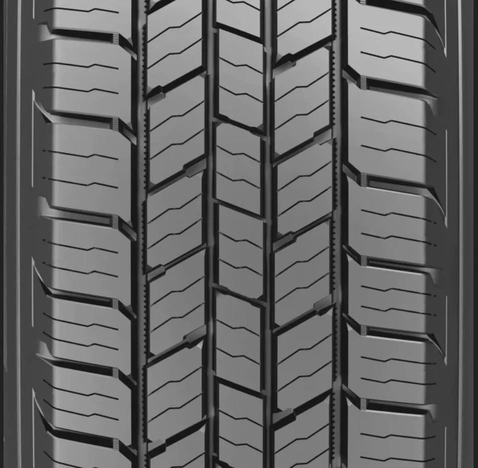

Yokojama Geolander H/T
(20")​

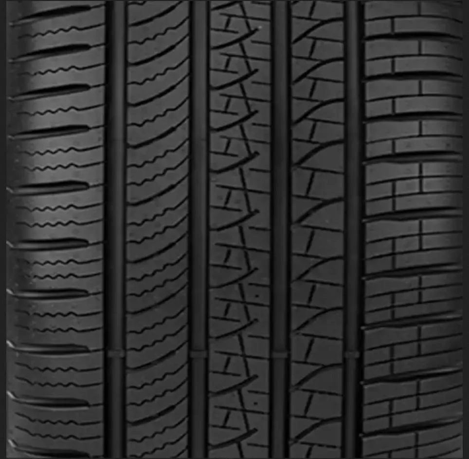

Rivian R1T R1S Range Against the Machine¹ - Rivian OEM Wheels, Tires, and Range Considered Pirelli Scorpion MS Elect - 22-inch

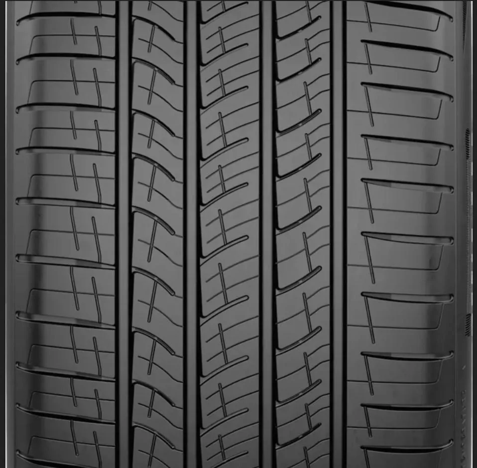

(22")​

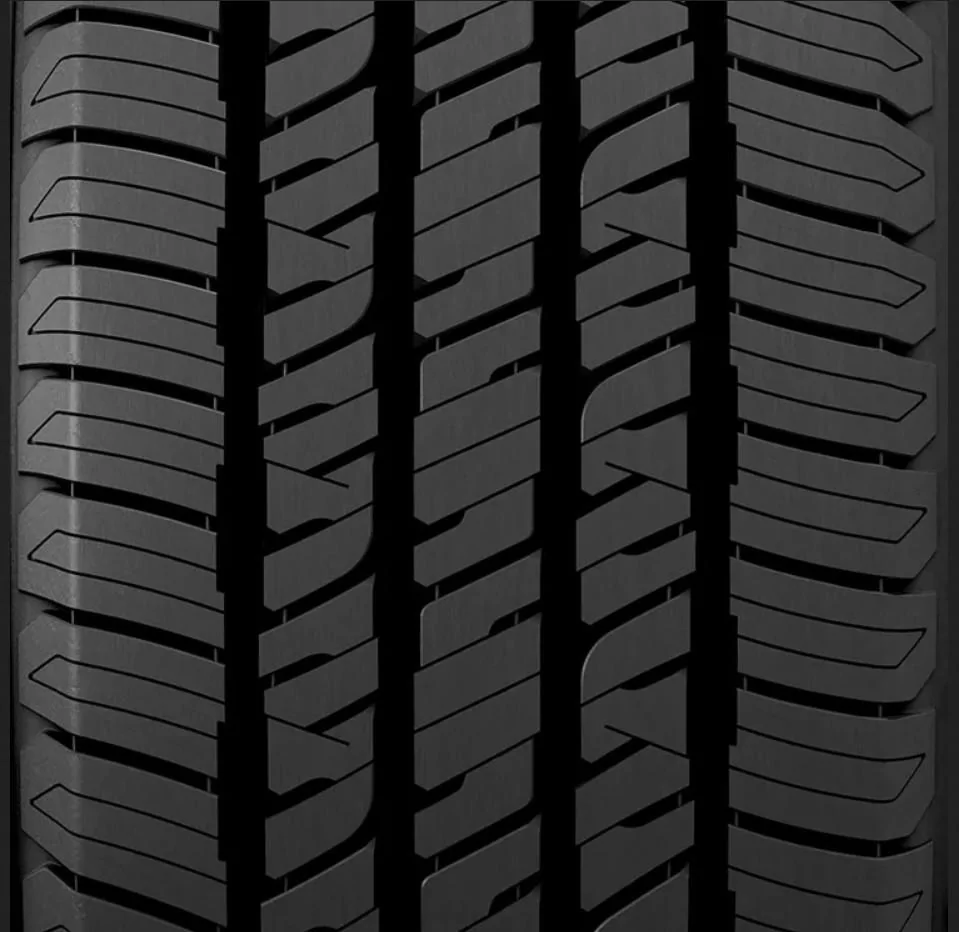

Bridgestone Dueler
H-T 685​
Michelin Defender
LTX Platinum tread
(275/65R20)​
BF Goodrich All
tread design.)
Continental Terrain
Contact H/T
(for 20" wheels)​
Goodyear Wrangler
Workhorse HT
(20")​
Toyo Open
Country H/T
(20")​
(20")​
(22")​

Rivian R1T R1S Range Against the Machine¹ - Rivian OEM Wheels, Tires, and Range Considered 1741911667629-is
Until then, it is a crap shoot and not worth the effort. IMO. Just get the 22" Range and be happy it is the best Rivian offers.

Hey, range chasers. Just wanted to highlight what I think looks like a pretty decently aerodynamic rim:
https://www.rivianforums.com/forum/...for-rivian-by-atomic-wheels.38346/post-747574

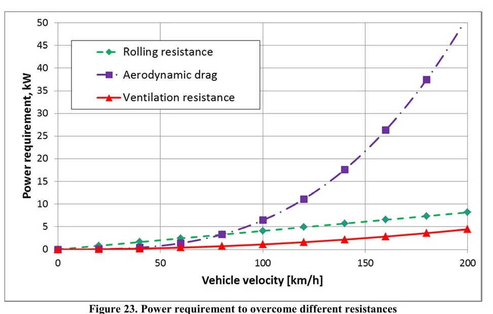

It would be better for the smooth part to be on the outside, where the rim is rotating the fastest, but still. The openings are small and look like they would not "grab" too much air. IMO they are much better than the stock 22" Darks/Brights, and with the large sidewalls on a 20" low rolling resistance tire, they should rock. In theory. The problem is finding a low rolling resistance 20" tire that can support the weight of a R1.
Keep in mind, the faster you go, the less this will matter as aerodynamic drag becomes the greatest consumer of energy by far. So for me, I haven't worried that much about tire efficiency. In Texas, I spend probably more time at higher speeds than you might in most states besides Florida and some Western states.
I agree with you, but....
Rolling resistance is very important. It impacts efficiency at all speeds. Certainly at 120 mph areodynamics are going have a massive impact, but at 80 mph so does rolling resistance. If you put a low rolling resistance tire on your vehicle, you will see an efficiency improvement at 80 mph. Definitely.
Rivian R1T R1S Range Against the Machine¹ - Rivian OEM Wheels, Tires, and Range Considered 1741996399715-c0
BTW - Ventilation resistance is the resistance from the wheel rotating.
