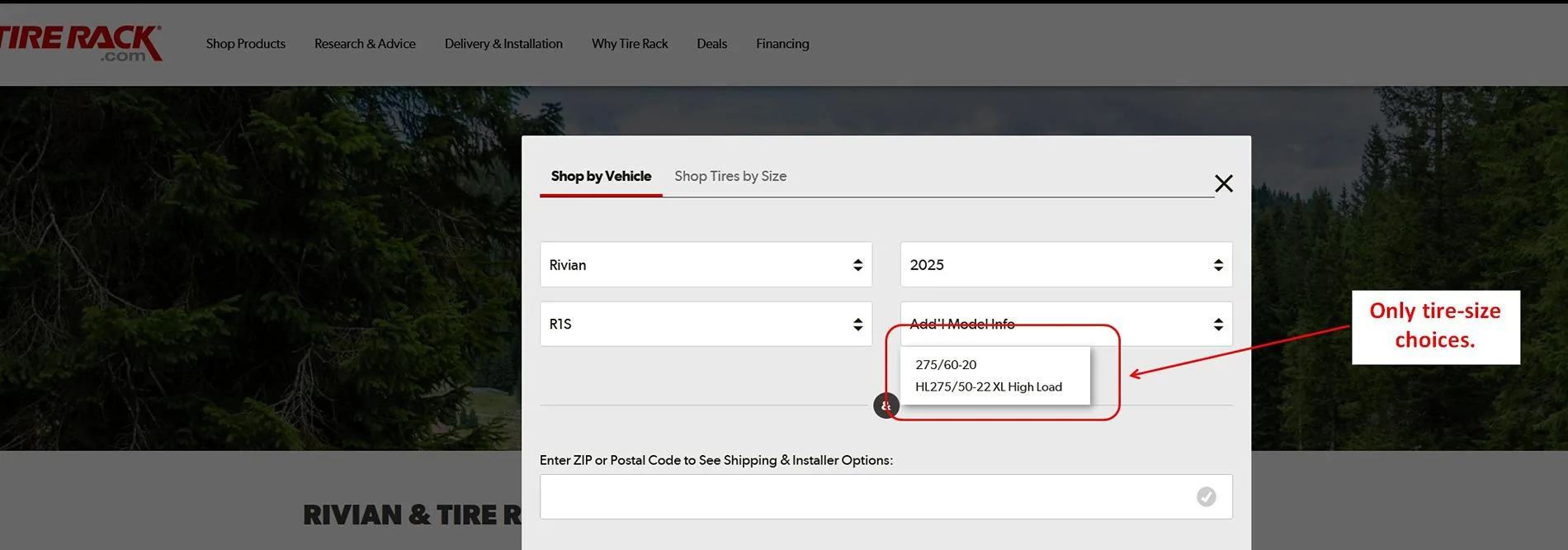

December 22, 2024 Update (concerning 20" AT tires):
On the Rivian "All Gear" Page
  • A Gen 1 and Gen 2 275/65R20 All-Terrain full-sized spare wheel-tire is still listed (for R1T), along with (Gen 1-only) 21" Road and (Gen 1-only?) 22" Sport wheel-tires.
  • New (to me) is Rivian & Tire Rack/America's Tire/Discount Tire partnership page and link.
    • Interestingly--on the Rivian-Tire Rack page for 2025 (Gen 2) vehicles--only 275/60R20 (33") OEM tires are listed as replacement for 20-inch wheels. (True for both R1T and R1S.)
      Rivian R1T R1S Range Against the Machine¹ - Rivian OEM Wheels, Tires, and Range Considered Tire Rack Size Choices
    • In Comparison, for 2022, 2023, & 2024 (Gen 1 [& 2024 Gen 2?]) vehicles, only 275/65R20 (34") OEM tires are listed for 20-inch wheels. (True for both R1T and R1S.)
Perplexing (to me). This could mean that:
  1. Rivian does indeed plan to switch exclusively to all-33-inch OEM AT tires in 2025,...or
  2. The Tire Rack page is in error.
Regardless, this might mean (pessimistically) that initial customers with 2025 model-year Dual Standard, Dual Max, and Tri Max vehicles (whether delivered in 2024 or 2025) who happen to want (the original Gen 1 and Gen 2) 34" replacement AT tires will have to politely 'discuss' (debate/argue?) the situation with Tire Rack/America's Tire/Discount Tire staff and be prepared to justify their reasoning. (Or maybe [optimistically] there will be no problem and/or this issue will quickly be cleared up at some or all stores across the Country?)
By the way; unless subject to new information, I'll continue to assume that nothing has physically changed that now disallows the use of 34-inch AT tires on 2025 Gen 2 Rivian vehicles? (If there is new information, please let us all know.)
Meanwhile, owners with vehicles purchased and delivered in 2024 (even those with so-called '2025' model-year vehicles) should (on paper) not have any 34-inch tire replacement push-back problems, since as far as I can tell Dual Large, Dual Max, and Tri Max Gen 2 '2025' models being issued with AT tires are currently receiving 34-inch tires from the factory.
For owners of Gen 1 or of 22-inch-wheeled vehicles, this may appear to be a "tempest in a teapot" (not worthy of discussion). But for several reasons it does matter whether you start with or are able to switch to 33- or 34-inch AT tires on 20-inch rims. Hopefully it will all get straightened out and Rivian owners will continue to have the freedom in 2025 to select whatever tire size (within reason) they want to at those Tire Rack/Discount Tire/America's Tire establishments (one of the largest tire sellers in North America).

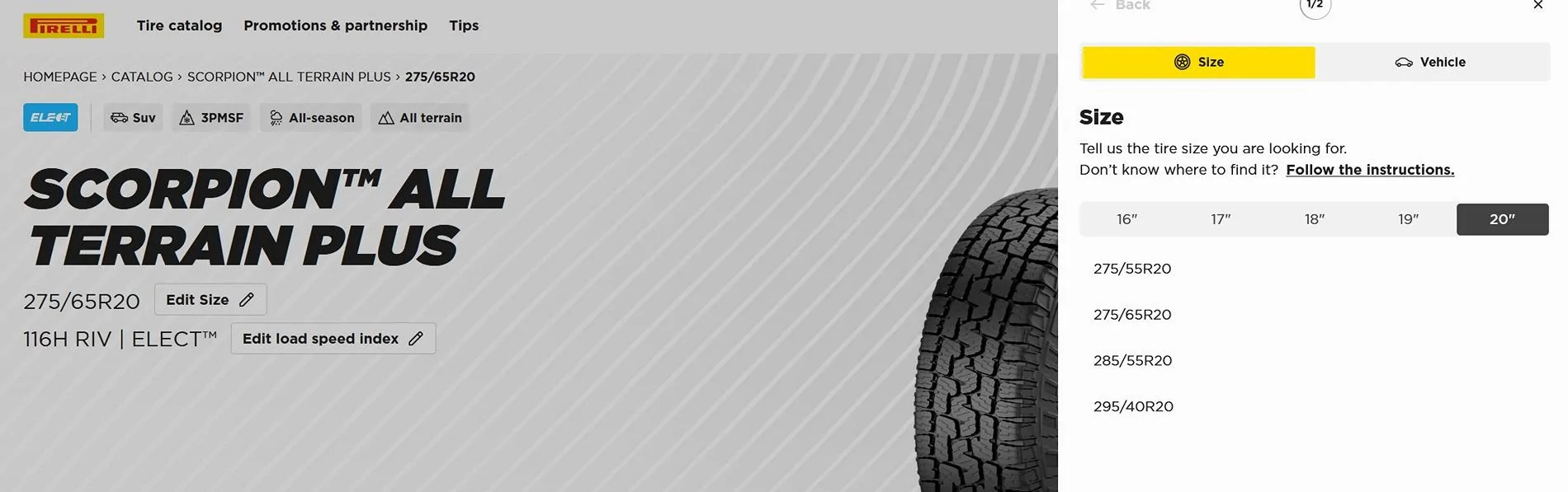

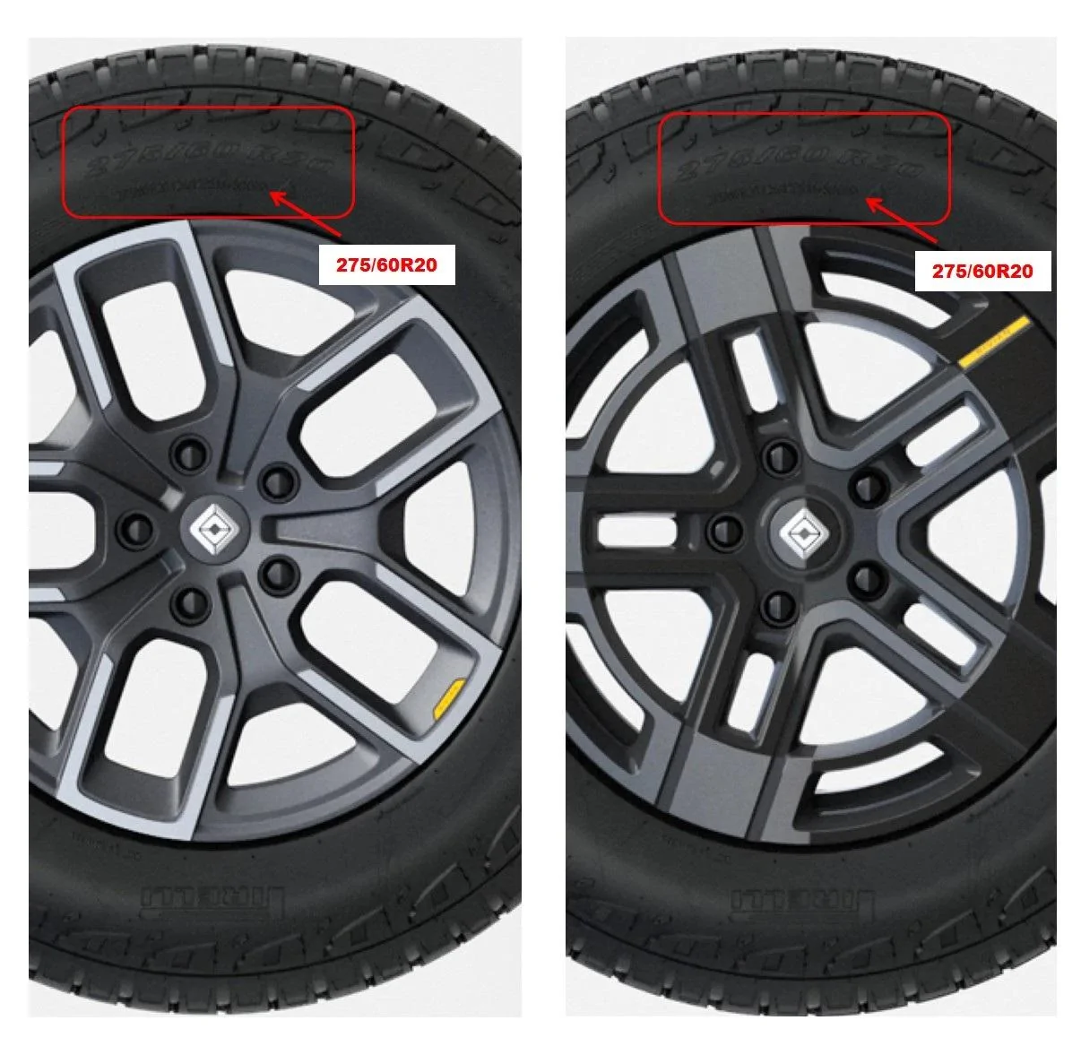

January 6, 2025 Update: Based on a (still) small sample size (maybe 25-30 responses by drivers on Reddit and Rivian Forums) is seems that Rivian is still outfitting Gen 2 All-Terrain Package cars with 275/65R20 (34") tires. (So far, no one has reported the 275/60R20 AT tire on a new 2025 Gen 2 Dual Large, Dual Max, or Tri Max car.*)
Whether Rivian will change to the smaller 33" AT tires later in 2025 is anybody's guess. (But why do some Rivian webpage photos, on close examination, show 275/60R20 33" AT Pirelli Scorpion AT tires?**)
Rivian R1T R1S Range Against the Machine¹ - Rivian OEM Wheels, Tires, and Range Considered Rivian Webpage Photos
Screenshots of photos from the Rivian Gear Shop webpage
showing details from 20" wheels with Pirelli Scorpion AT tires.
(AT Classic wheel-set on left; AT Dark wheel-set on right.) On
close examination the lettering clearly says 275/60R20 in
images used for "Full-Size Spare Tire" page (for R1T), and
for "20 in All-Terrain Wheel and Tire Set" page
(for Gen 1 & Gen 2 vehicles).
Rivian R1T R1S Range Against the Machine¹ - Rivian OEM Wheels, Tires, and Range Considered Pirelli Scorpion AT Plus
And, as near as I can tell, there is no Pirelli Scorpion AT tire in the
275/60R20 size available retail (at least in my area). Were the Rivian
photos "Photoshopped"? Were they based on a Pirelli prototype?
Rivian R1T R1S Range Against the Machine¹ - Rivian OEM Wheels, Tires, and Range Considered Full-Size Wheel-Tire Specs
Rivian R1T R1S Range Against the Machine¹ - Rivian OEM Wheels, Tires, and Range Considered AT Wheel-Set Specs

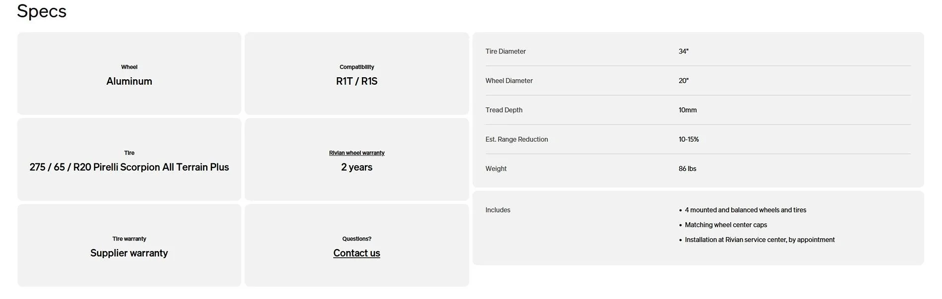

Finally, the wheel-tire specs on both the Rivian "Full Size Spare Tire" and
"20 in All-Terrain Wheel and Tire Set" pages list the 275/65R20 tire size. At
this point I am prone to believe the language, and to ignore the photos,
which are years old and may have been modified or based on prototype
tires. However, if a driver is shopping for replacement tires from Rivian, it
is probably good to inquire and be sure of what you'll be receiving.​

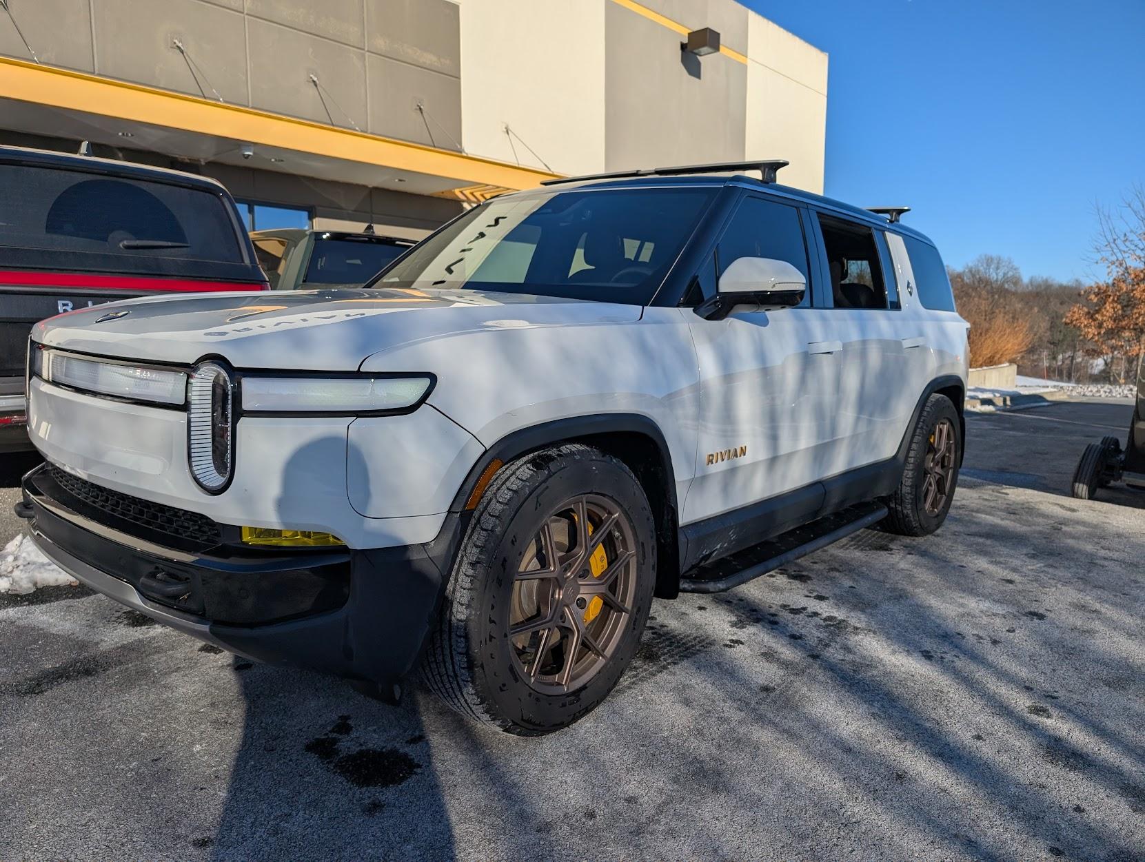

I got my Atomic Wheel setup with a 275/55/20 resulting in a 32" diameter 18lbs less rotational mass per corner w/ Goodyear Eagle Sport All-Season tires. Its been about 1k miles since I put them on in mid December and I an averaging about 2.09 in mega cold/very windy/snowy environments with mudflaps and roofbars. Ill eventually get a clean highway run in when the car is not caked in snow and salt but city performance has been outstanding (2.8/2.9/3+) m/kWh
Rivian R1T R1S Range Against the Machine¹ - Rivian OEM Wheels, Tires, and Range Considered 1736648854543-rk
City: (though I hear that guess o meter isn't the best).
Rivian R1T R1S Range Against the Machine¹ - Rivian OEM Wheels, Tires, and Range Considered 1736649123107-k5
My real question is
The car now takes more rotation to go more distance but is doing it more efficiency with less rotational mass in theory. Is the computer calculating everything accordingly or is it all false reporting because the math isn't mathing inside the car

Love the wheels. Did you adjust your efficiency numbers for the reduction in diameter?
kanundrum
May 2, 2020
243
4,330
12,739
Washington, DC
DayTripping
Timothy
Sep 12, 2024
1,398
1,840
DFW
Consultant
I understand you can't adjust it yet (and likely never if a non-stock tire size if they follow Tesla's lead). I was just asking if you made and adjustment for that in the efficiency numbers your presented to reflect the different tire size which would throw off the miles driven.

@McLeod
...275/55/20...32" diameter...tires..

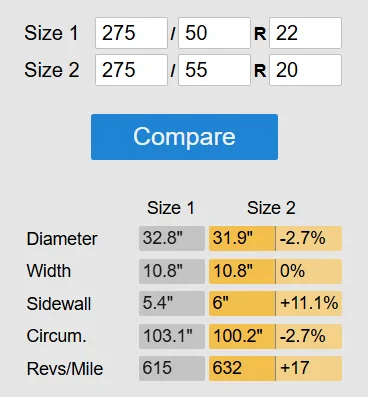

This is interesting. For the benefit of readers new to the whole (Rivian) wheel-tire thing, here are some bullet points (using this website for calculations):
  • @kanundrum's original wheel-set: Rivian OEM 22" Sport Bright (with 275/50R22 [33" Pirelli] tires).
    (Ignore any wheel/tire changes to this car in-between.)
  • kanundrum's latest wheel-set: aftermarket wheels & tires (with 275/55/20 [32" Goodyear] tires).
  • Resulting in...
    • 17.2 more revolutions required to travel one mile.
    • About an inch less in tire diameter, so a 2.9" smaller tire circumference (which affects the speedometer/odometer functions).|
    • If the speedometer reads 65 mph, the car would actually be traveling 63.2 mph.
  • I suspect that the odometer readings are affected, also. I am not exactly sure how modern EVs determine mileage readings, but my buddy Google tells me this:
    "If you install smaller tires on your car, your odometer will read a higher mileage than the actual distance traveled because smaller tires need to rotate more times to cover the same distance..."
  • If correct, it means that estimates of efficiency would be artificially over-estimated, correct? (By how much? Not sure.)
  • Is any of this a problem? I am not an expert, but I am thinking no; not with this set-up.
    Assuming no change in wheel offset, there should be no safety issues from rubbing (width is the same and diameter is less). And the diameter change is relatively small. So changes to speedometer, odometer, and efficiency estimates should be no problem. (Less likelihood of getting a speeding ticket, right?) Unfortunately, imo it is unlikely (for legal and financial reasons) that Rivian will eventually provide wheel/tire size-option software that includes the choice of aftermarket sizes. Too bad.
So I am all for experimentation (for both appearance and, more cautiously, for performance), as long as drivers are aware of:
  1. Safety concerns (e.g., by being sure to use tires that meet or exceed minimum load requirements).
  2. Size issues (e.g., by preventing possibility of tire/wheel-rim rubbing during cornering, bumps, or with suspension lowered,...and resulting catastrophic failure under stressful situations).
  3. Potential effects on computer functions (e.g., speedometer-odometer readings, camera positioning, etc.).​
BTW, the Atomic Wheels + Goodyear tires look good!

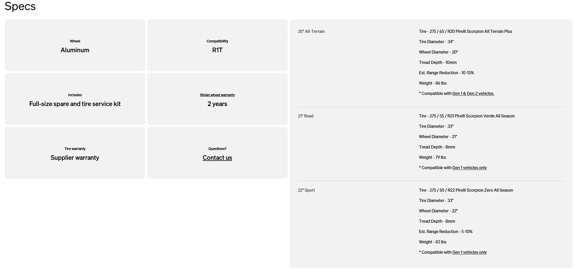

...Rivian Gear Page website provides some interesting wheel and tire data...
More on this as information becomes available.
Here is an updated table of spare tire and accessory wheel-set information from the Rivian Gear Shop page:
Rivian Gear Shop Page Wheel and Tire Information
Wheel
Size
(in.)
Tire
Type
Brand/
Model
Tire
Size
(in.)
Tread
Depth
(in.)
Total
Weight
(lb.)
Compatibility
20​
AT​
Pirelli
Scorpion
AT+​
34
(275/65R20)​
12/32​
82​
Gen 1
Gen 2​
20​
AS*
Goodyear
Wrangler
Territory
AT​
(275/60R20)​
11/32​
77​
Gen 1
Gen 2​
22​
Sport​
Pirelli
Scorpion
MS​
(275/50R22)​
10/32​
75​
Gen 1
Gen 2​
22​
Range​
Pirelli
Scorpion
MS​
(275/50R22)​
10/32​
76​
Gen 1
Gen 2​
_____
*|||The 20-inch wheel and 33-inch tire combo is apparently still only offered with the Dual
|||||Standard R1T and R1S models.
Note that the First Generation 21" wheel-set is no
longer
included on the current Gear Shop page.​
Abbreviations and Acronyms
  • AT = All-Terrain
  • AS = All-Season
  • MS = mud & snow compatible
  • Gen 1 = first generation R1 vehicles (2021-2024)
  • Gen 2 = second generation R1 vehicles (2024 - present)
  • Resulting in...

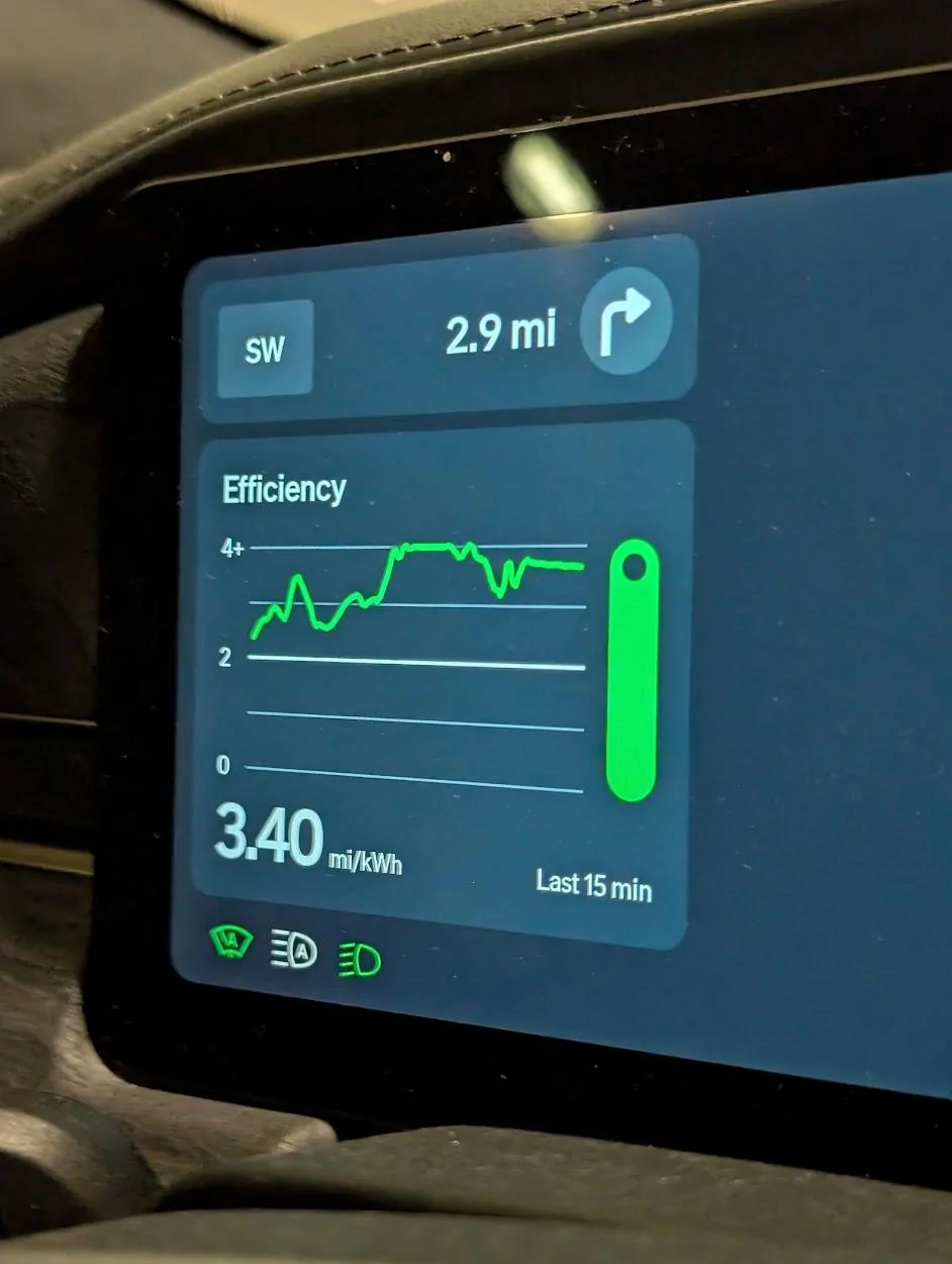

BTW - I would take kanundrum's efficiency numbers with the smaller wheels and reduce it by 2.7%. As you pointed out, the vehicle thinks it traveled more miles than it actually did, so the efficiency numbers are a little high.
Rivian R1T R1S Range Against the Machine¹ - Rivian OEM Wheels, Tires, and Range Considered 1740751916435-mo
So 3.4 mi/kWh * 0.973 = 3.31 mi/kWh.
@kanundrum - do you have highway efficiency numbers you can share now?
kanundrum
May 2, 2020
243
4,330
12,739
Washington, DC
Good thread.
I haven't had much luck in traveling long distances with daycare and snow storms but here is some data from this morning
