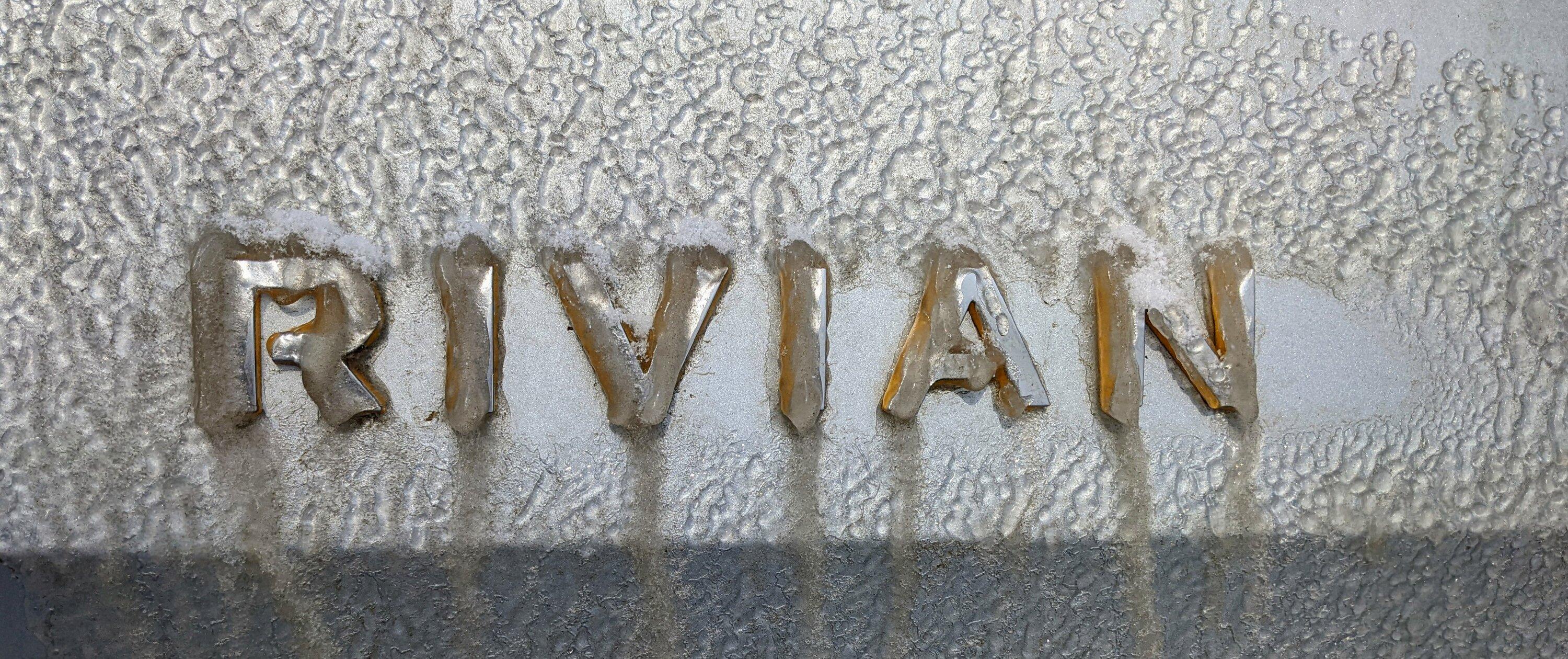

Guess I should debadge in the winter to get a little range back. Mostly just posting as I enjoyed the look. (Light snow, no headlight issues)
From the look of this, I should have debadged mine when the weather was still warm. Too late to do it now.
