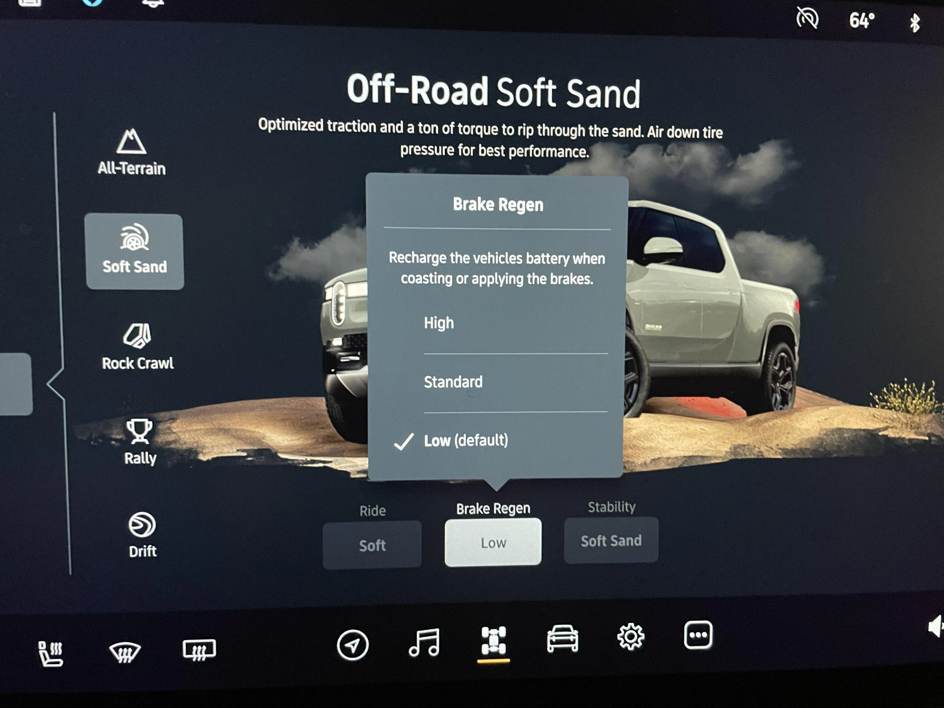

Sand mode has greatly reduced regen. It's harder to find the "sweet spot" where the vehicle will just coast the motors under low traction conditions. The Rivian is easier than the polestar though, since the R1T has quite a bit of motor noise and the Polestar has basically none.

Sand mode is the only config as of now that offers “Low” Regen as default or option, the rest only offer Standard or High Regen.
