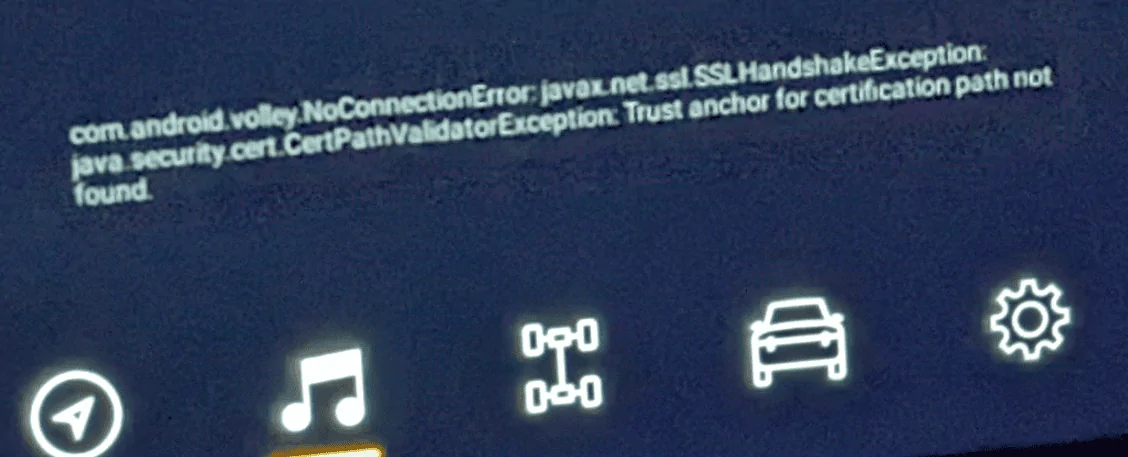

I got my truck last Thursday and started messing around with it to see what I can dig up. I setup MITM proxy to try to capture some network traffic. Of course they're not totally stupid and everything I've seen in my limited time trying has been https and enforcing valid certs so stuff in the truck is broken on my MITM wifi.
The only thing that's getting through looks like some sort of logging for the nav system. It looks like it keeps trying to upload a log of status data but it's failing (and not because of the MITM). The first event is at the local service center so I'm guessing it's after they initialized/wiped the truck of it's factory data. There's a bunch of them and it seems to keep growing. The events are all starts, stops, and one where I set my home location.

If there was still any doubt that it's Android, I got this when I tried to hit tunein while the traffic was being intercepted...

Interesting. I thought it was confirmed to be QNX.
