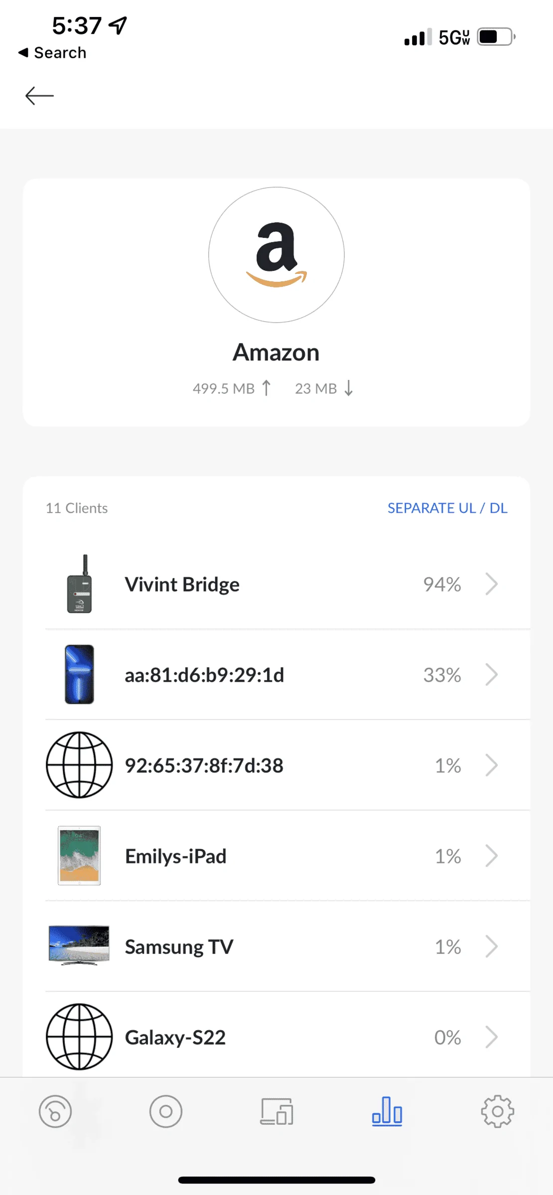

So i did some digging around on my network today. It seems the Rivian software is android based and hopefully this could lead to bigger things. Ignore the phone picture, it's just what Ubiquiti assigns to Android.
Rivian R1T R1S Rivian OS is possibly Android Based 1647904593024
Also i looked at the packets it's sending and here's what it sent after a few days:
Rivian R1T R1S Rivian OS is possibly Android Based 1647904650842
Amazon could be the gear guard video, the diagnostic logs, or other random information. This data was sent BEFORE i turned Alexa on.
I'm going to keep digging through my pihole and see if anything else interesting comes up.

UniFi fingerprints go crazy sometimes though and misidentify. But, I hope you submitted a picture of your truck for their library - will be good for when I get mine if they have it in there already!

Ya, almost certainly android or some other linux / unix OS. Not sure why it really matters though...
Done and Done :)
It means they could easily integrate android auto or some form of screen mirroring if they wanted to.
Also opens the system up to a lot more native android apps.
Do we think Amazon is simply AWS? Or would AWS appear differently than just "Amazon"?
I'll know more later when i get home from work and check my pi-hole, but my guess is AWS for the gear guard and/or the diagnostic logs i had to send.
