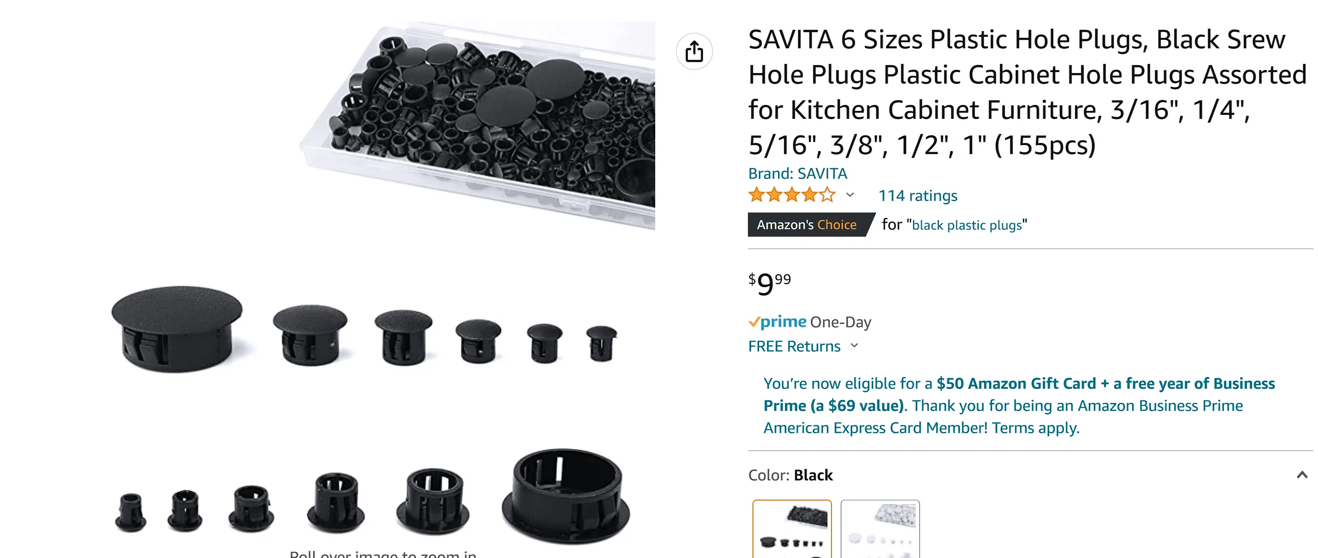

Are they pretty much centered holes? Might be easier to plug with some black carriage bolts.

Personally I'd probably just push a couple push-in retainers in there and call it a day. But this is specifically why I told my SC to not drill the holes prior to pickup. I'll use a Snap-Plate or anything else. Don't want holes drilled in my brand new vehicle, LOL. ?

Probably not hard to replace but good luck sourcing a replacement part. I would just plug it as others have suggested.
