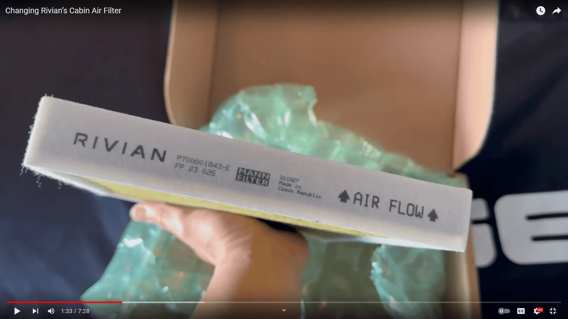

Does anyone know how to obtain replacement cabin filters for our R1s? All this smoke has me wanting to replace my original. I would even like a HEPA filter like I used in my last pickup. I even know how to replace it. Our new Gear Shop in Seattle was unable to locate replacement cabin filters or suggest how to obtain them...Id say they are consumables, just like wiper blades....

Others have had to order it from their (hopefully local) Service Center.. then drive there and pick it up. Same with fuses and wiper blades...
I got this from a YT video, you might reach out to Mann Filters and see if they have that part available or a suitable equivalent filter.

Mann filters lists Carquest and Advance auto as their local distributors in the US

The Mann part number is: FP 23 025
Seems like an OEM only part, maybe just remove yours and measure it then find a common one with close dimensions?

One guy on that YT video said in the comments the OEM filter is:
210 mm X 227 mm X 30 mm
or 8.27" X 8.94" X 1.18"
and someone posted below that about a possible easy to find $20 Fram air filter that is close in size:
FRAM CF12820
211 mm X 224 mm X 28.5mm
or 8.29" X 8.83" X 1.12"
OP- if you pull your OEM filter please measure it for us!

Mann Filter FP 23 025 is the Rivian branded filter. The same filter for other vehicles is FP 23 024. This filter fits several Kias and Hyundais. Filter is 210mm x 227mm x 30mm
