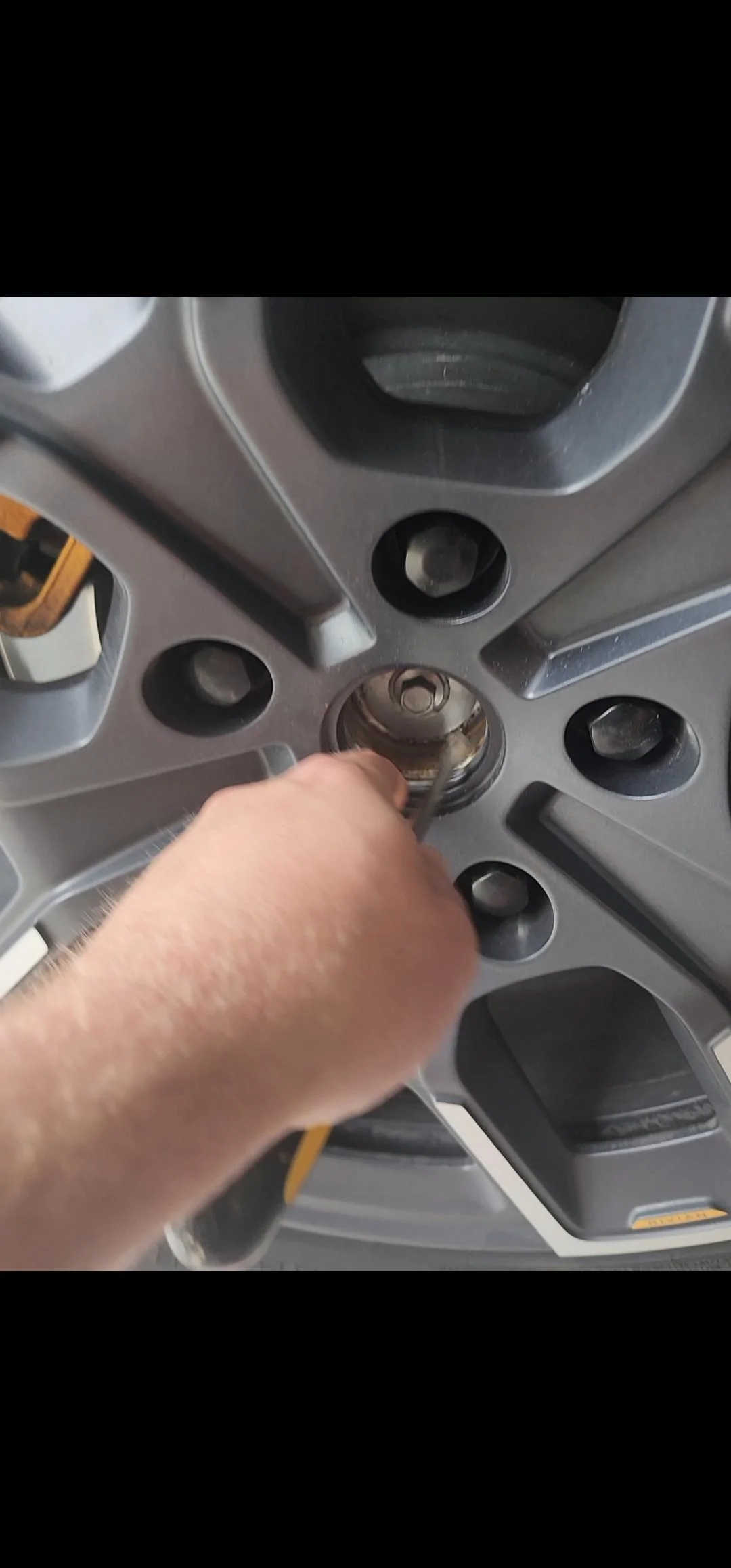

Same. Under vehicle.. mid-pointish. I was originally thinking there was a metal spring clamp (maybe a boot clamp or something) rolling around on an axle shaft... i've been under there a few times looking around and shaking stuff but haven't seen anything.
I guess I need to remove some panels.
I found my noise! Took center cap off bolt / washer wasn't tight.

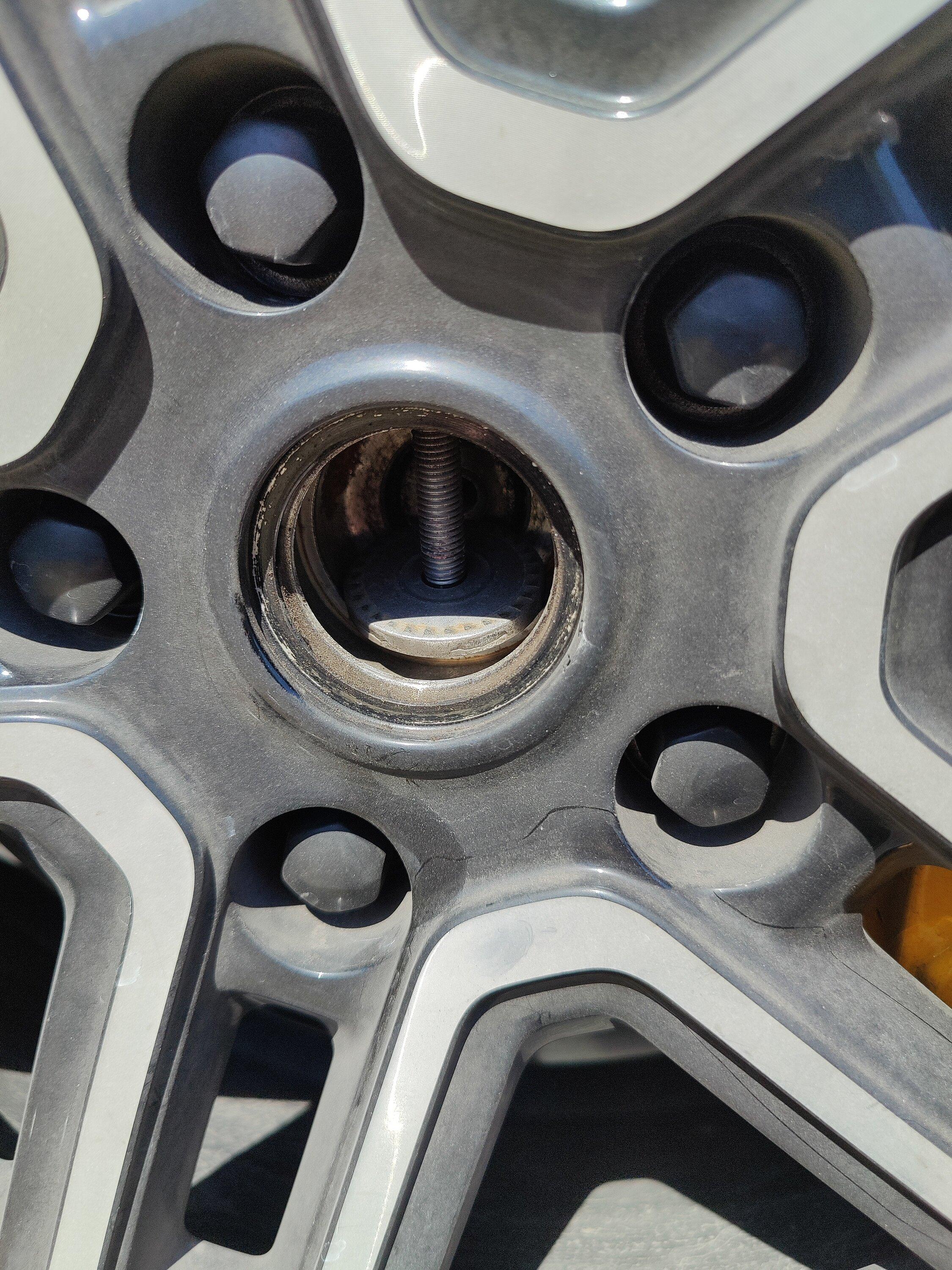

AHHHHHH HAHAHAAHAHAHA. Mine wasn't either ? Vin 8xx. Too many launches maybe. I bet these hold the axel shafts to the wheel hubs. Anyone know the torque specs?
So, clanging at slow speed ==pull your wheel hub caps and check these bolts.
Rivian R1T R1S General NVH / Squeaks / Noises / Rattles Solutions IMG_20230627_153510
Edit: Bolt back in place. I just did "Good n Tight" for now. A little concerning these bolts are backing out. Maybe the documented axel play is making them loosen?

I believe that bolt backing out was an indication of half-shaft problems. I would definitely open a ticket for that so that Rivian is aware (there may also be an existing fix that you need). Based on previous reports from others, this seems to progress until the bolt backs completely out and pops out center cap (thus both are lost).
