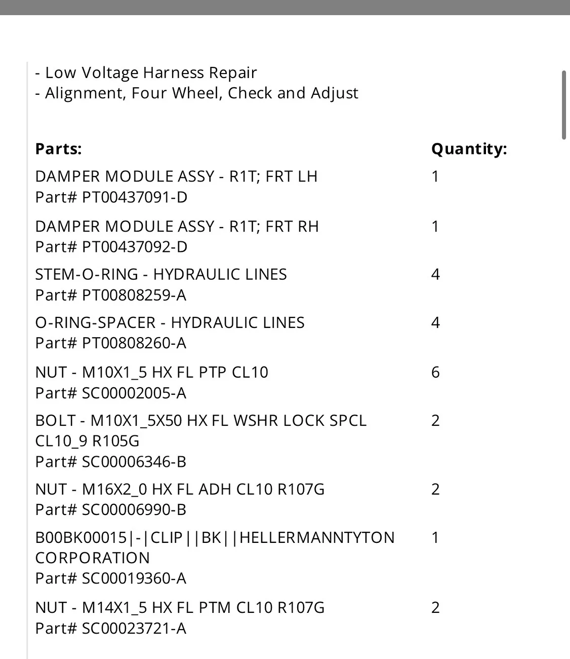

For what it’s worth my 2022 R1T had a very similar clunking noise any time I encountered a slight bump in the road. It was most noticeable at low speeds and when it was cold. Took it to 2 different service centers and for test drives with the techs. They inspected everything and said it was a normal gen 1 suspension noise coming from the dampers. About a month ago I took it in for the rear toe link recall and while in service the hydraulic pump failed. They replaced all 4 dampers, pump and valve with the gen 2 suspension retrofit. I would say it solved 99% of the clunking noise.
I have wondered several times if it's an "fluid hammer" sort of condition from the hydraulic lines not being bled well, then "chattering" when the load reverses within the line. Similar to what you get in a house that has long runs from the water heater to the faucet and you shut it off abruptly.
Your experience would somewhat confirm that.

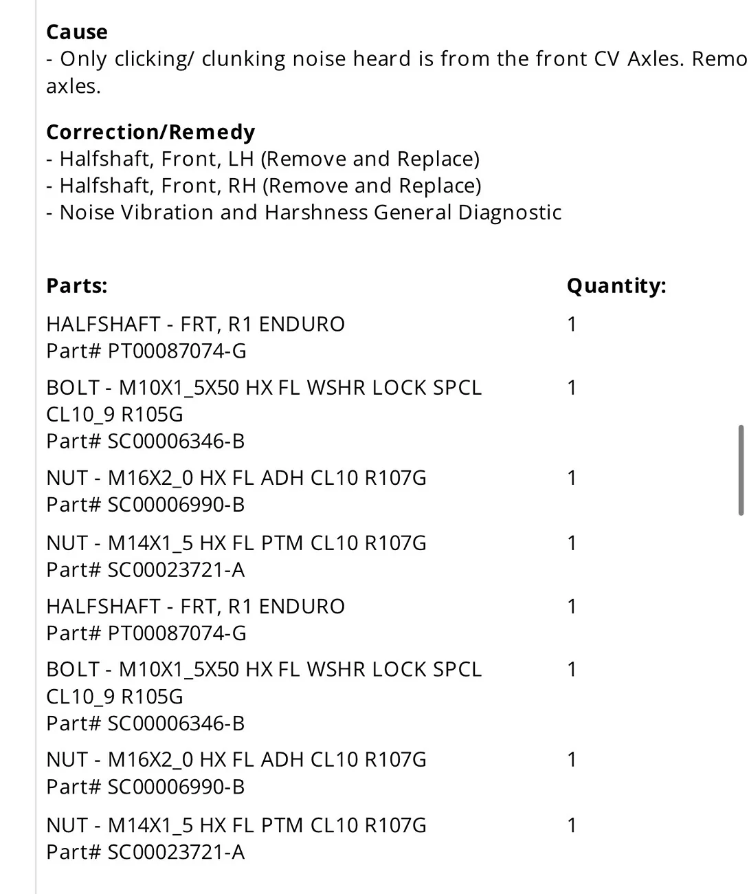

Picking mine up Saturday - hood realignment and the noise in front right suspension. Over the phone the tech said it was a “loose nut” that was causing one of the pressurized lines to be rubbing against something over bumps. I will let you know if it is indeed fixed…
