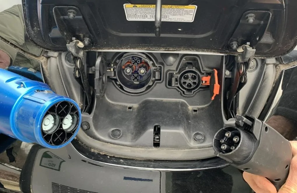

That said, anyone here lamenting about how incredibly ugly, and huge, CCS is ... just remember CHAdeMo, and realize that it could be far, far worse, and make yourself feel better.

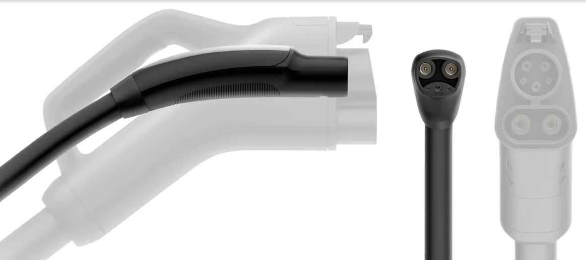

I'd be OK with an adapter AND I would pay extra myself to have both ports.
Visuals.

Forgive me for this rather basic question, but what makes the CCS connector(and presumably the receptacle) inferior, and the NACS superior? Aren't both simply hunks of plastic with copper studs that transfer current and/or data from charger to vehicle?
I can understand if, for example the NACS connector has a greater capacity for current transfer, and handles data better, but nothing I read seems to indicate that's the case. And of course, it's easy to understand that Tesla's proprietary charging network (accessed via NACS connectors), with it's better hardware & software, along with [generally] higher transfer capability is superior to the EA and other charging networks that use CCS connectors.
A related issue I can't get my head around is why it is that a simple adapter isn't sufficient to be able to use either connector / receptacle combination. Of course, I may be missing something basic - I'm new to the EV world and whenever my R1S is delivered, it will be my first EV - but it would seem that the Tesla charging network superiority isn't due to their use of the NACS connector.
1) NACS has no specified maximum current rating. Current is limited only by temperature. I'm less familiar with the CCS standard, but typically stations are limited to 500 amps.
2) NACS is rated to 1,000V, same as CCS.
3) NACS is compatible with ISO-15118 plug and charge.
4) NACS is substantially smaller than CCS.
If you really want to nerd out, read this.
Regarding your question on adapters. Sure, they work, but who wants to have to remember to keep it with them all the time or plug it in every time. It's also another potential point of failure.
This is 100% true. It's the vertical integration and focus on maintenance and uptime that makes it superior. However, NACS certainly doesn't hurt from a usability standpoint, especially for older folks and those with disabilities. Some CCS handles and cable combos can be legitimately difficult to handle.

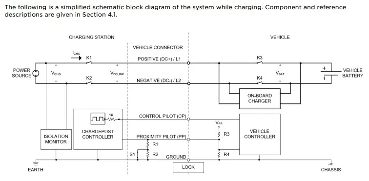

Everyone is overlooking the issue that NACS uses the same pins for AC and DC, big safety disadvantage. Because of this the vehicle needs to provide isolation internally between the signals, and thus requires additional safety software. From a safety standpoint NACS is inferior, IMO.
Imagine connecting AC voltage to the DC battery pack (definite hazard), or connecting the DC input to the on-board charger (may or may not be a hazard). The CCS standard solves this potential failure point, without adding additional hardware inside the vehicle.
I think Tesla is not currently selling a NACS to CCS adapter, because what would happen if someone connects the adpater to a destination charger and puts AC voltage on the CCS DC pins. Will the car be smart enough not to turn on the DC charging contactors? I am sure Tesla has this all figured out in their software, because it has been their proprietary design, but I doubt any other manufacturer has considered this.
It's really not an issue as the car port current carrying pins go to an isolated contact arm of a DPDT contactor/relay and the handshake and comms with the EVSE determines which way the contact arm in the contactor swings. If it sees a malformed waveform or bad/garbled comms message at the handshake (when you plug the charge handle in to the vehicle port) it doesn't move the contactor to either the DC or AC side. It's pretty much impossible for the onboard equipment to connect a DC supply to the vehicle AC circuit and vice-versa.

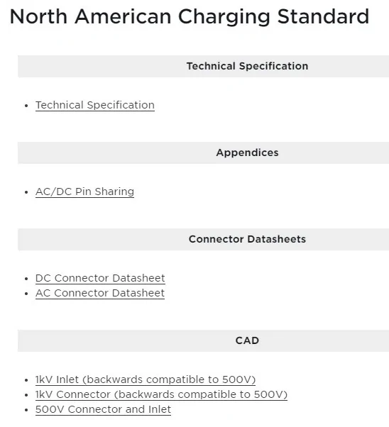

https://www.tesla.com/support/charging-product-guides#NACS-resources
Rivian R1T R1S Ford/Tesla Deal: Access to Superchargers, adapter coming, future EVs will have NACS (Tesla) port yyAdxnv
From the "Technical Spec" doc above.
Rivian R1T R1S Ford/Tesla Deal: Access to Superchargers, adapter coming, future EVs will have NACS (Tesla) port KCXXjmB
Yes, I agree not an issue with existing Tesla vehicles. But existing CCS vehicles have different setups than Tesla and did not have to consider this issue.
And for example, the Mach E has a very well known fault that results in a welded contactor in the battery path.
